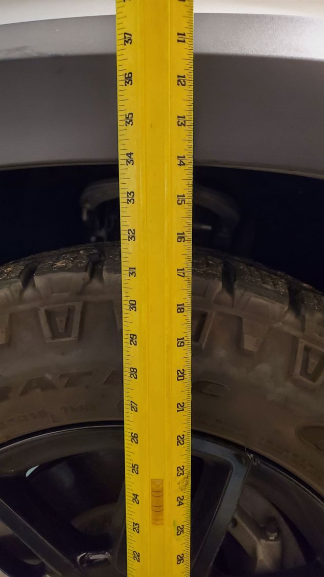

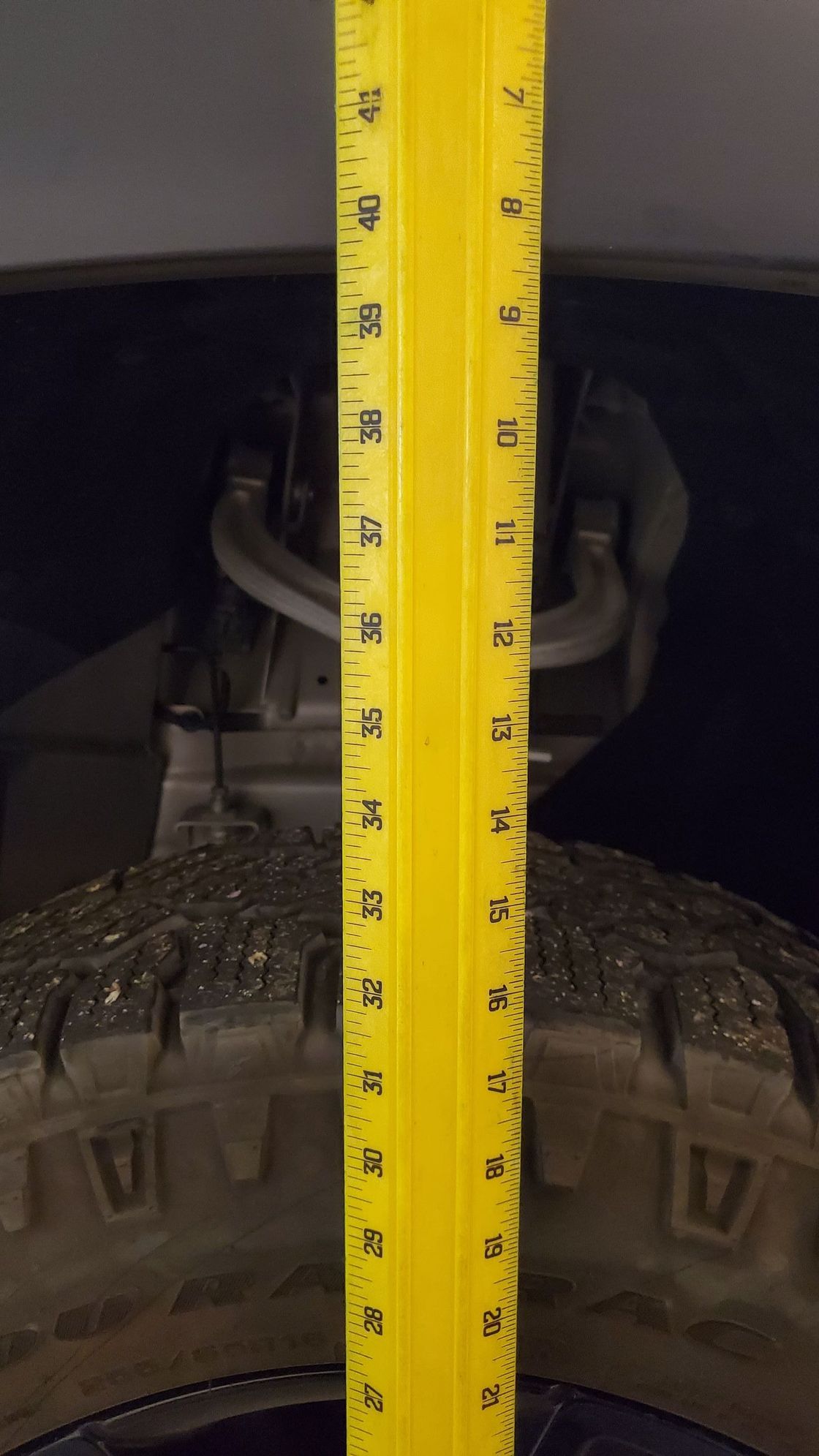

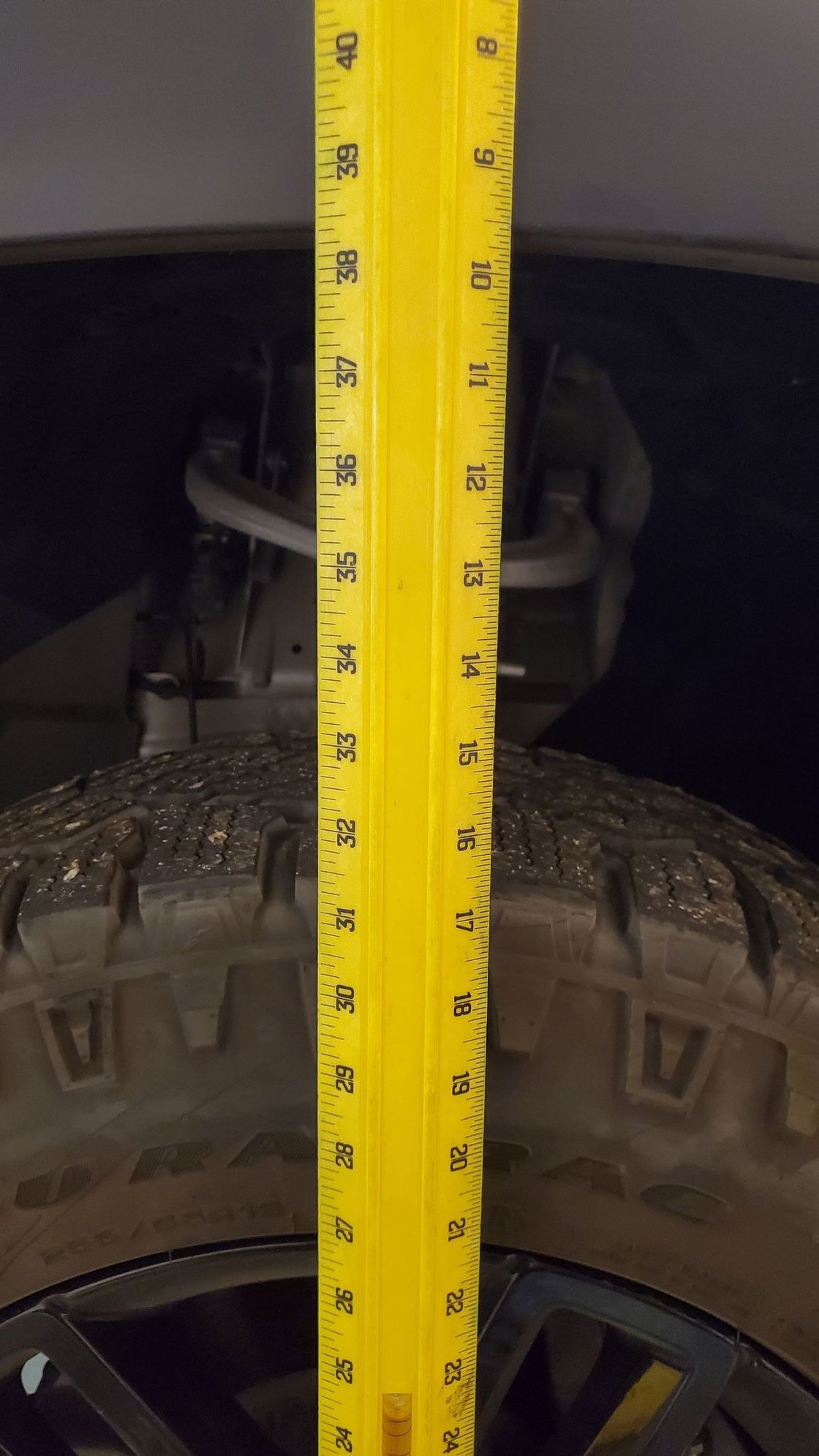

Let me preface this by saying that my LLAMS controller is set to lower the car by 20 mm, not 35. You could change that setting by reprogramming the controller, but it's either/or.
These are photos of inches from the floor to the front left wheel arch. My tires are 255/65R19 GY Duratracs inflated at 34 PSI (front.) The car rolled backward slightly as the suspensions were rising and forward slightly when they were lowering, but not enough to make more than a tiny difference.
Starting with Normal Height, LLAMS off:
Access Height, LLAMS off:
Access Height, LLAMS -20 mm:

@umbertob wow, thanks so much for that! looks like the -20 setting gives closer to -25, bodes well for the -35 setting. Been going back and forth a bit with Graeme, you're not wrong about how awesome he is! Asked him a question around the extra low mode that was mentioned as not supported and he's implementing a change to have it trigger the -35 on the newer cars that don't support the -50 it usually triggers. Looking forward to getting this installed! Thanks again for sharing this awesome product.
