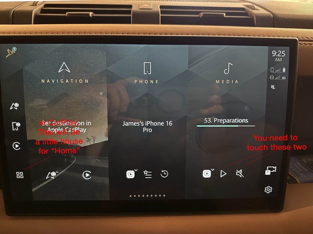

Mine does it fairly frequently. It seems to be positional related to interference from alarm systems, railway signaling gear and traffic reporting systems. They all use the same frequency band that wifi and bluetooth use. The fix, which was mysteriously hard to find, turned out to be simple for me. While the system will not be immune to outside influences, I find I can quickly bring my audio back. First off touch the house symbol on the lower left while in CarPlay. It goes to the Pivi Home Screen. on the right you will see what used to be playing in your entertainment system. The speaker will have a line through it and it will be paused. Touch the speaker and un-pause it. You would think, that after 5 years they may have fixed this, or at least made the process simpler. Unfortunately they pay virtually no attention to the electrical defects in the vehicle and instead concentrate on Puddle Lights and Colored Calipers.

I found I didn't have to re-select the source when I found that this situation was displayed on the home page. It would be cool if it was predictable. In my case, Chase Bank and the Post Office are the worst for making my system go wonky. I think the Post Office's little handheld communication system is partially to blame, low bidder and all.
