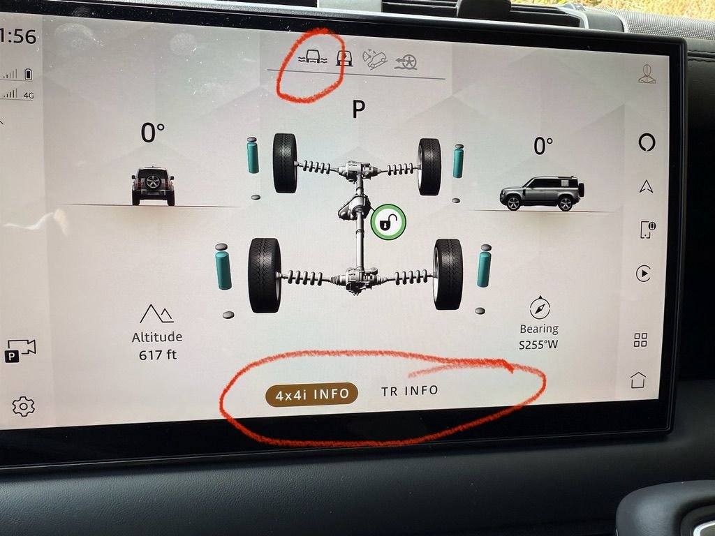

Hi folks ! First time posting pho
I've just bought a brand new 110 25 plate with air suspension.
I select the wading program, it ackwoledges on the dash and the suspension rises to the top BUT wade sensning is no where to be found. It's not in the apps screen nor an option on the 4X4 info screen.
I've spoken to the dealer and they have no idea .. no help whatsover for them.
I've ready that fixed side steps disable it but the dealer is insistent that they sold tons with steps and the wade sensing works.
I've tried restting the Pivi Pro but still nothing.
Any ideas please ?
Cheers
Dave

For 2025 wade sensing is part of the off road package which adds the rear locking differential - which isn't showing on your screen either. Do you have the off road pack?
