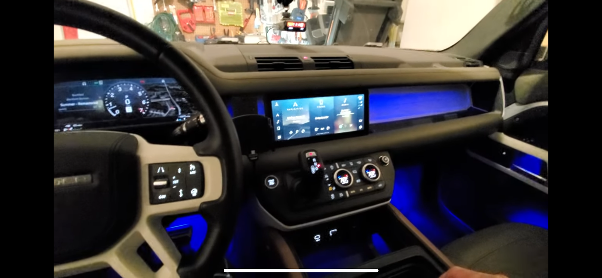

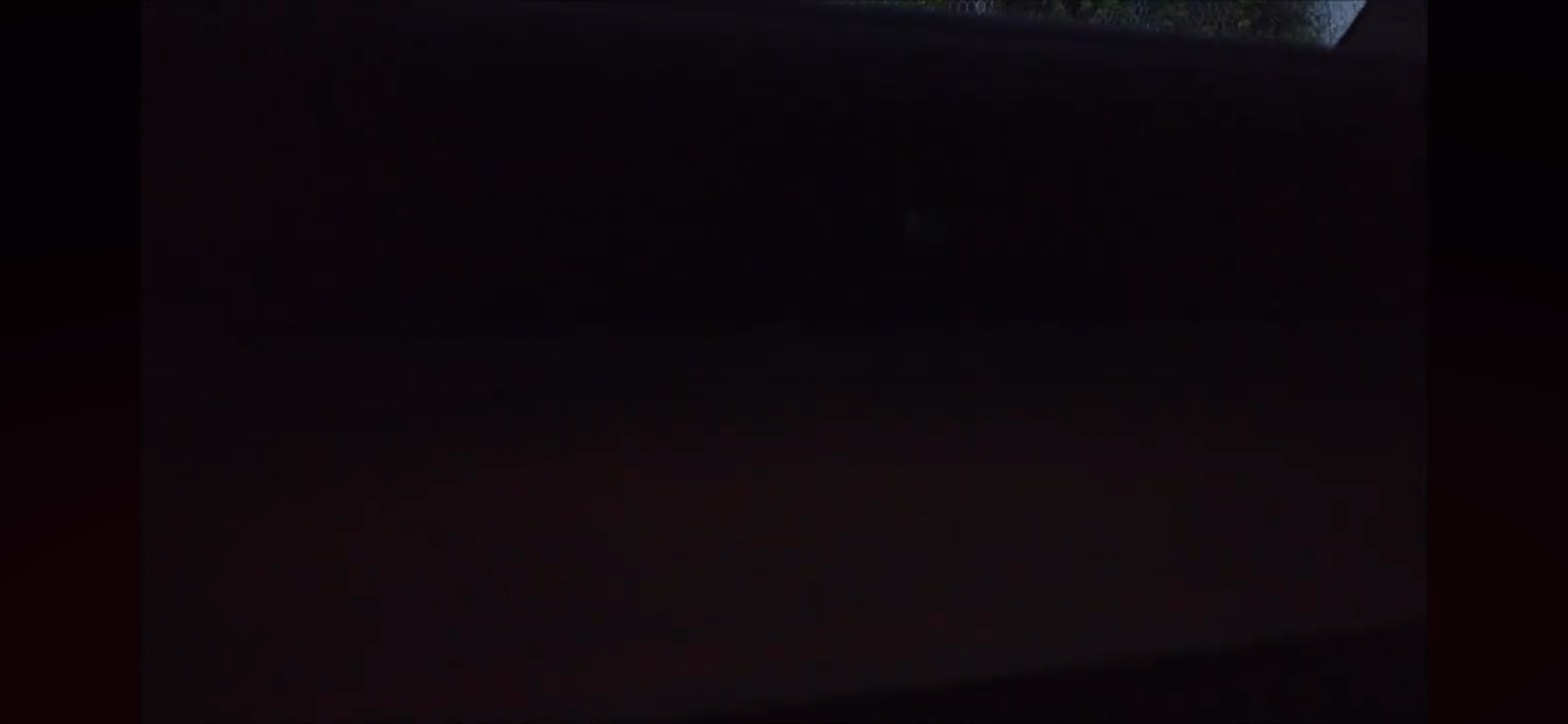

For the ambient light, I see most people have the ability to to set their lights pretty bright, just like the one member here (where I stole a screenshot from his video)
but unfortunately mine is so dim on the highest setting you can’t even tell if it’s on or not (if you can see that faint red hue)
I don’t know if it’s just me or there’s an issue.

For what it's worth, my ambient lights look like the top photo you posted. They are bright and obvious. At the risk of stating the obvious, you do see the inner "pie chart" selector inside the outside wheel where you choose the ambient light color? There are four selectable levels of brightness, and at the lowest level they aren't very bright at all.

yea, I have the brightest one selected and it’s still very dim
