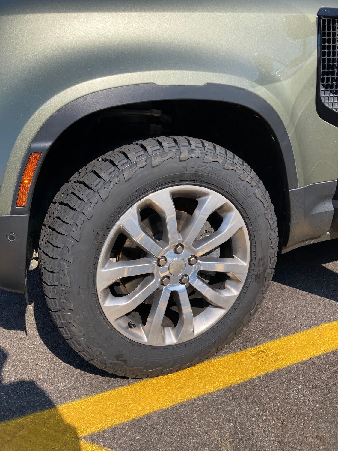

Default Canada's first 255 65 R19 KO3

Joined: Jun 2026
Posts: 5
Originally Posted by Ratledge
I probably should look back a bit more, but is anyone riding on these 19" K03's?
These have been "next month" for years, I am on 255/60 Falken Wuldoeak and love them.
Yes check what I posted
sorry, for some reason I saw the 265/60 20 L93 and missed it. Awesome!
I ordered a pair, Just put new on mid-April.
