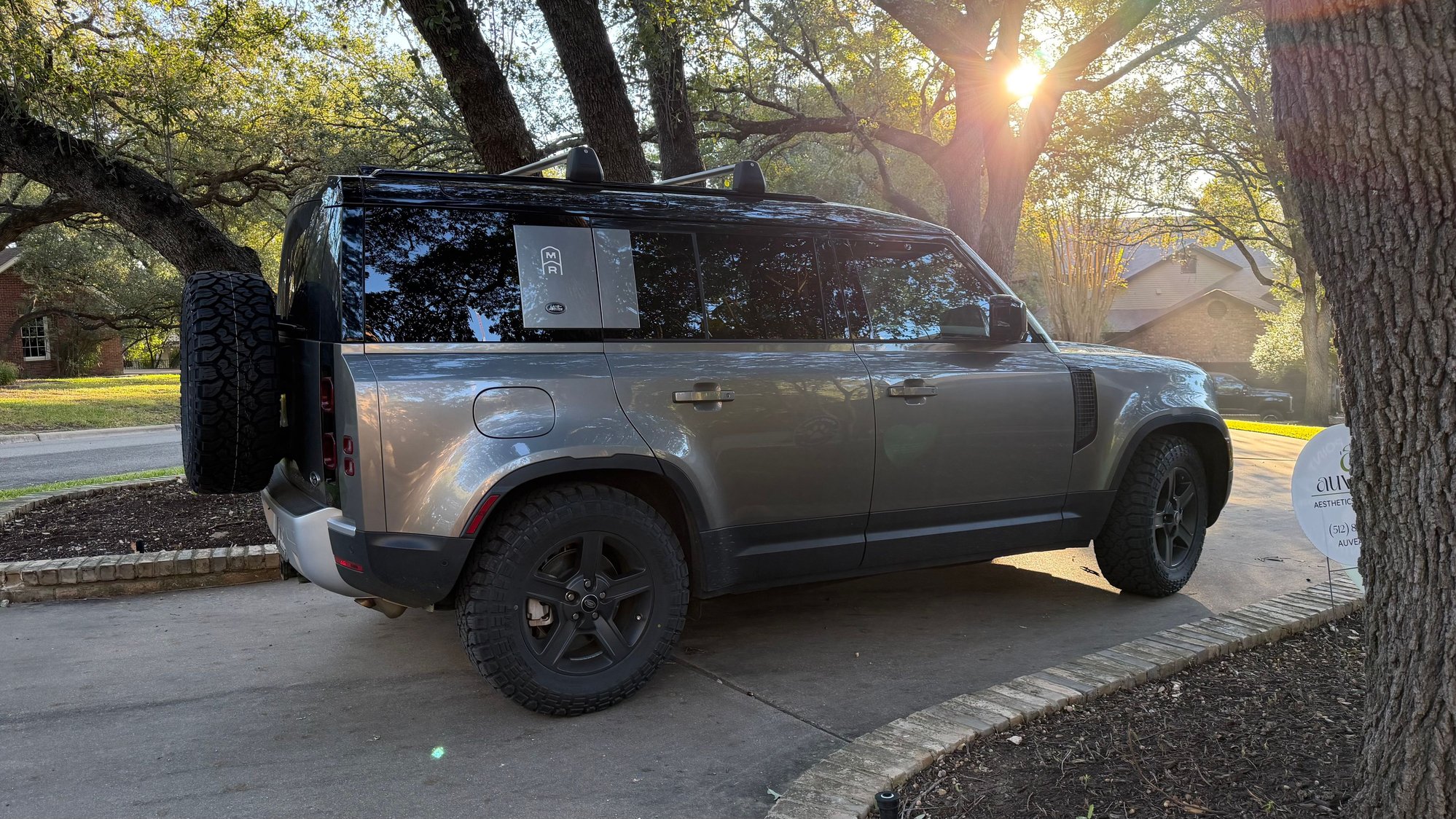

Posts: 8
Default Kenda Klever R/T
265/65/R18 Kenda Klever R/T’s fit my unmodified 2022 110 with 18” wheels. No rubbing at all height settings.

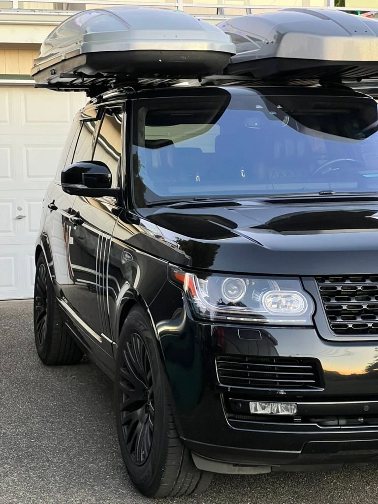

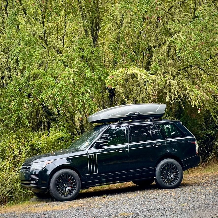

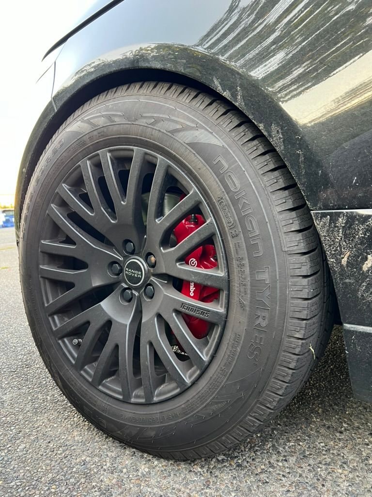

These posts are 5 years old but I just came across this specific one about the 265/65-20 not fitting a basic Defender which kind of surprises me - because - I have that size on an L405 Range Rover, 2017 SV AB, and while it did just scrub those front fender vent/louvers, they otherwise didn't rub in any movements.
To fix that scrub point, which was honestly only an audible annoyance and not really causing any damage, I tucked the fender liner back and now there is never any contact.
The 265/65-20 is usually a 32.5" tire depending on the model, like a Nokian One HT or Michelin Defender MS2 will fit better and a BFG AT KO3 will have more trouble due to the more aggressively sticking out edge lugs. Oh, and my Nokian One HT are on the Iconisus wheels which are ET 25 -ish offset which would make the scrub clearance worse than a factory wheel with an offset of ET 41.
Hope this helps in the tire fitting exercise for everyone.

The wheels have a wider offset, just right in my opinion, but be aware that any spacing out away from the hub will reduce the maximum height you can use due to clearance issues at the fender liner, mainly at the front wheels.
I have them on the Range Rover with 265/65-20 Nokian One HT but I also tucked the fender liner back at the front where the louver/vents were getting contact at about 70% turn.
