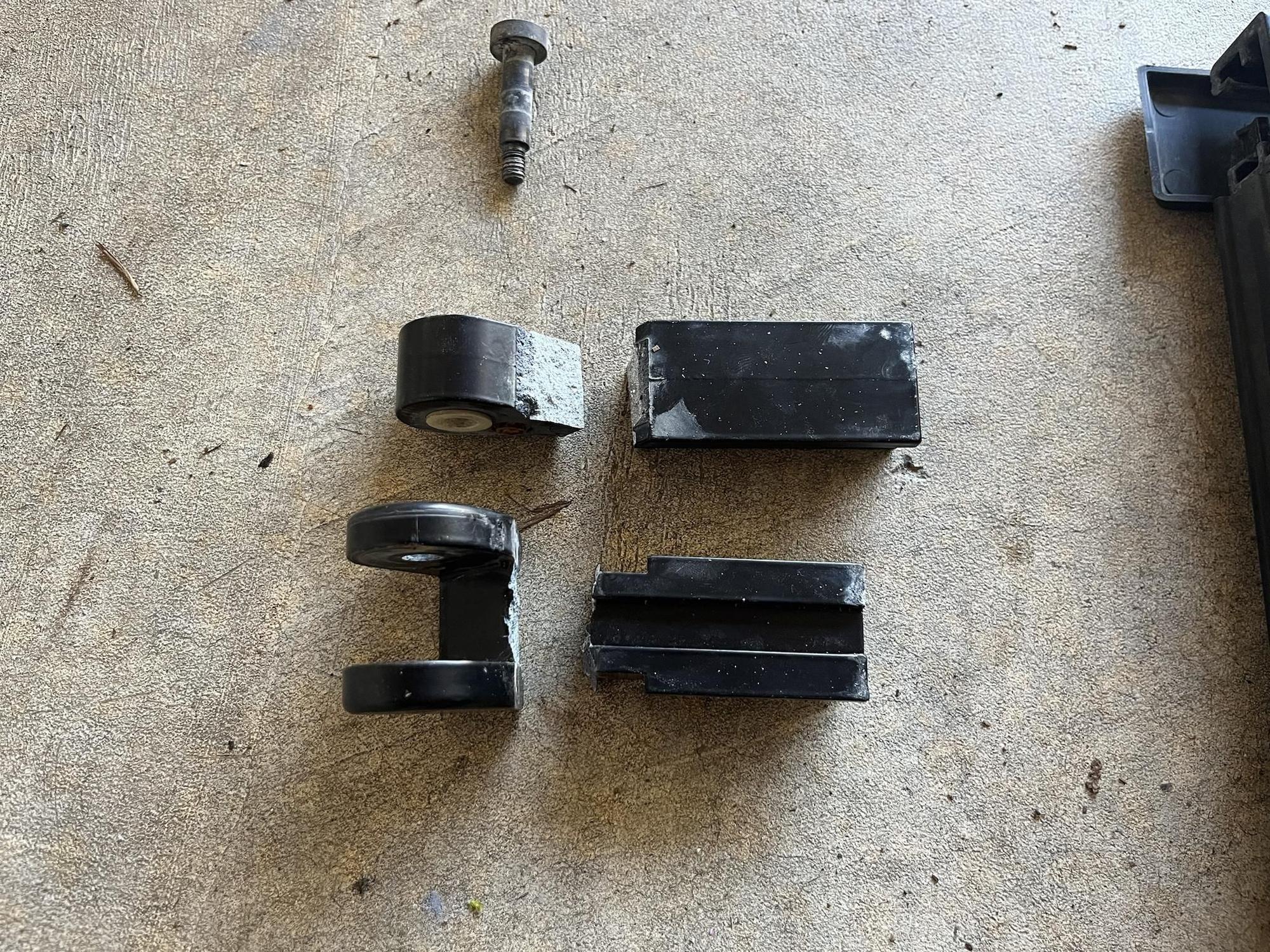

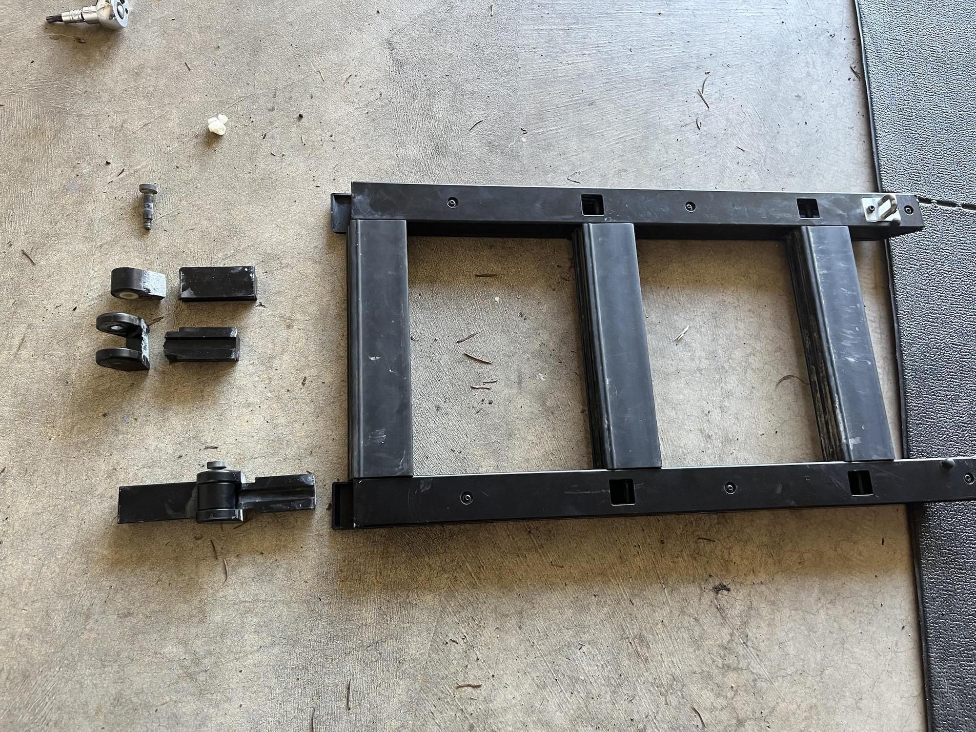

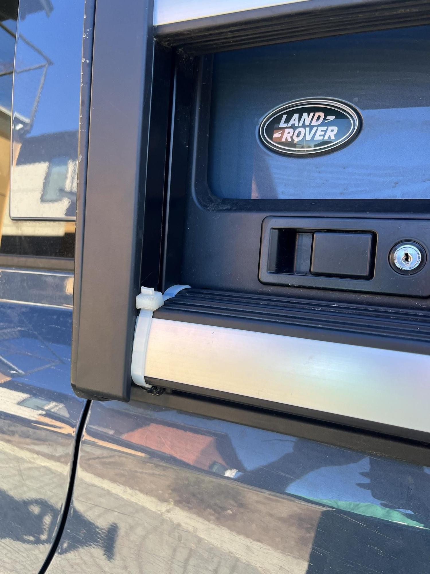

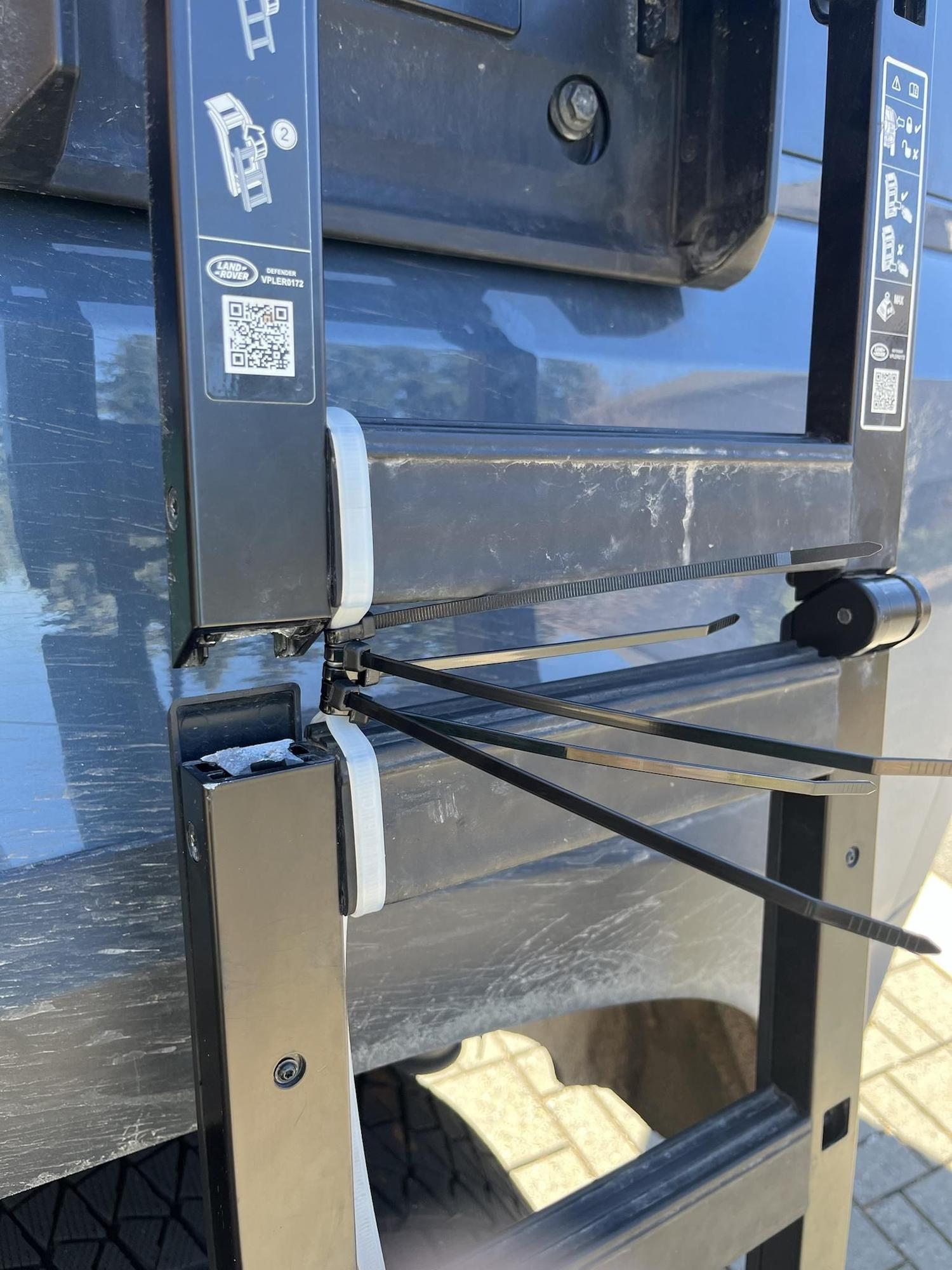

Last Saturday, I was climbing down my ladder and both metal hinges broke. Both at the same time. The metal casting just noped right out of it under normal use, doing what I've done 100's of times before.
1000+ uses with my 190lb frame up and down it. I've been a big proponent of the design, it allows excellent side access to the entire rack, but clearly it is not as good as it should be.
LR were as helpful as a fart in a spacesuit.
Told them I bought OEM for its perceived quality/reliability over the bazillion cheaper Alibamazon offerings. They only offer a year warranty on parts purchased outside of original vehicle so I'm SOL. They helpfully offered to sell me another for $1190 plus tax. Hard pass. I'll not be buying any more LR "quality" products.

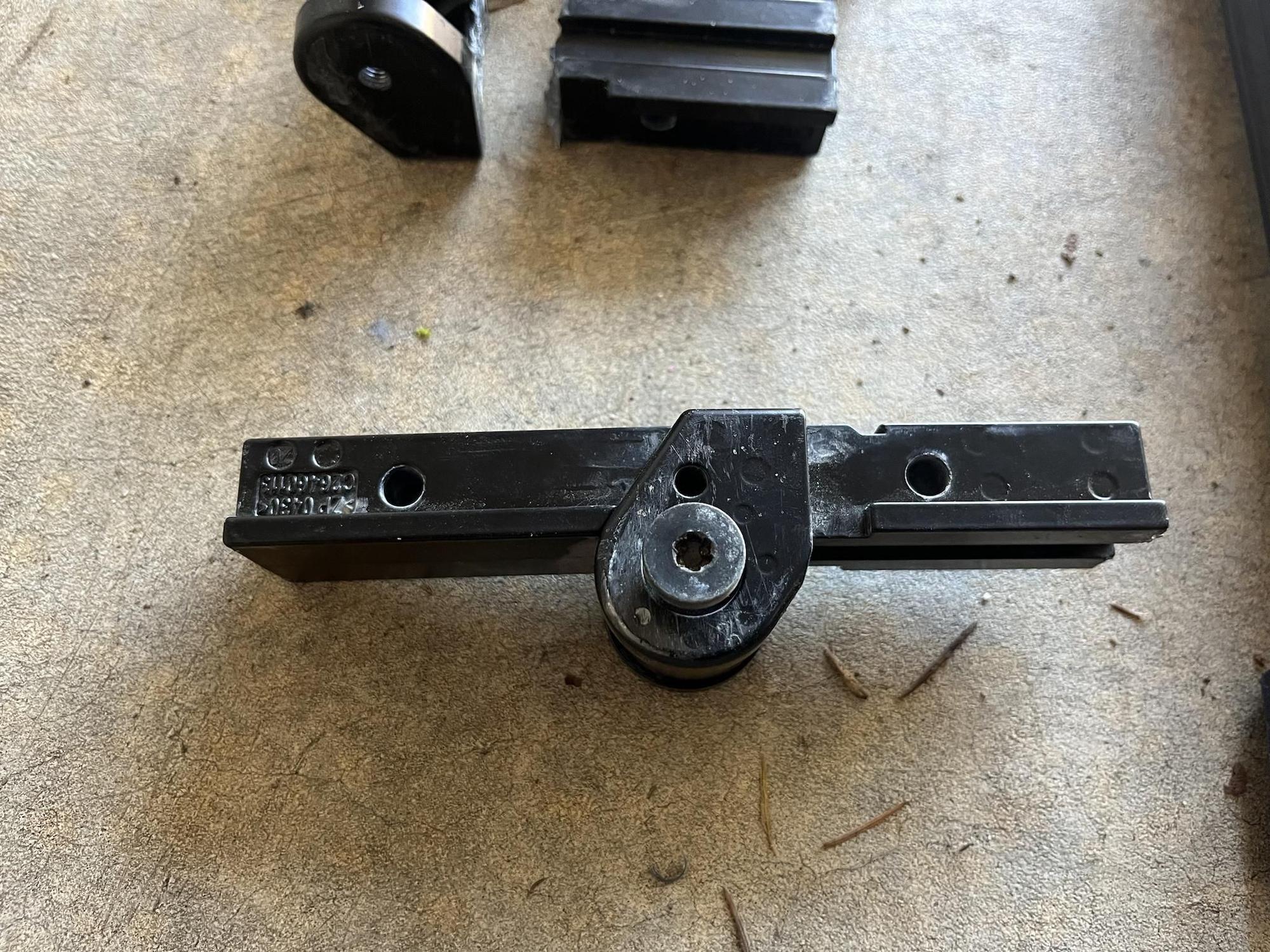

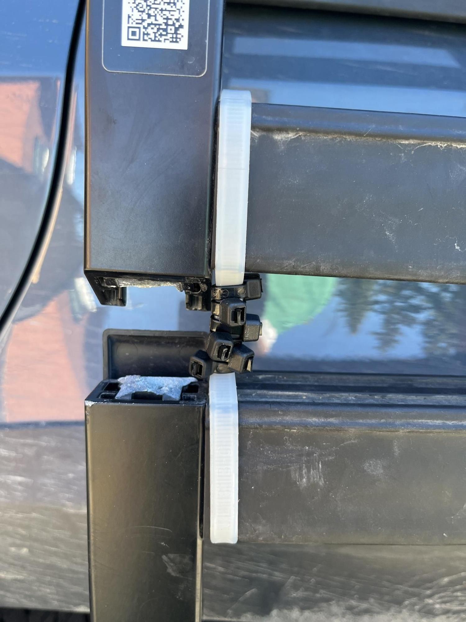

I was wondering if anyone had a broken ladder I could scavenge a hinge from. I made my two broken hinges into one working hinge and zip-ties for the other side. Looks fine but I'll just do without the lower 3 rungs. Tire will do.
2 become 1
Good as new. Patent Pending

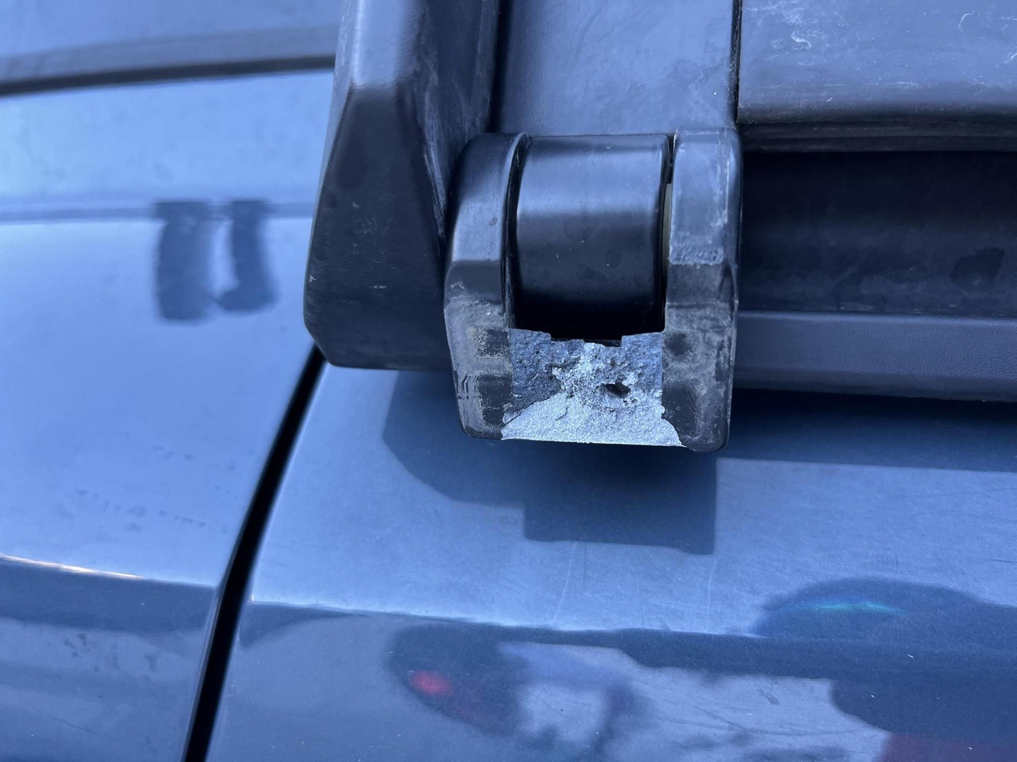

aluminum casting?
technically hinge can be fabricated, not sure about the cost.

yes. Aluminum casting. Looked porous. From my phone call with parts it Sounds like LR are aware of this design flaw. Not an isolated failure it seems.
I have a hunch the majority of ladders installed never see any use so the cycle numbers to failure might take an eon or two.
