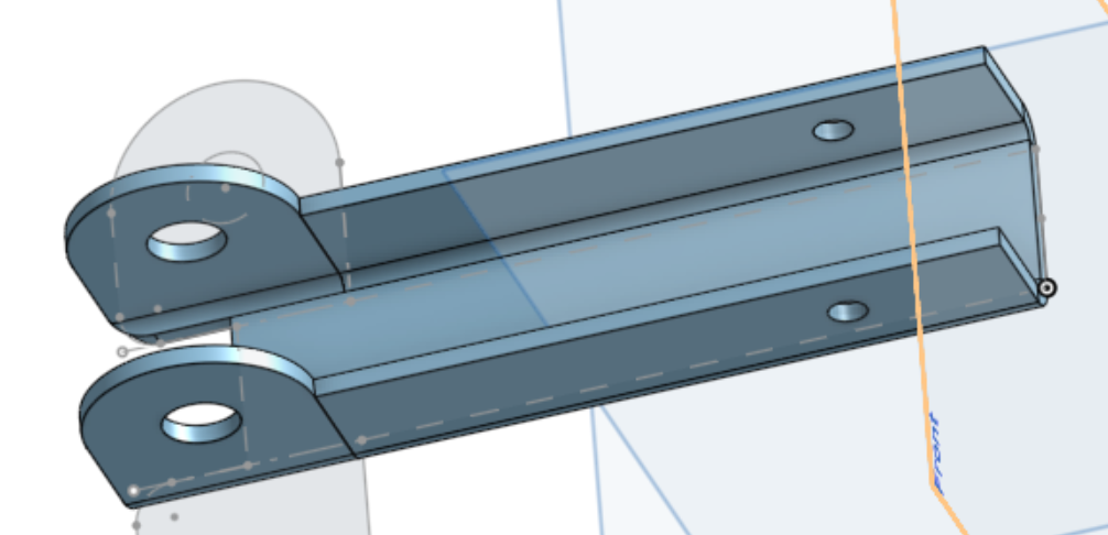

Had a quick 5 minute break at the ole 9-to-5 and did a rought sketch up of what I had in mind. Or at least a single piece of what I had in mind.
Note this isn't at all dimensionally accurate, just a rough sketch and the reliefs to allow full articulation aren't properly cut in.
This would be bent from waterjetted1/8" mild steel (powdercoated to prevent rust) and could be turned around by SendCutSend in a matter of days for probably less than $50 per hinge. I'd add a delrin bushing in between the sandwiched hinge halves to keep it from pinching in on itself but this would be more than capable of taking the weight that the rest of the widdle wadder can handle.

What would you do for the other side of the joint? Lots of pressure generated by the coupling, something would have to keep it from buckling. Rad idea though, much easer to bend a piece of cut steel.

Obviously the other half would slot inside the above piece and then would need to be padded out where it slotted into the ladder frame.
The way the whole hinge bump-stops would be tricky for sure.
I'll wait to see what Simon comes out with and for what price before I spend anymore than 5 minutes on making my idea more concrete.
