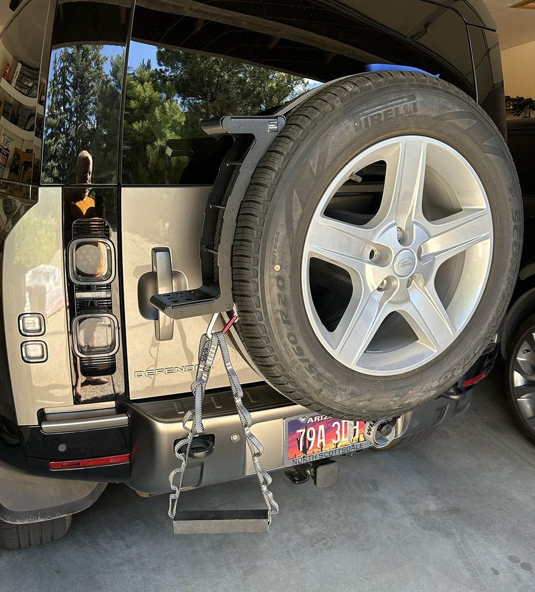

I was poking about on Expedition Portal, I listed some of my excess Pelican cases, for equipment I no longer use. Lo, there was this clever Front Runner strap onto your rear wheel ladder kind of thing. Well for $50, or the equivalent of 5 Starbucks coffees I thought I would buy it from the guy. Really nothing to loose and my telescoping ladder is a tiny bit of a pain if I have all the stuff for the RTK Ground Station in the back of the 90, big survey tripod and really long Nanuk case for the ground station itself. This kind of makes the clutter more manageable, in theory. The steps were actually for a Forerunner, which apparently has the tire considerably lower. Or it could be that South Africans have more cricket like legs than I do. They tend to be very tall people. The women are as well, like my friend Hanna, "Hanna like puny man!"
I realistically cannot lift my non-cricket like legs that high, well not without dislocating my hip. I turned to my stupidly large stash of infrequently used climbing gear. I was able to fashion an etrier out of the various bits and pieces. Now that worked better, except for the swingy thing that started up as I tried to advance to the first step. Argh, I ended up fashioning a kind of handle out of some webbing to strap further down the tire circumference. Eureka! Now it works and does not appear as if I am having carnal relations with the spare and I can get to the top of the expedition rack. Which lately has basically been the survey drone's landing pad. Since most of the places I have been running them is anything but flat.

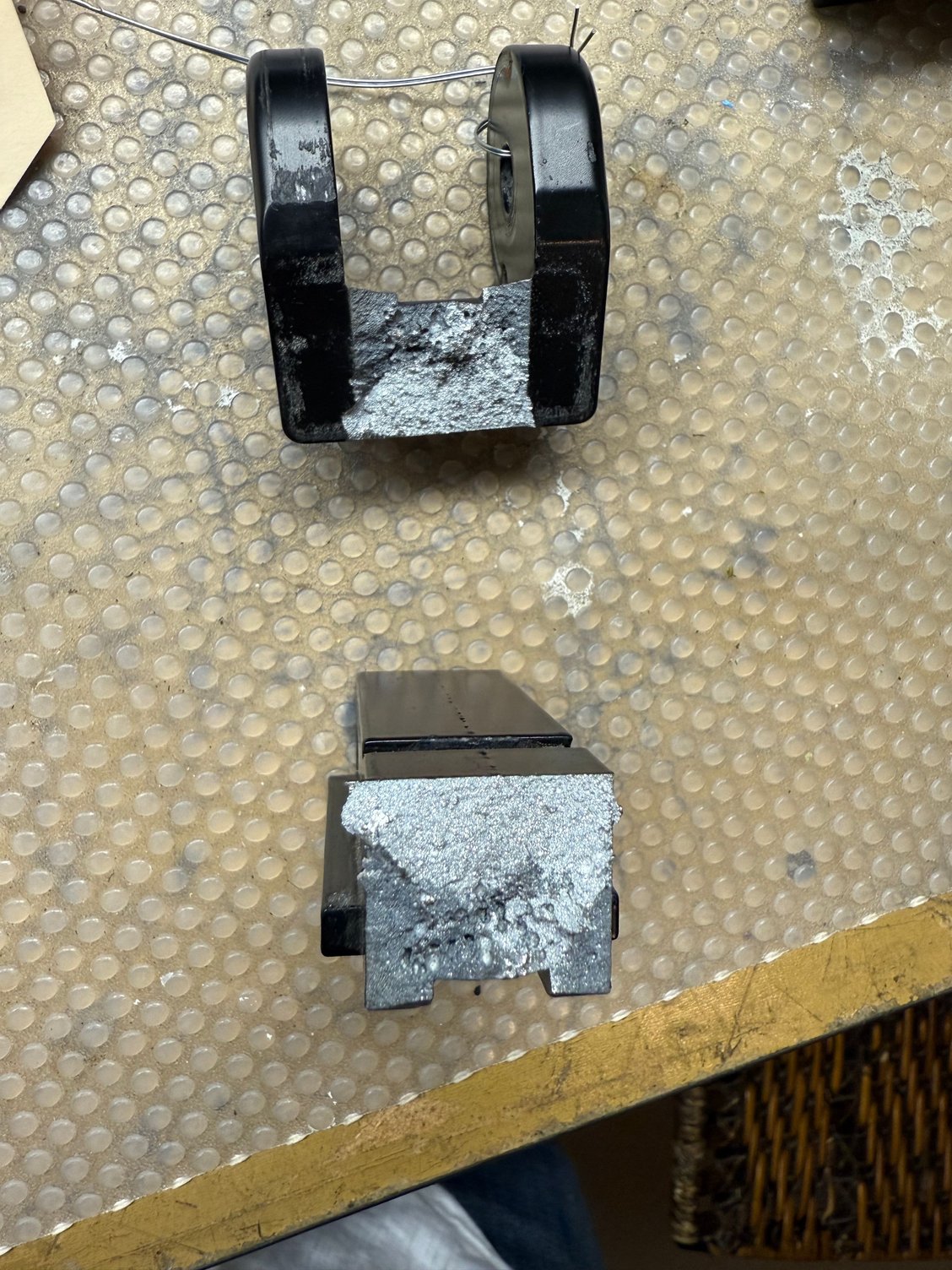

I had a very helpful member try their hardest to repair my hinge. No success. the weak Zinc casting does not lend itself to repair. I much appreciate the all the effort @outcast and generous gift of your time and expertise.

Wow, one of my hinges broke last week and I was wondering what I would find here! I took it to a local weld shop, they were going to attempt it and charge me $135, but the lead guy knew his metals and said it would never hold. I agreed and took a pass on the work. I think there were some bad castings, I have those same bubbles, a crack, then a break.
This explains why there are so many new ladders on Ebay asking $230! Check it out. I'm thinking to buy one and keep the old one for parts or at least the extra hinge. Gavin's zip-tie job has good temporary potential as well.
I think you're on to something with Simon, he'll come up with a good replacement. Not going to be cheap, but worth it. I hate wasting things.

it’s a weak zinc alloy. Doesn’t lend itself to any sort of repair.
