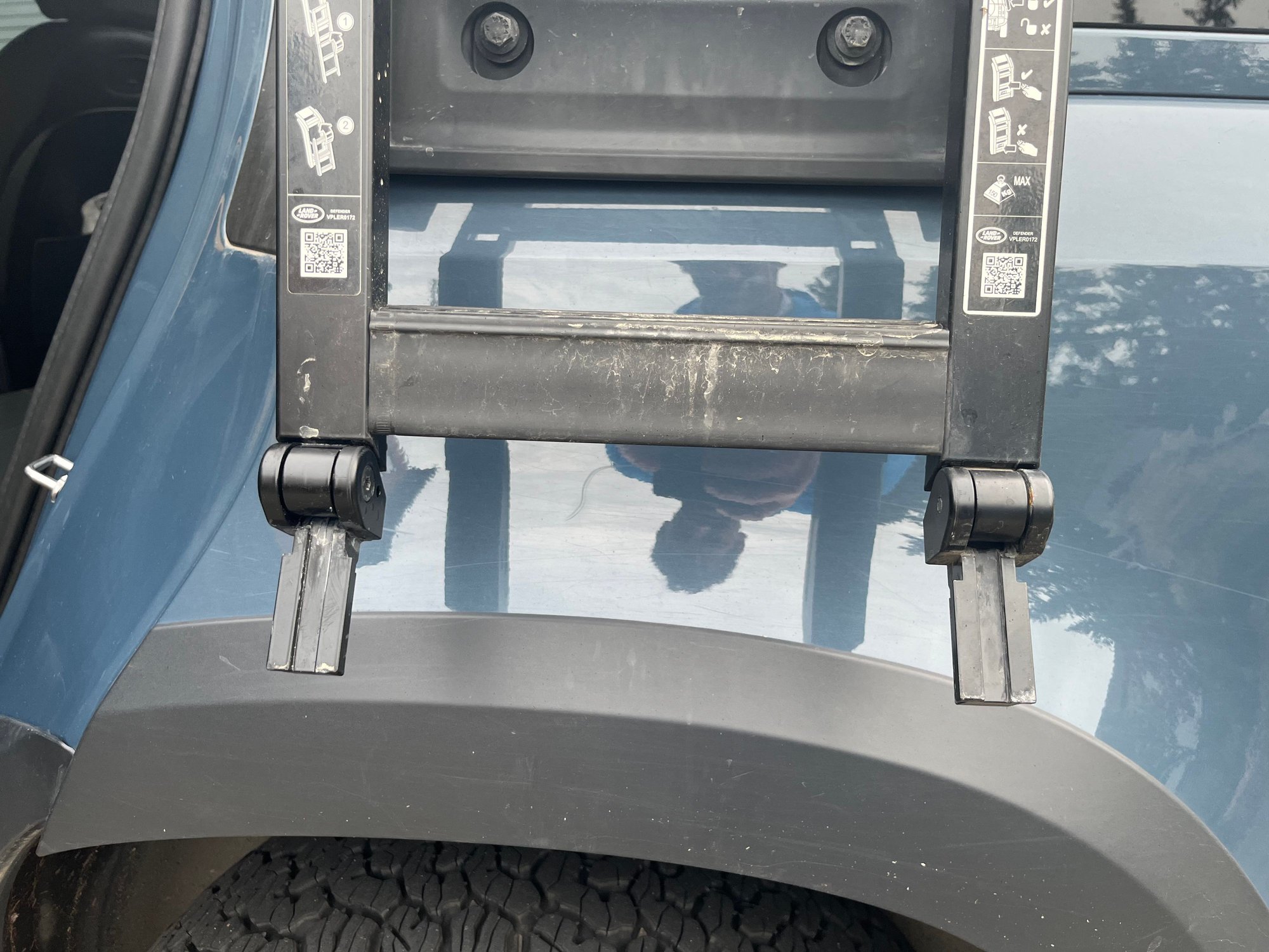

I spoke to Simon (Powerful). And I looked at my aftermarket ladder more closely. My hinges aren't even cast aluminum - they're plastic! So we are looking into it. I have one bad knee due to skiing and am not going to risk it or the other on a plastic hinge.
If neither Simon nor I can come up with anything worth producing, I will def be fabricating something (steel, welded). If I can manage to do it without too much time expenditure, maybe I'll make a couple of sets. At the very least, I'll document what I've done and post it here so that you can look for a fabricator. It might take some time, though. Months. Not days. Sorry.

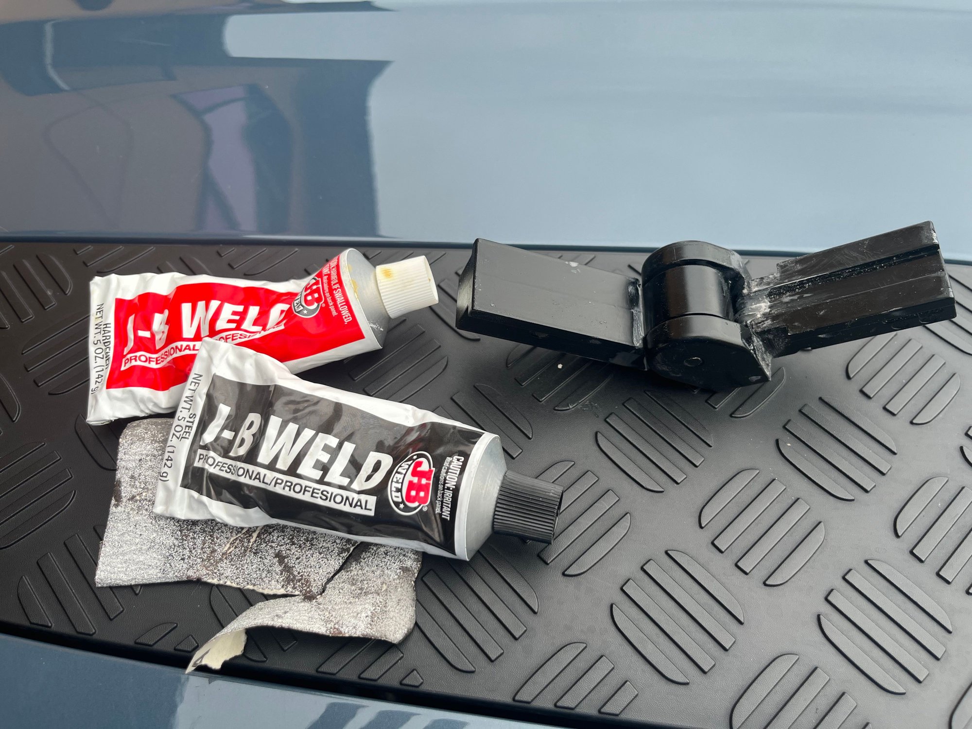

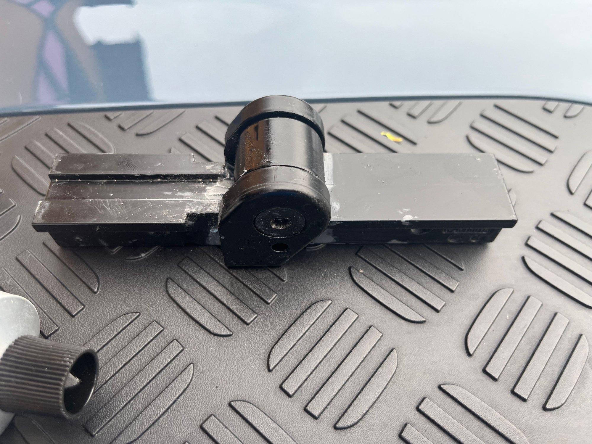

I look forward to seeing what you come up with.
I did a search on the stamped letters/numbers on the hinge and found out that it is a zinc alloy in the hinges. Not Aluminum as I initially assumed.
Plastic hinges will for sure fail but perhaps they will distort before fracture occurs.
Anyway, I've tried zip ties, and JB weld. Gorilla glue is next just to have it looking right. I just use the top three rungs (till I forget one day)
