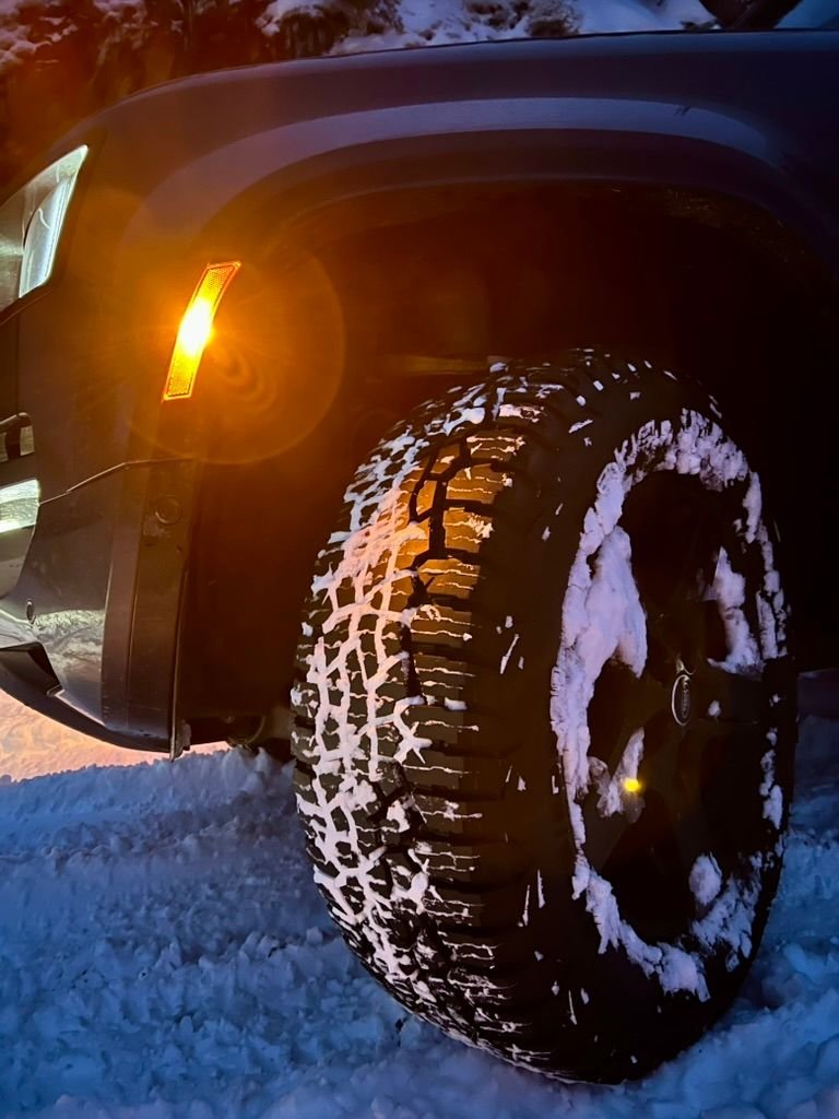

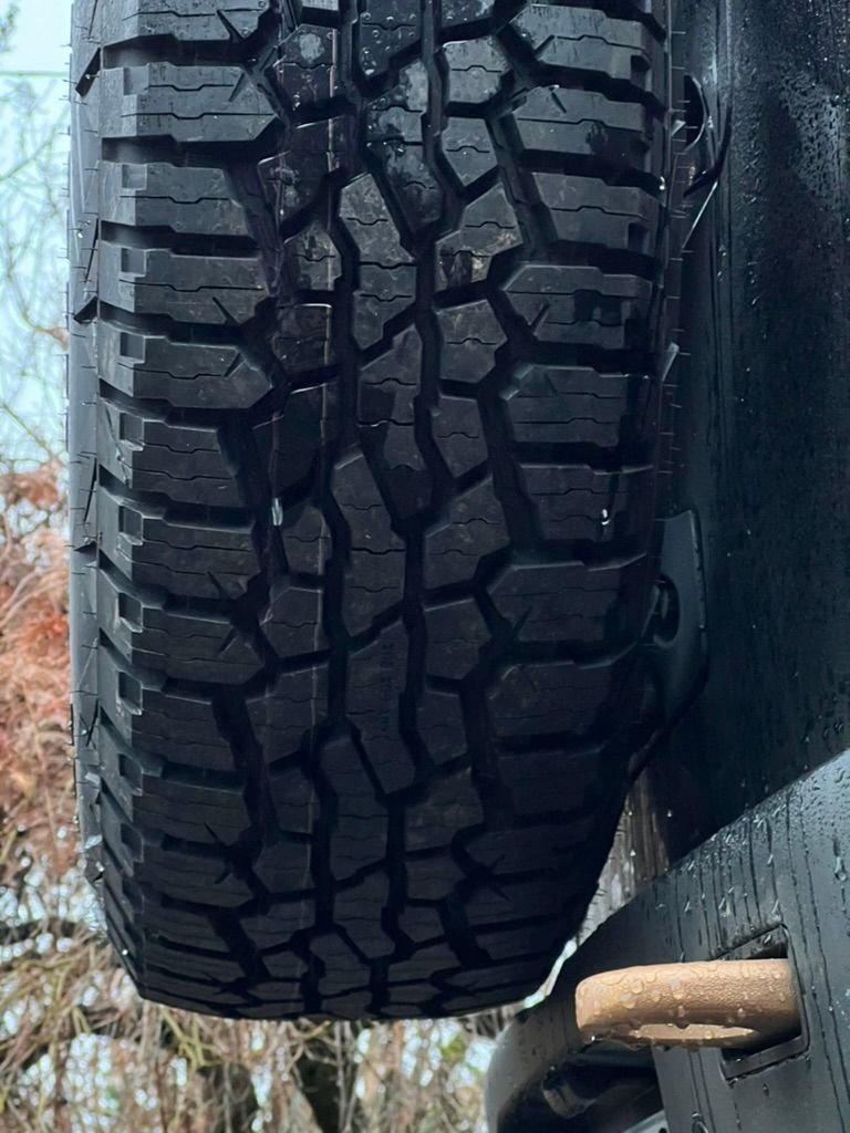

I went through 2 sets of BFG Ko 1,2, 3. Great tire but I'm now more excited about the Nokian Outpost NAT that I'm using now. They've tested to better snow and rain traction but also a great design and a little quieter so far.
These wheels are the basic 20" that came on a lot of 2021 era Defenders.

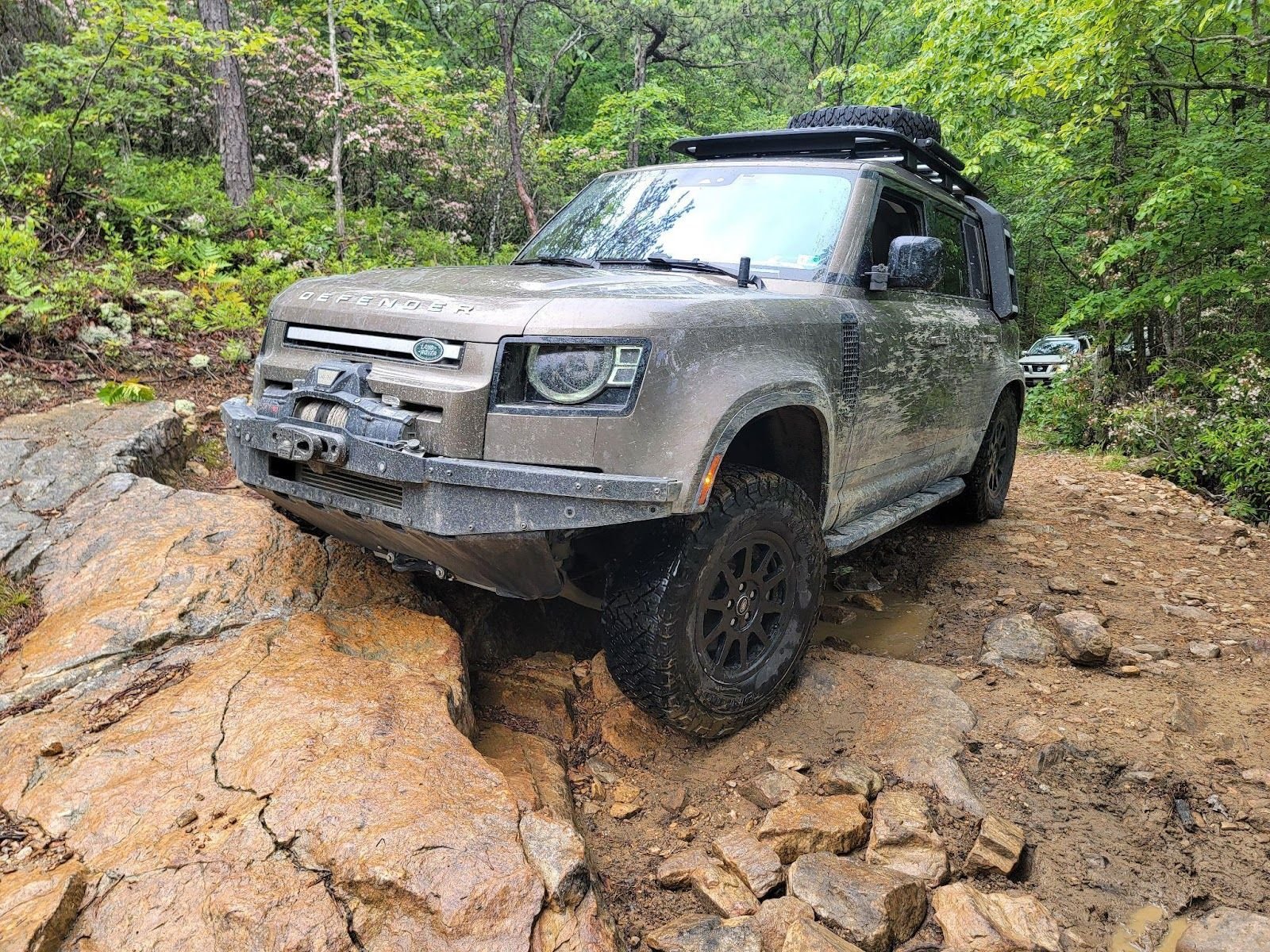

I moved to the KO3 a year ago. The off road capabilities is a given, but I was surprised on how well it handled on pavement. I have the TuffAnt Kimberleys in the 18" which is an incredibly strong wheel. They now offer that model in a 20" wheel.
