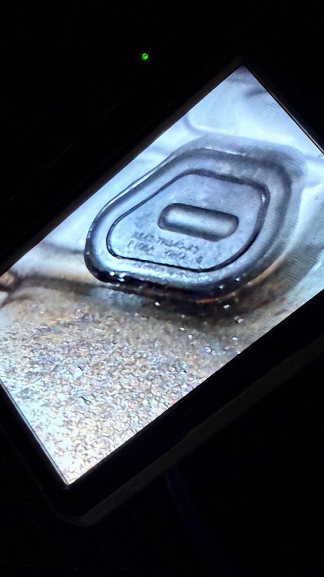

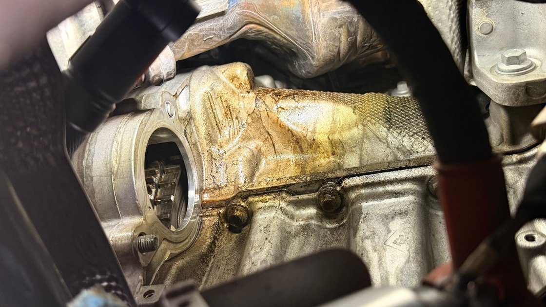

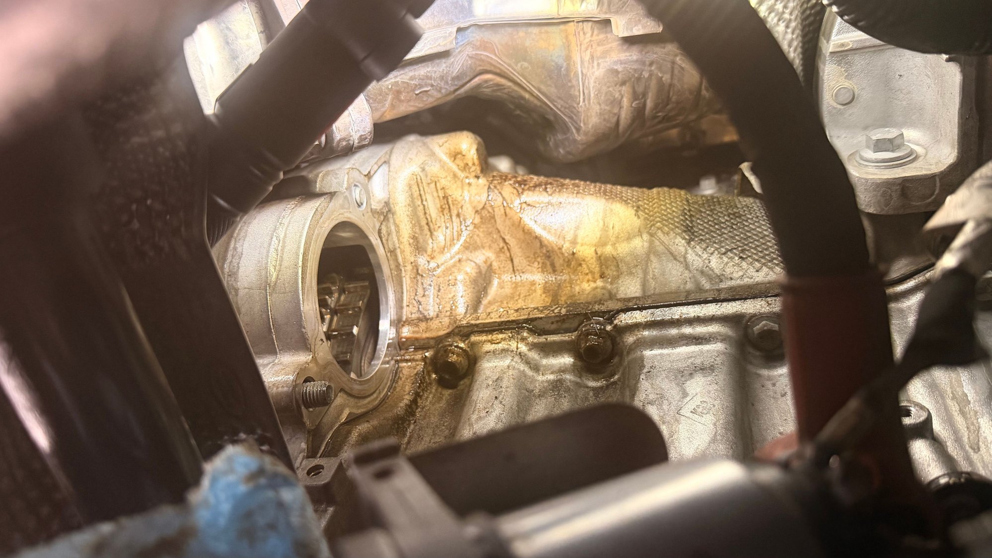

I have a slow oil leak coming from the rear/top of the engine, above the starter. Oil is sort of pooling up around the inspection plug (similar to LR183648 on the driver side), then slowly running down the exhaust side of the engine.

With the starter removed
Plug location
Plug location
Plug
Plug
