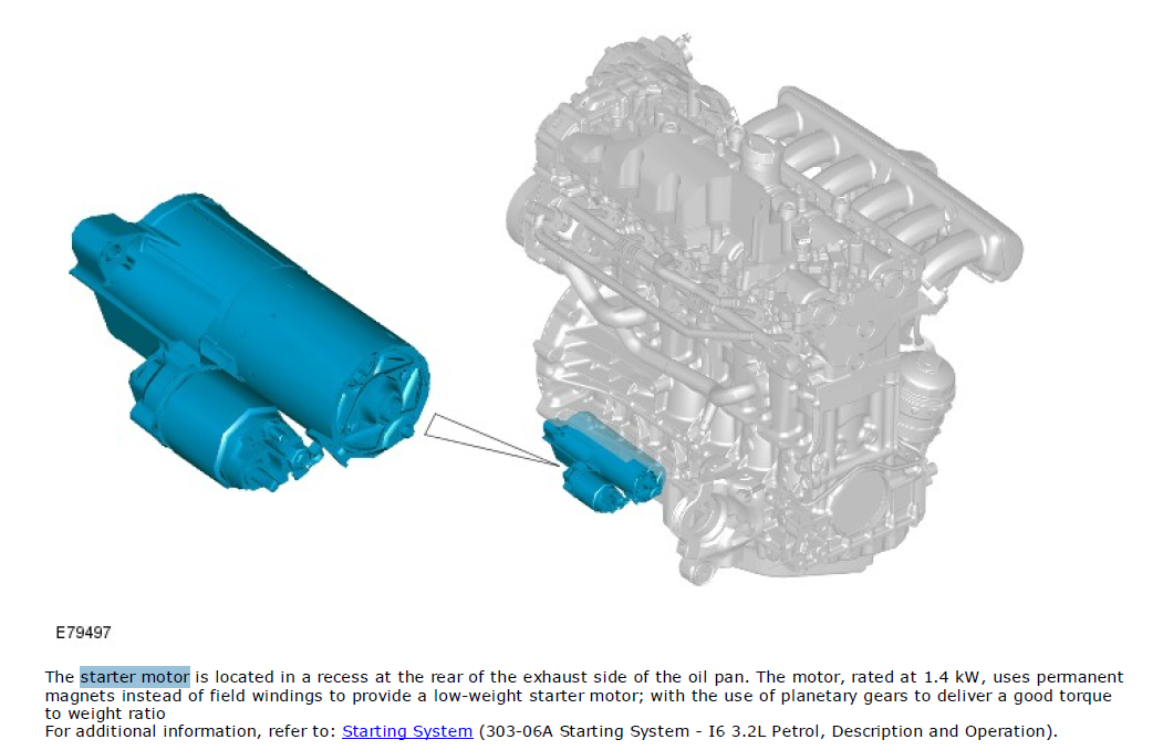

Hey all,
Brand new to this forum. Hello!
I have a 2010 LR2 that I purchased recently. I LOVE the vehicle, but in our short time together, I had the rear differential replaced (grinding) as well as the AC repaired due to a leak. All of these were covered by the previous owner.
Don't want to get too deep in the details, but I had the starter replaced yesterday and when I look under the hood or underneath the vehicle, I see no evidence of a new part. Just wondering it's location so I can check on it. I can't seem to find any diagrams or photos on line of the vehicles components.
Thanks in advance!

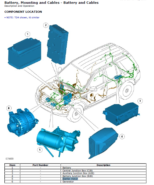

Hey thanks!
Is it possible you have a higher res version of this? Before I go rolling around on the ground in the winter, I want to know if I can see it up top.
Thanks again!

You can't see it from the top. It's at the bottom front of the engine, in a recess next to the oil pan.
