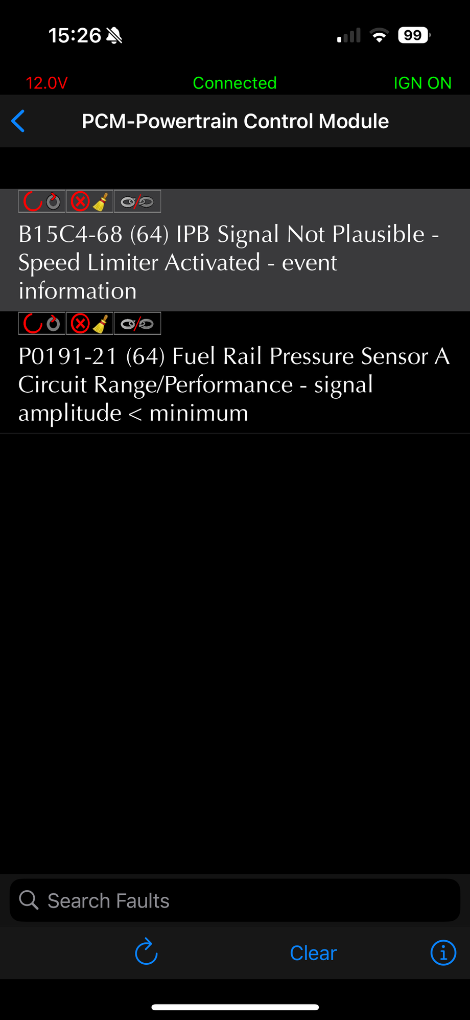

'22 D90 V8 with ~24k miles
In the last 2000 miles, my Defender has had two instances where the engine shut off at idle speeds. Once today when coming to a stop, another instance while my wife was driving and she had been stopped at a light for a couple of minutes. Auto Start/Stop disabled via Gap Tool, so it was not that. It also went into limp mode right aterward, to what felt like 20% max throttle and would not rev over 3000RPM.
Went to scan it and it looks like it might be a fuel pressure or fuel pressure sensor issue? Has anyone else run into this? I have a trip to the dealer scheduled for a month out from now (!!, that apparently is the earliest these cars can be serviced in the Denver area right now). I haven't tried driving it yet to see if restarting cures the limp mode as I was close to home when this happened.
These are pending codes, no MIL yet.

Take it to the dealer and let them fix it under warranty. You probably have a bad sensor.

The P525 engine has been out for a good while and used on many LR platforms. Based on your findings, it is highly likely you will get a new fuel pressure sensor. They do go out but yours is too new for it to go out so soon. With your LR being a 2022, it is a year where there were a lot of supply chain issues and there were many sensors issues for that particular year. Good luck and let us know what your dealer finds out.
