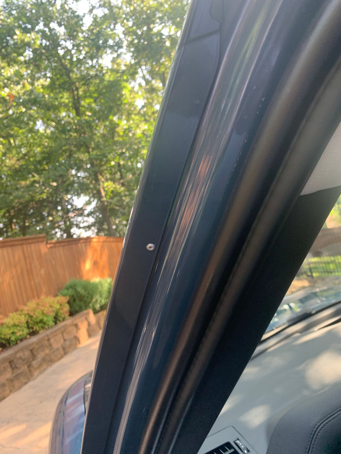

We had this same issue on our 2020 Defender 110. After employing a variety of duct tape and Velcro solutions, I decided to fix in permanently in about two mins. Drilled one hole here where you can’t see it, and installed one pop rivet. Done.

I tried posting this before but it isn’t here. I went through all of the temp fixes for the A-pillar problem. Duct tape, Velcro under the pillar trim, etc. Adhesive always failed eventually. So I got out my drill and in two mins drilled a 5/32 hole thru the trim inside the door opening into the body and put in one pop rivet. Done for good now!
