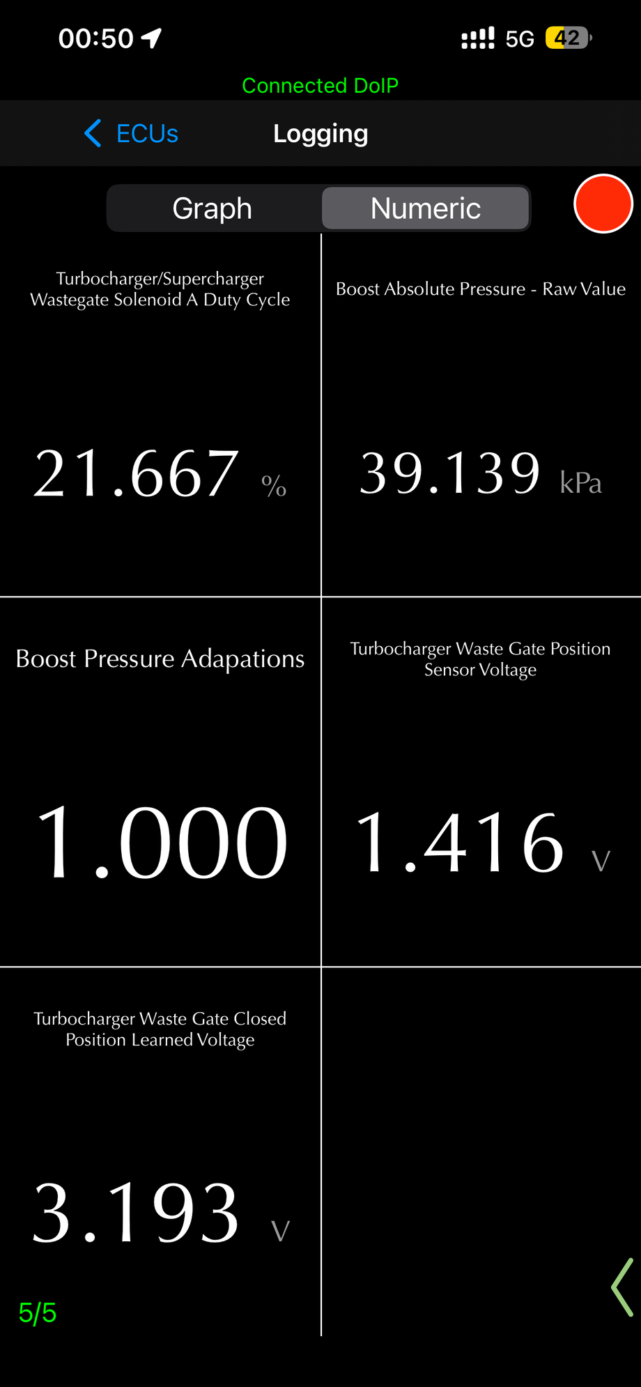

Old Yesterday | 09:03 PM
crackhead's Avatar
Joined: May 2023
Posts: 74
Likes: 12
Issue is back. Car is also down on power. No low boost dtc. Will check the linkage and connector.
edit: can someone tell me what their values for the actuator voltage.
