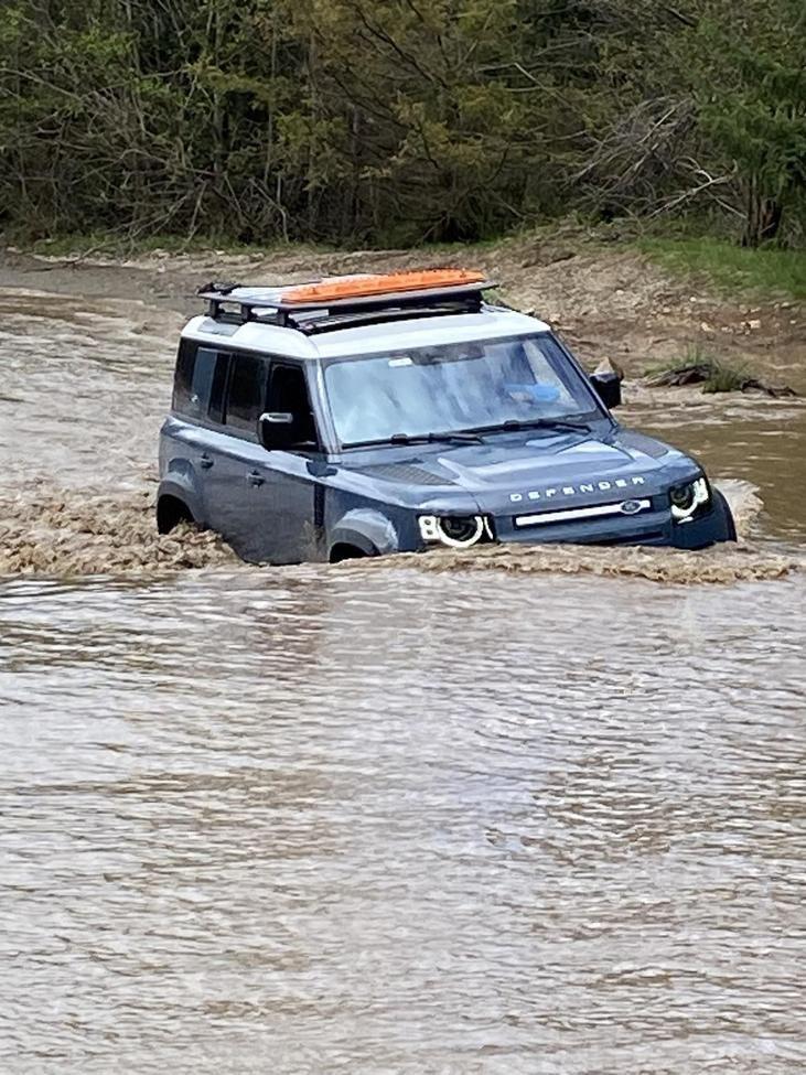

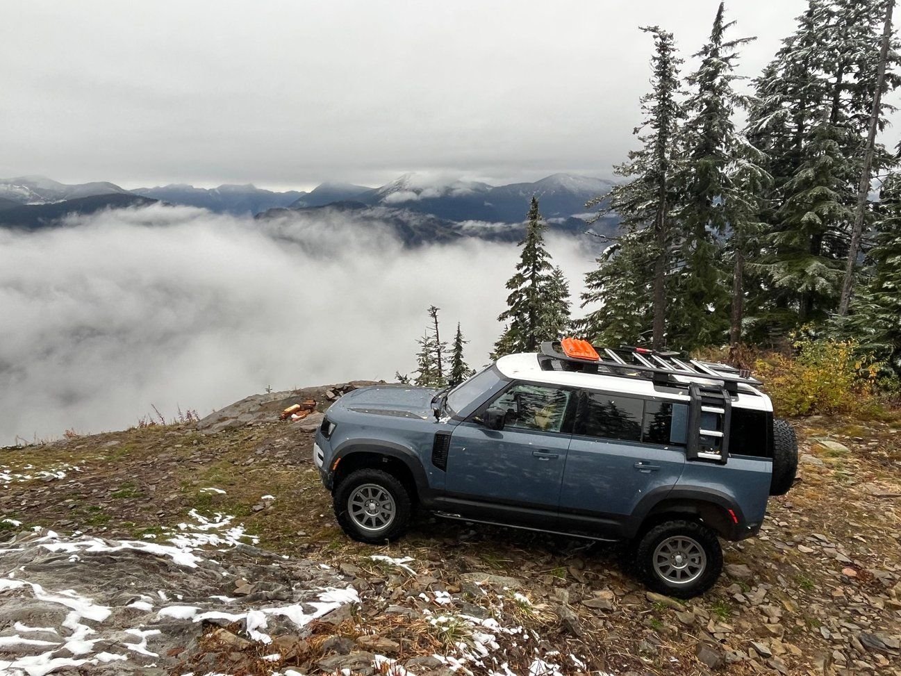

Can't complain. Cleanliness, next to godliness or something
Showroom shiny.
The secret is good wash a few times year. Keep those pinstripes popping
