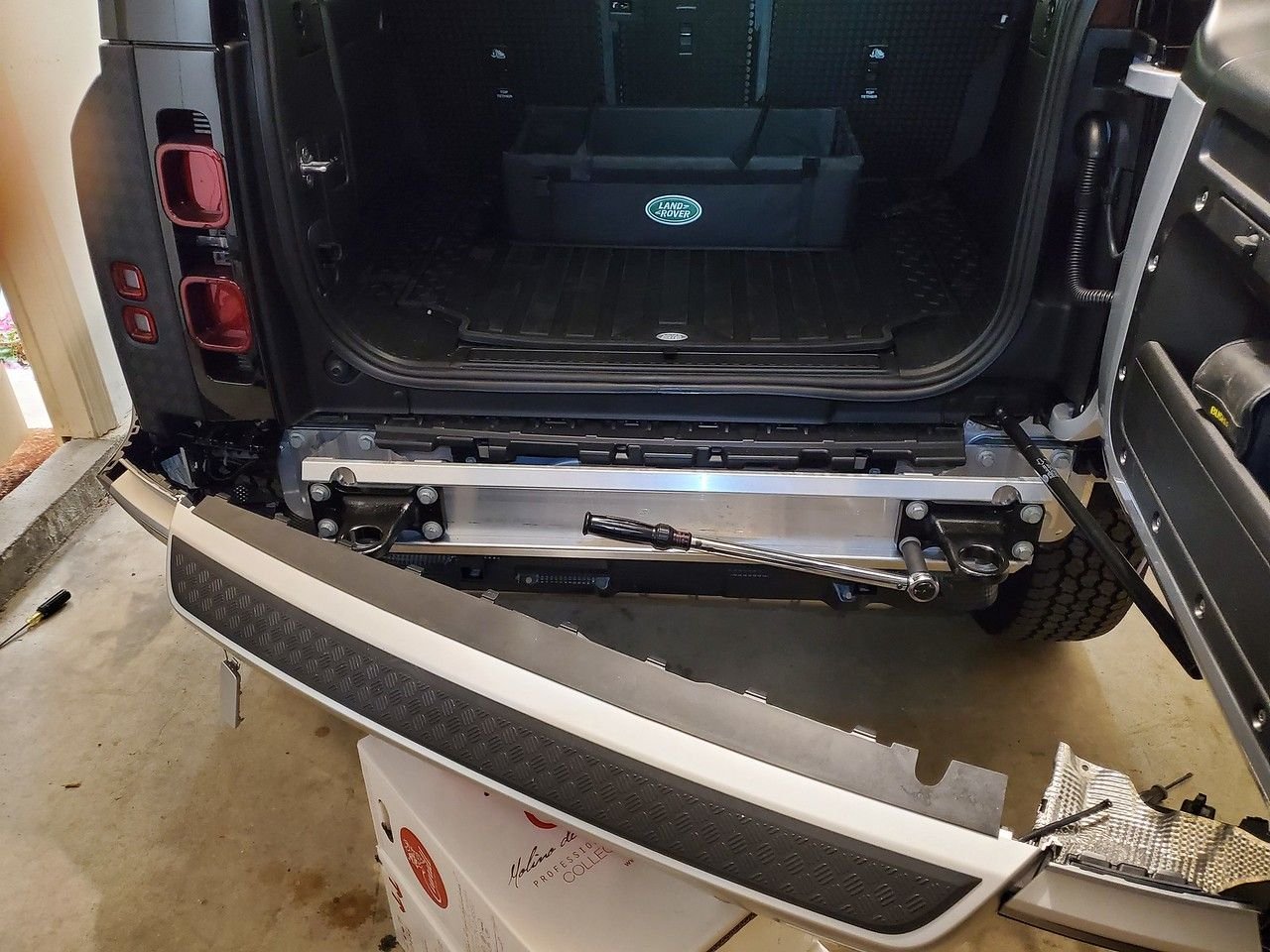

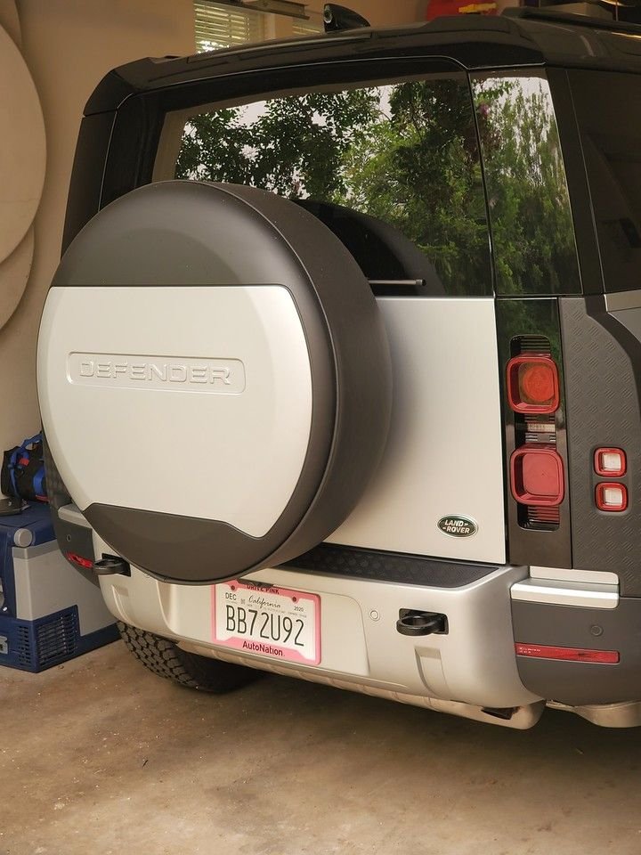

Here are a couple of photos I took while installing mine. It took me maybe an hour and a half, by myself in my garage with screwdrivers, a torque wrench and sockets and some cardboard boxes to support the bumper cover while I installed the new towing eyes. Didn't even have to remove the bumper cover completely as you see, I only disconnected the lines on the RH side (following the video from PowerfulUK) and the screws on the left, then opened it up like a book and was able to remove the factory anchors for the screw-in towing eye and replace them with the fixed types. In the second photo you can somewhat see the installed frames from PowerfulUK, which make the look cleaner around those edges.
Nice! Looks like I have my first project for when the car arrives!

For future reference, those 8 big bolts need to be tightened to 170 Nm / 125 ft lb of torque.
