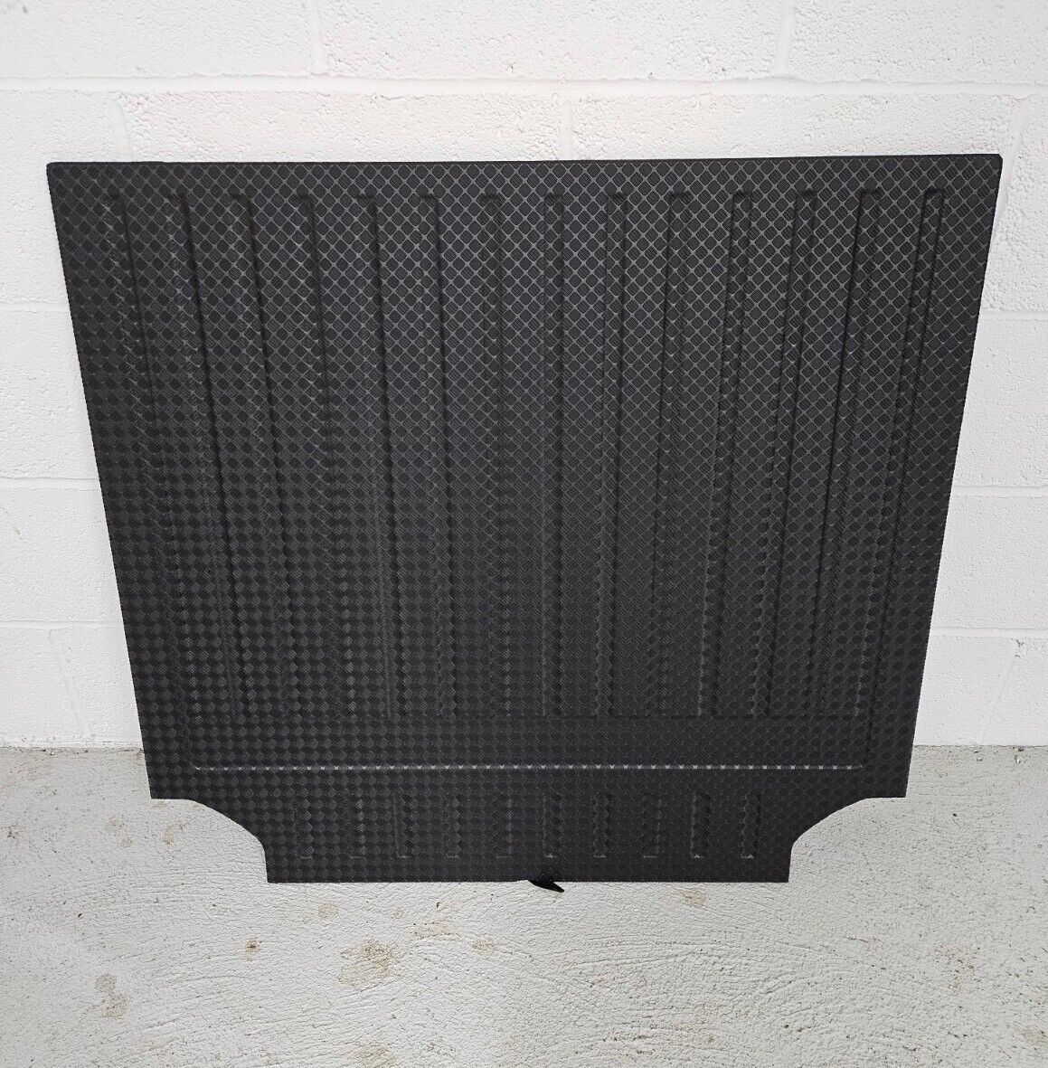

Commercial floor cover - seems to be same shape as 5 seater MHEV floor, ish, maybe adoption and probably good and durable and I think it comes with a hinge, although on a 7 seater, nothing to fasten the hinge to. Pics below.
LR 143064 - ?
*** PHEV models and non MHEV models have further entirely different part #’s btw, but since I have a P400 MHEV I didnt look those up, You can find them here - https://parts.jaguarlandroverclassic...nd/land-rover/
5 seater floor cover top side
5 seater floor cover underside
Commercial floor cover - same shape as 5 seater floor cover.
Commercial Floor cover part #

Quote: 3 -- And then the last difference is this floor cover. I have been trying to source a used 5 seater floor cover, and then see if I could trim it or reshape it, to fit the floor if I removed my 3rd row. Which would work if it’s “bigger” than the hole. But I’m not sure. There’s also the “Commercial” cover avail in the UK that might work. Most people just make their own out of plywood and whatever else.
I'd be happy to take measurements of my 5-seat cargo floor so you can see if it'd be possible to trim it down to fit. Let me know if you'd want me to do that.
Reply 1
Feb 9, 2025 | 10:51 AM
Quote: Apparently, although I haven’t verified, someone tried it on here a few years ago, and the sides are different on the 5 seater floor cover. Also, there’s nothing underneath it to support it from sagging.
Anyone know if the Commercial Floor cover will fit into a 110 5 seater? Looks much more sturdy than the standard piece. I do see that the Commercial unit has an understructure that this bolts into, but I cannot tell if that is to support the undertray the Commercial has or to support the Floor cover.
