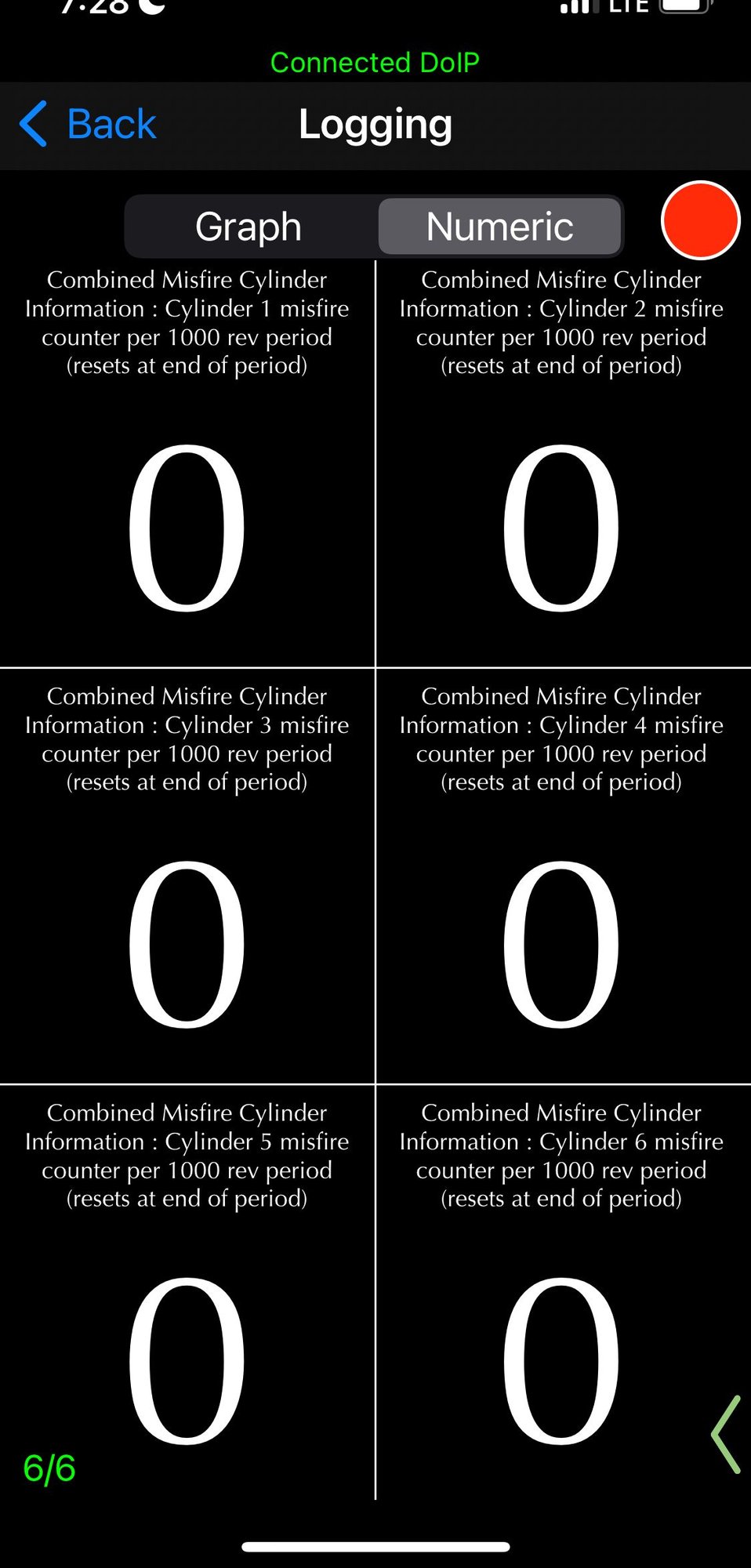

I was wondering -- upon driving, did you notice any improvement in drivability / smoothness / throttle response -- or other improvement?
Seems just the same. I wasn’t noticing anything untoward before the swap.
I had checked with my GAP tool for any misfires. None of any significance noted.
All driving very smooth today.
GAP IId tool live values misfire count.
