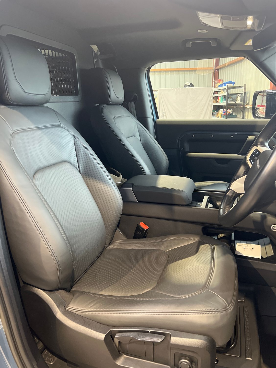

Hello, recently I purchased a new 2024 defender commercial, unfortunately I missed the leather seat when ordering.
i have now purchased hse commercial front seats and was wondering will the harness plug and play or will i have to get this sorted too?

Ok after speaking to a breaker, from 2024 on they think the change is all on the seat itself ie power the module in the seat using the same plug and it may just be a case of coding

Not seen that done on a L663 yet, but you will almost certainly need the CCF (car configuration file) change. Google GAP Diagnostic IIDTool.
Most of the harnesses are modular, so your breaker could be correct in that you're ok with ccf editing. Sometimes changes to the harness are needed, but it should not be an insurmountable problem.

Ok, so the rails, wiring etc where all completely different, not just a case of changing harnesses etc
what I did do was just swap the leather over.
this worked really nice, bubble wrap effect still on leather 😂
