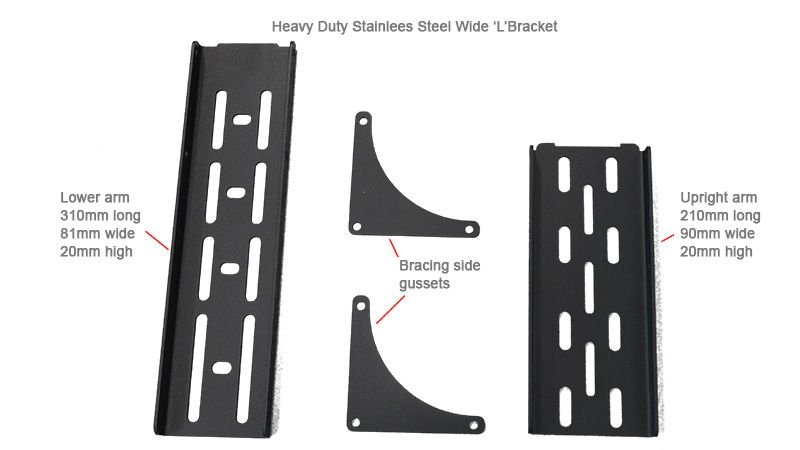

Thanks for the feedback. It comes with 2 "heavy duty L brackets" (pictured) and I haven't seen anyone complain about them so I expect them to be strong enough. You don't see an issue with the cross bars supporting that weight to one side and nothing else on the cross bars?

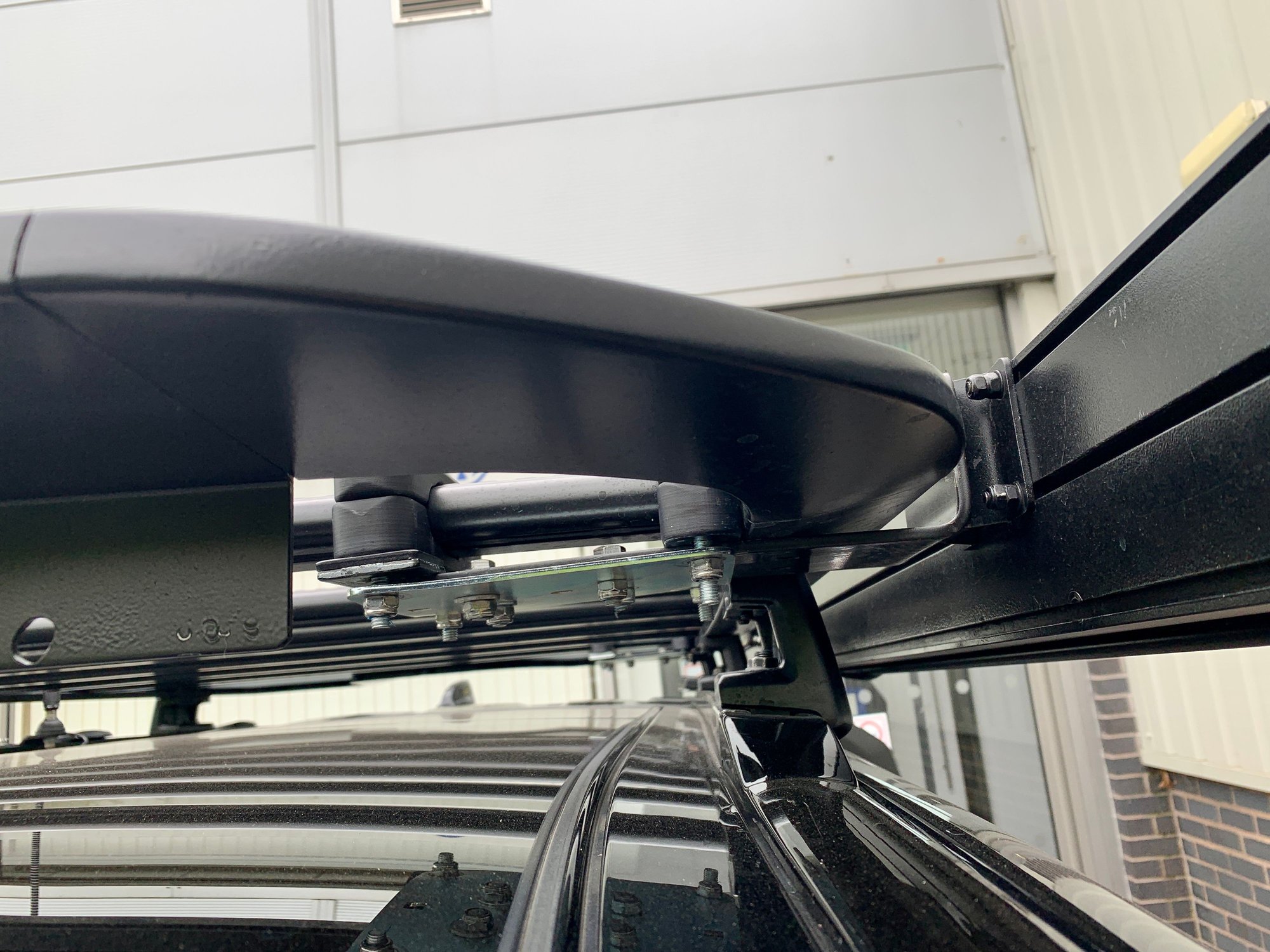

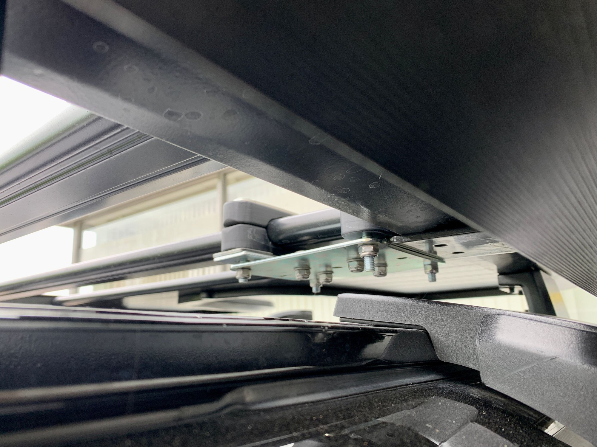

As I already have the factory Explorer roof rack, I was unsure as to the tenacity of the t-slots so I fitted the Powerful UK rack mounts. They’re solid and I’ve fitted my quick release ARB awning brackets to those and have no issues or movement at all, even with the green laning I do.
