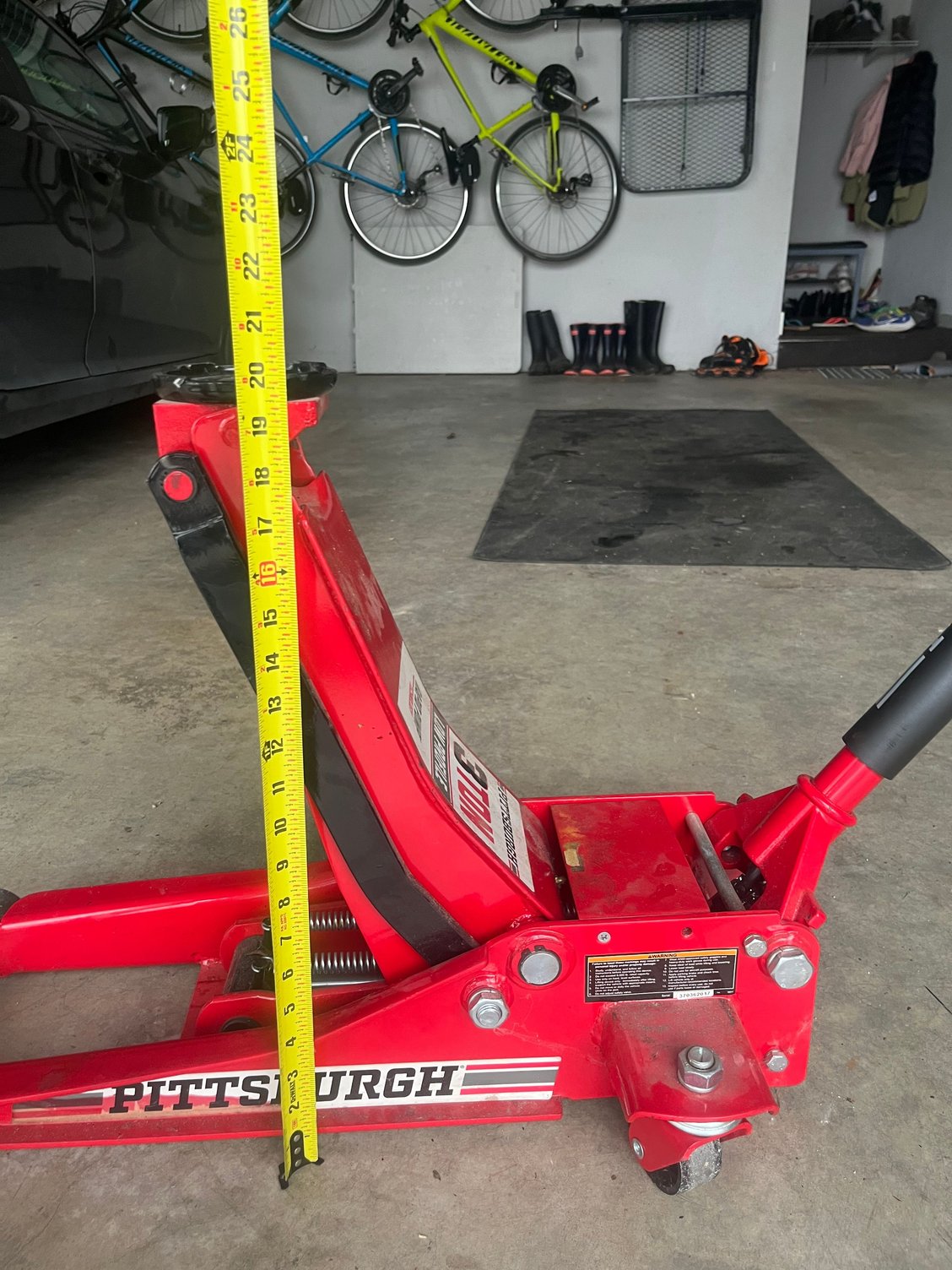

Pitsburgh 3T floor jack from Harbor freight.

My 3 ton trolley jack lifts to a max height of 20 inches. Yours says a little over 18inch
And mine maxed out at 20 inches doesn't lift the wheel off the ground
It's a puzzle..

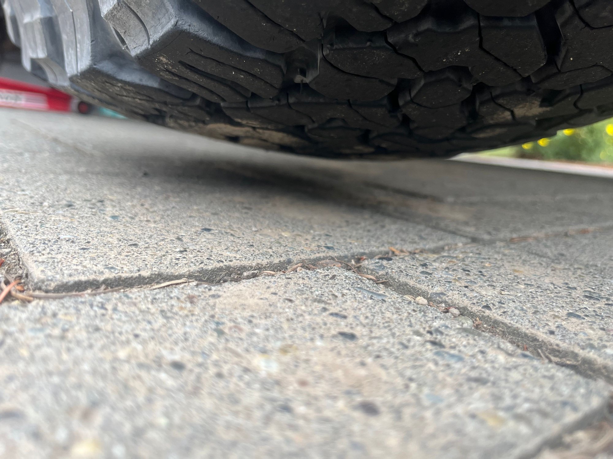

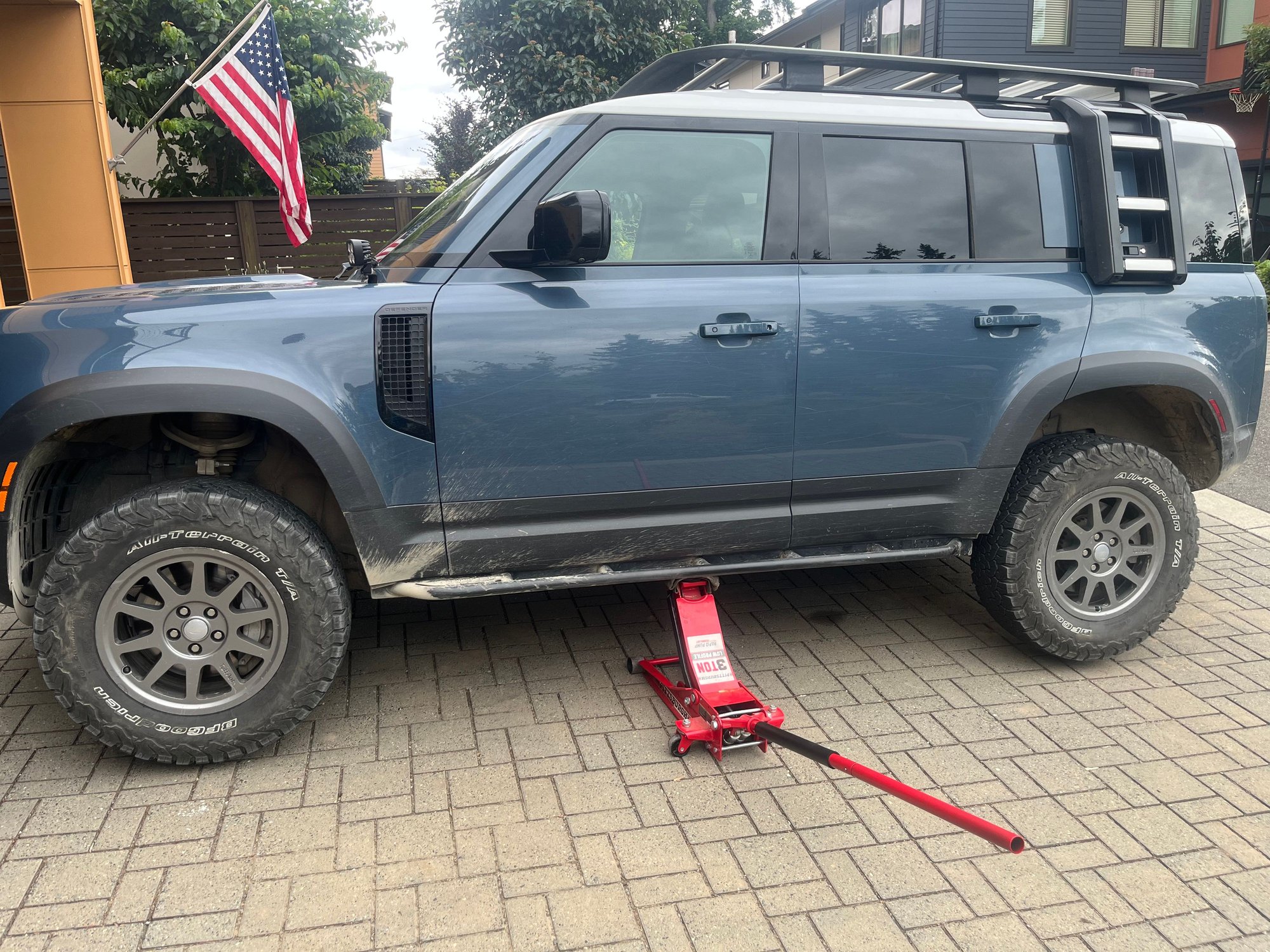

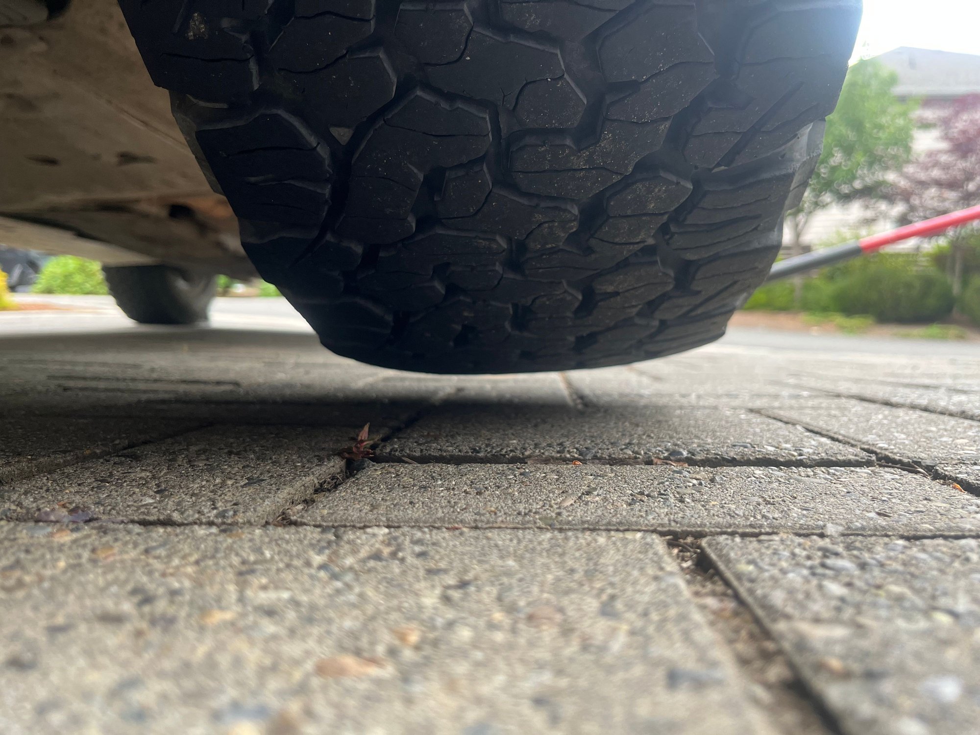

Here it is in use with slider.
you can lift the entire side. Both wheels off the ground.
only works if the car is off so the suspension doesn’t try to do its thing.
lowest setting. It’s in access. Door is ajar. Car is asleep.
Jack and slider. Pinch welds work just as well for lifting.
Front
Rear
Rear.
Front.

Firstly, my 3-ton trolley jack has a very impressive 21 inches of max lift height and worked perfectly on the LR4 and the Discovery (both with air suspension). The issue on the defender is that while it lifts higher than many other trolley jacks (including GavinC's one) - that's only when using the saddle extension piece that has a start point of nearly 10 inches. So the total actual lift range is just over 10inches. Not enough to get the wheel off the floor...
So I replaced it with a new 3T husky floor trolley jack that lifts from 3inch to 19 inch (no saddle extender). This works easily. Car in lowest suspension height, leave door open (as I've always done) and the new jack lifts it effortlessly with an inch or two of space under the tyre
