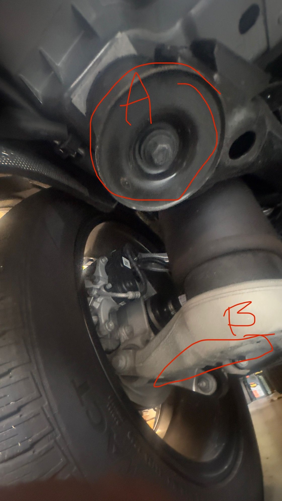

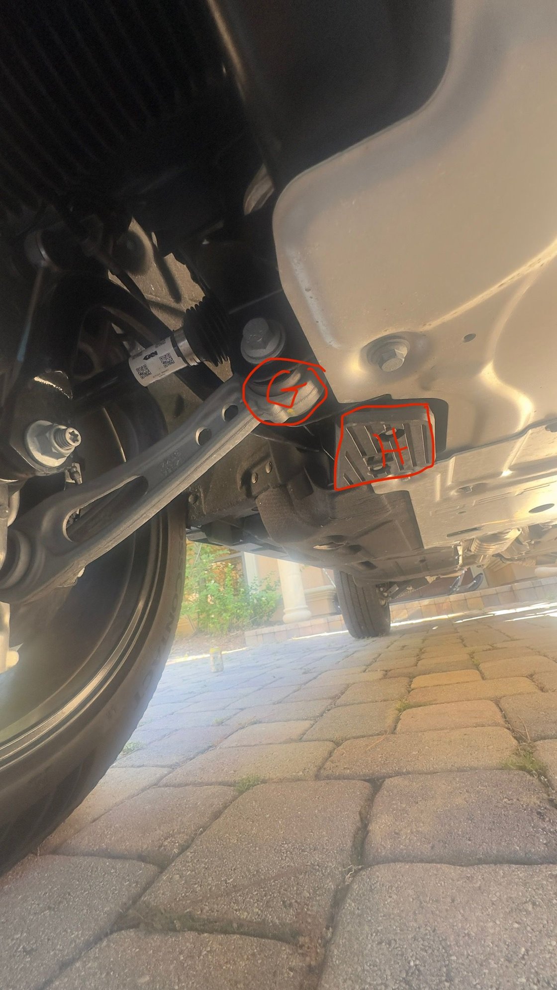

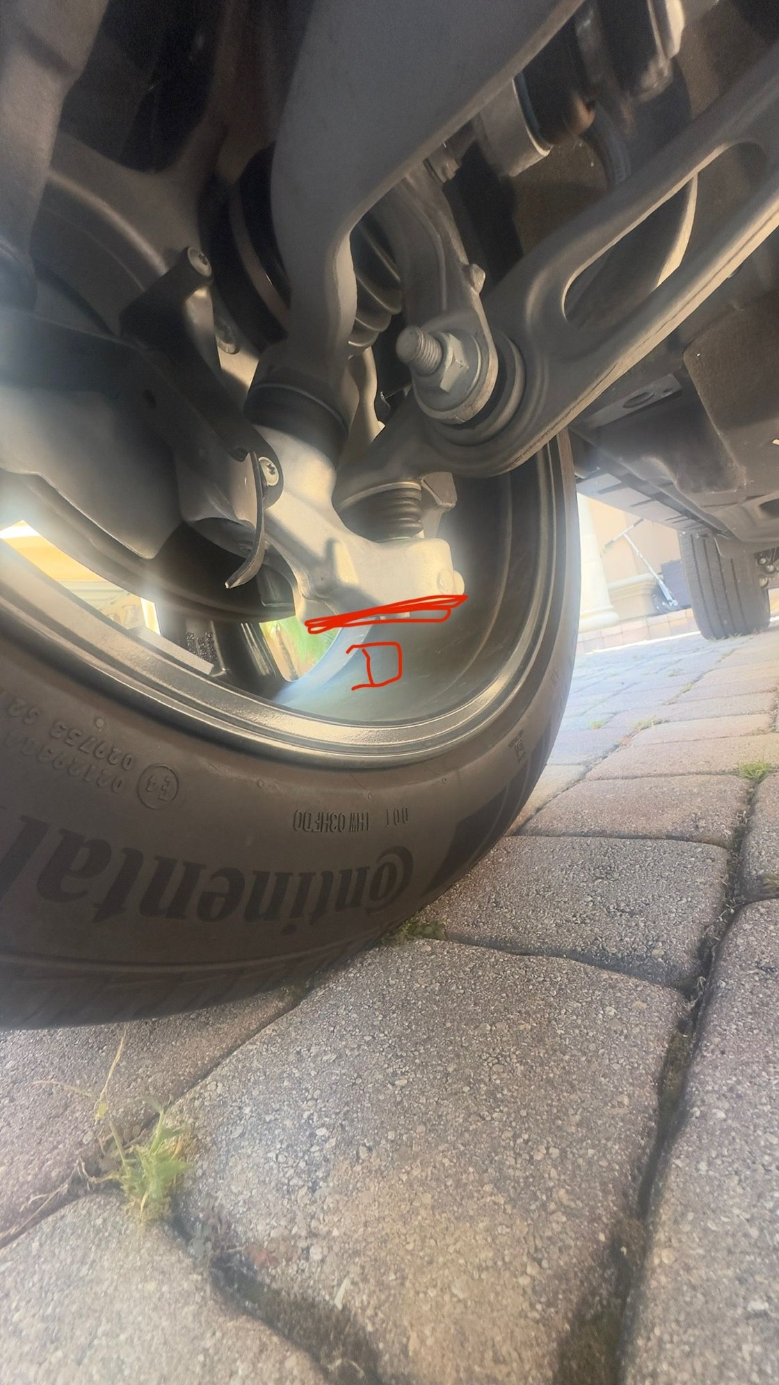

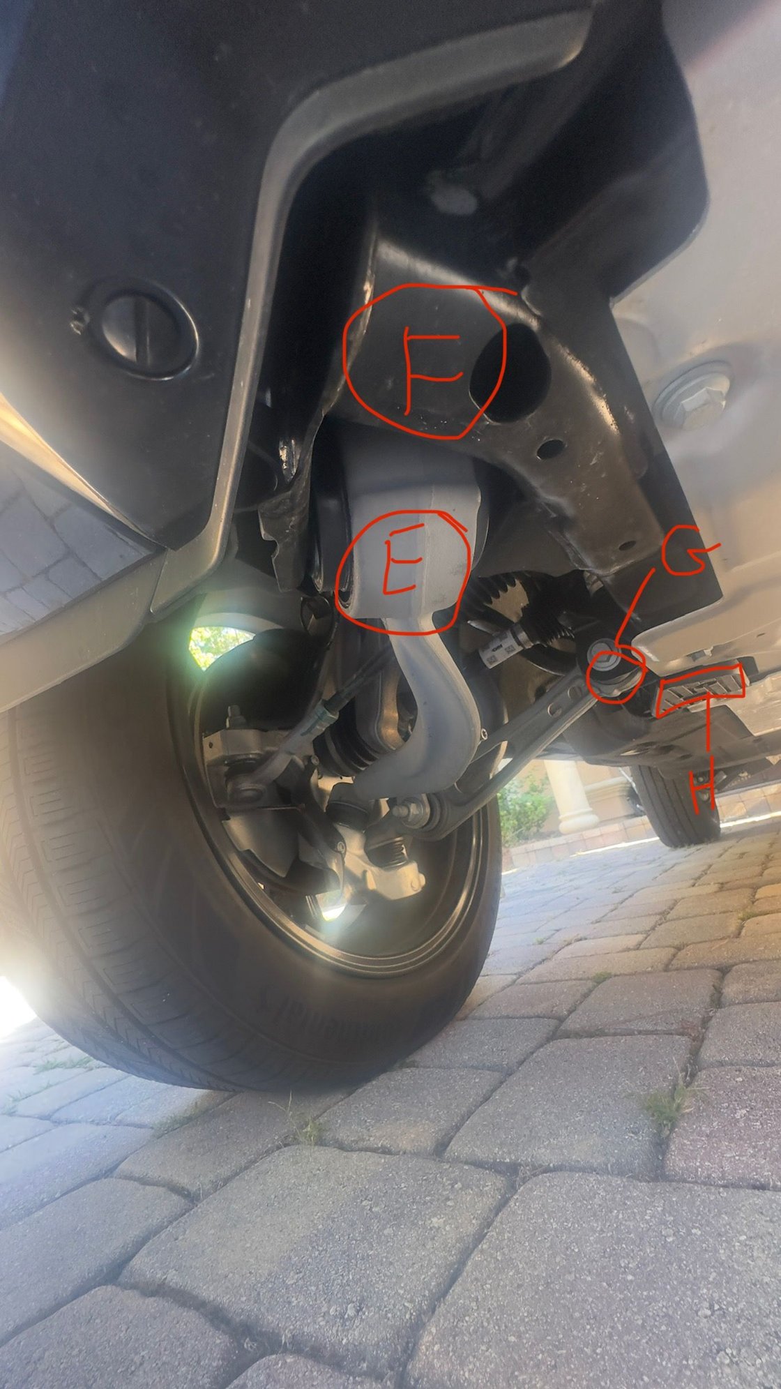

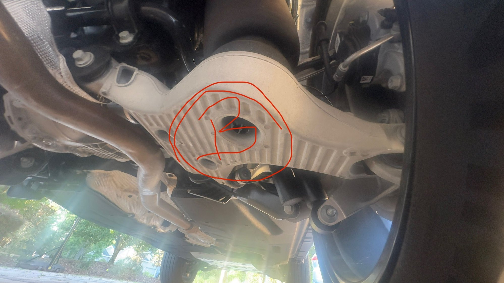

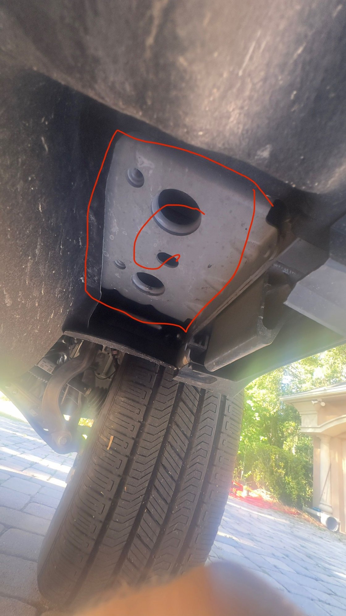

I know the diagrams for recommended jack points (pinch welds), but am exploring other safe options. I need to jack one wheel at a time and then place jack stand. Please forgive my ignorance.
I have taken photos and labeled them, please let me know which are safe jack points.
Sorry they are a bit out of order.
Point B- rear wheel
Point B- rear wheel
Point C- front wheel, next to pinch weld
Front wheel points
Front wheel points
Front wheel
Front wheel
Front wheel
Front wheel
Point A and Point B
Point A and Point B- rear wheel

I know "H" is good:
https://www.lrdefender.org/prelimina...cking-332.html
Old Jun 1, 2025 | 02:51 PM
TeddyG's Avatar
Joined: Jan 2023
Posts: 416
Likes: 140
From: North of Toronto
I use H and A

Definitely not “D” !

Yeah! DEFINITELY not D. I would even add A to the potential nope list. Most of the others I would likely try with a floor jack. Perhaps not with a bottle jack on the first attempt. I don't know why, maybe because mine has a bigger lift surface.
My only (strong) advice, is to use whichever of those points you decide best. Regardless, as soon as I had it lifted, I would slide in a couple jack stands in there. One at the "proper" lift location and another at any letter you don't use. Then I would take the wheel off with reckless abandon. Ymmv. Oh, and if not obvious, I always chock an unlifted wheel. Likely not necessary, but I'm an old school shadetree mechanic.
EDIT: Just reread your OP, you're already way ahead of me re: the Jack stand. Leaving the original reply in case someone else misses that.

Thanks for all the replies… so far what I’m getting is not D, everything else may be ok. 🤙🏻🙏🏻🙏🏻🙏🏻
