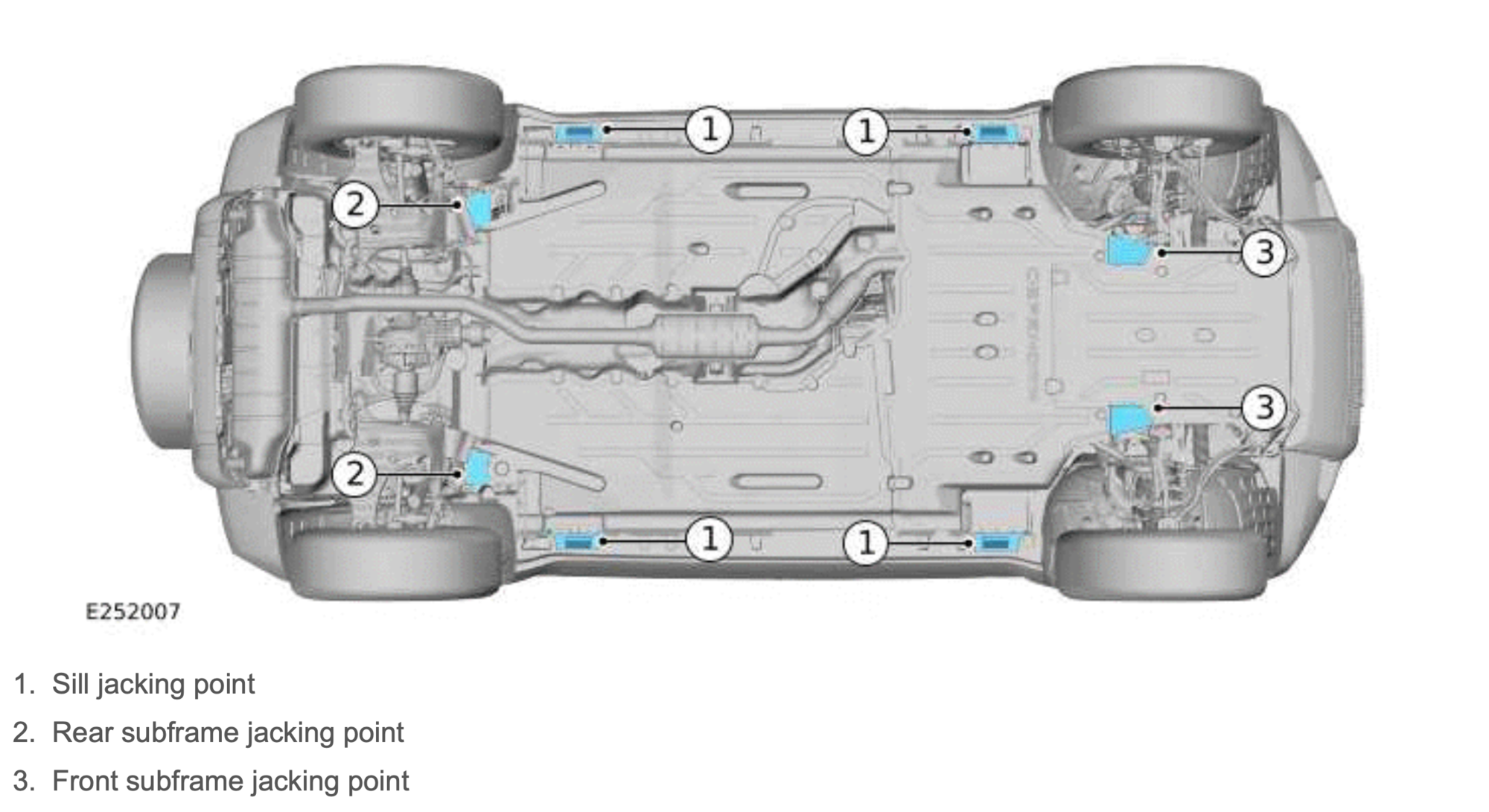

This LR resource may be helpful:
LR L663 Jacking Instructions
From that document:

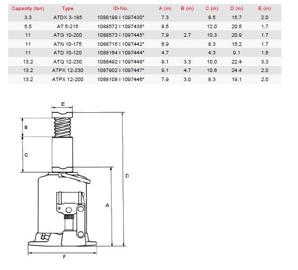

Does anyone know the specs for the max height and the lift range of the Sprinter Van Weber-Hydraulik bottle jack? The sprinter van appear to be the AT 3-325, AT 3-223, or AT 3,3... different vendors show different models.The Webr-Hydraulik website lists specs for their bottle jacks, but it does not include these models.

Found this on a Mercedes forum... the OEM Sprinter jack (Weber Hydraulik) is a two stage jack with a minimum height of 10 inches, with both stages extended is 23 inches.

Here is a summary of these Weber-Hydraulik jacks:
they look more interesting than most stuff from China...
