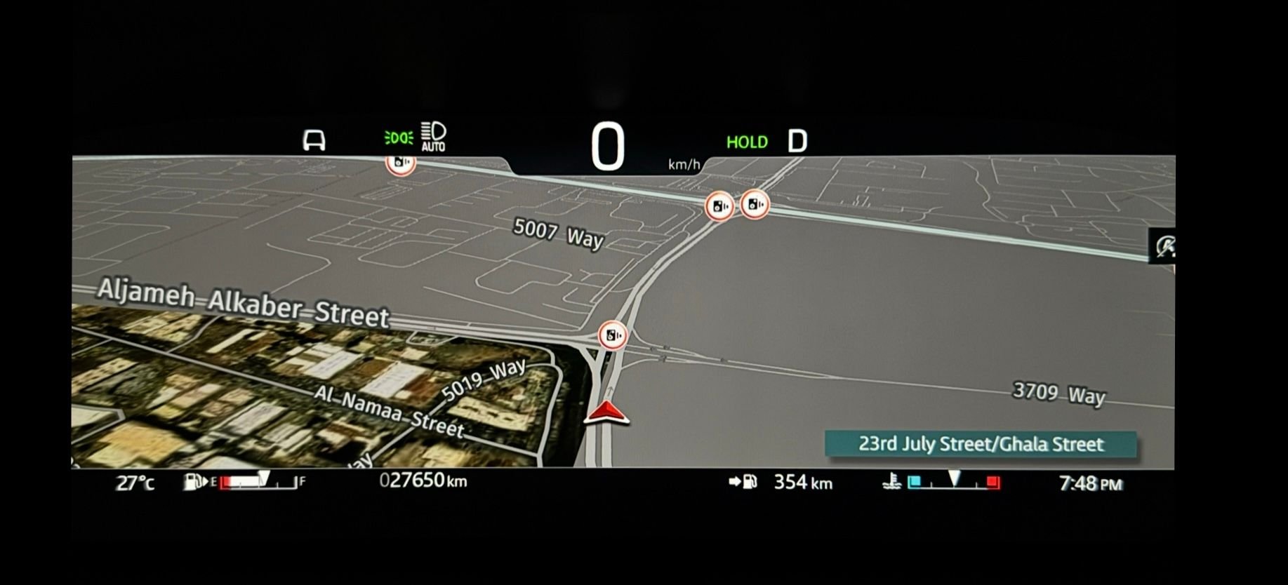

Hi Everyone,
I recently dropped off my Defender 130 YM2024 at the dealer after a year of ownership to address a few issues. One particularly frustrating problem is that my satellite navigation maps randomly disappear while I'm driving until they're completely gone with only the base -gray- layer remaining. I'm currently on 4.2.1 Pivi Pro update, and a system reset didn’t resolve it.
A rather strange behavior occurs when I try to eject the SIM card from the vehicle: the maps briefly reappear, only to disappear again. Furthermore, I’m no longer receiving traffic updates on the satellite maps, even though my SIM card data is still functioning.
The dealer mentioned that satellite navigation maps are linked to the InControl system, which my vehicle lacks due to regional restrictions. However, I’ve had fully functioning maps for well over a year, so that explanation doesn’t quite make sense to me.
Has anyone experienced a similar issue? Any thoughts on what might have caused this problem?

Originally Posted by Mouta
Even though the maps are disappearing, the GPS function still accurately tracks my direction of travel. I’ll have it checked nonetheless.
Looking at the pic of your IP display, I see that the bottom left portion of the nav map is loaded, with detail, while the other 3/4 of the map is greyed out. You report it as randomly occurring; how often does it occur, and does it eventually load? Or is that the way it remains until a reboot or engine shutdown and restart? I ask, because from personal experience, I’ve had iPhones and iPads that occasionally partially load a map, whether I’m in Waze, or Google Maps And sometimes if I’m patient and wait it out it will eventually load fully, or I’ll just quit the app and restart. Those I just view as system hiccups, but if your problem is consistent, frequent and not self resolving, then it does need some attention. I agree with antenna suggestion.
Very frequent, and it does not load back. Remains greyed out!
Restarting Pivi seems to have no effect on it reloading or going back normal.

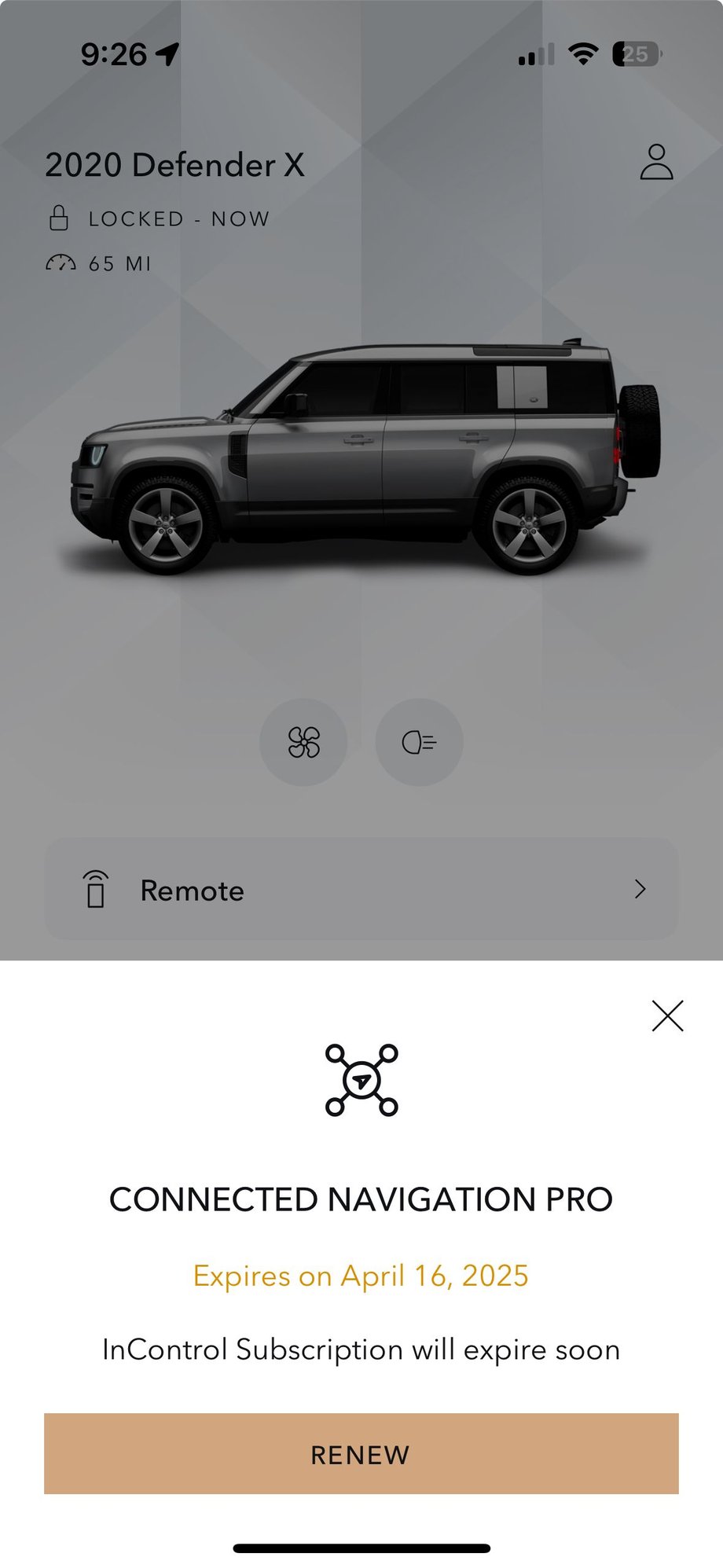

If it will help you test this once and for all -- It’s April 14th and ... my connected Navigation Pro subscription expires in 2 days on April 16 (See image below. I do not plan on renewing it. Let’s see if my satellite features on the maps disappear. I’ll report back end of week.
