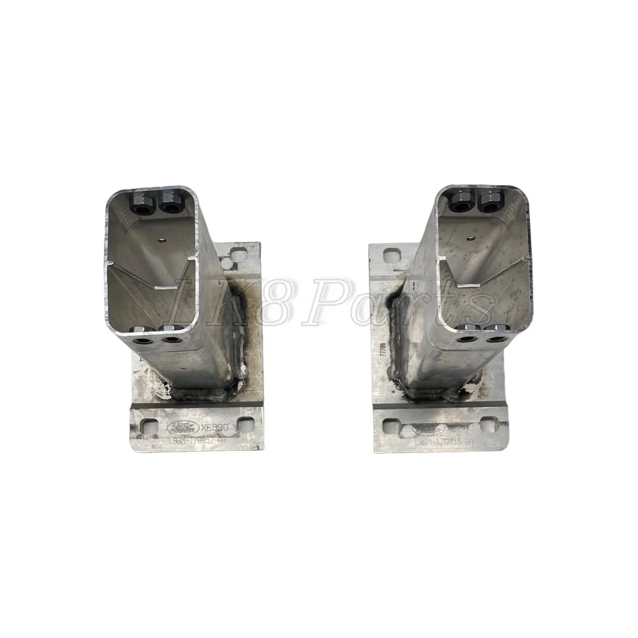

Yep OEM mount also includes "crush cans" that are intended to behave the same way the crash bar does in terms of absorbing the energy of a frontal impact.
https://lucky8llc.com/products/front...uVKcpH5Eb_Zzry

I got mine from Land Rover OEM parts (https://landrover.oempartsonline.com/). They are my go to place for parts and usually have the best price. I just checked and the whole setup (sans the OEM harness - which isn't needed if you go the isolator route - and the actual winch, which I got on sale from another place) meant ordering three different parts:
VPLEP0490 Mounting Bracket
VPLEP0431 Crush Cans
VPLEP0428 Protection Bar
