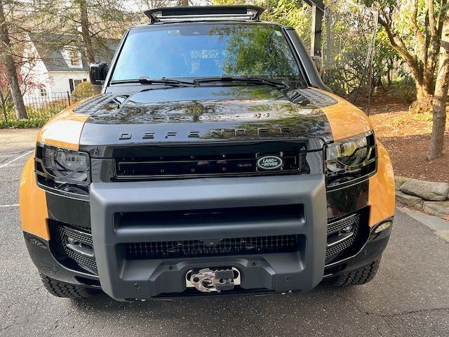

No they're different. The protection bar I referenced is specifically for the winch kit, where as the A frame protection bar (https://accessories.landrover.com/us...ection-bar-90/) is for cars without the winch kit. My car originally had the A frame protection bar and I replaced it when I installed the winch kit. The final look is fairly similar.
It looks like at some point the A Frame Protection Bar was changed - I have one on my Trophy Edition along with the winch.

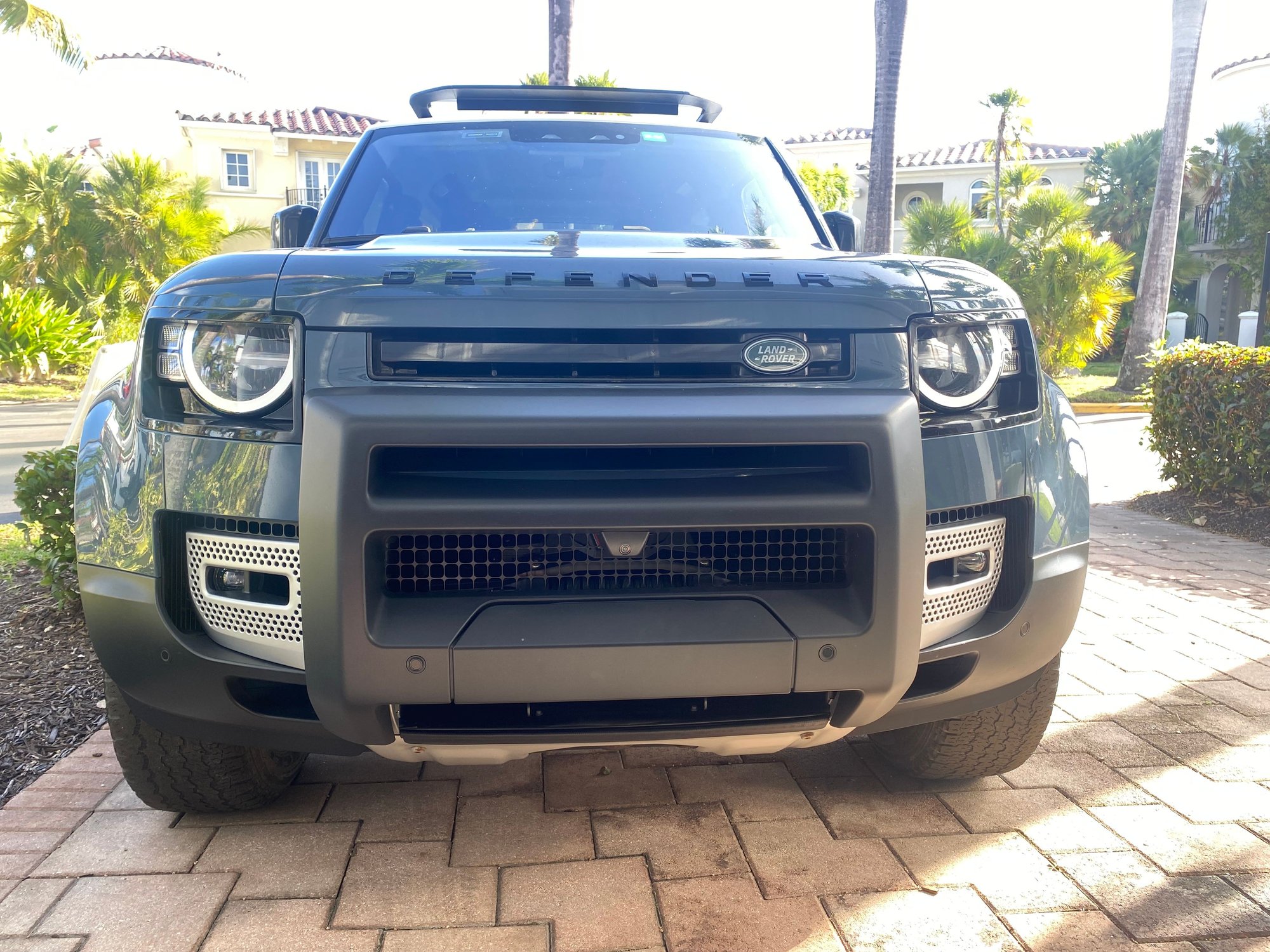

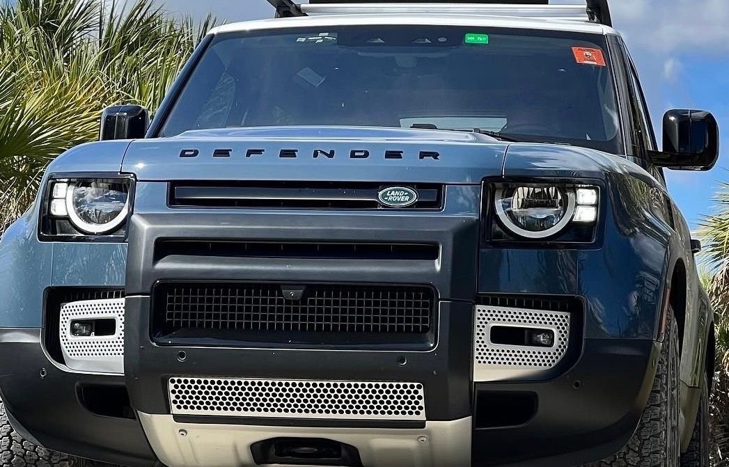

I have had both and they look similar, but “behind the scenes” are different.
A Bar (No winch)
A Bar (No winch)
OEM winch mount cover
