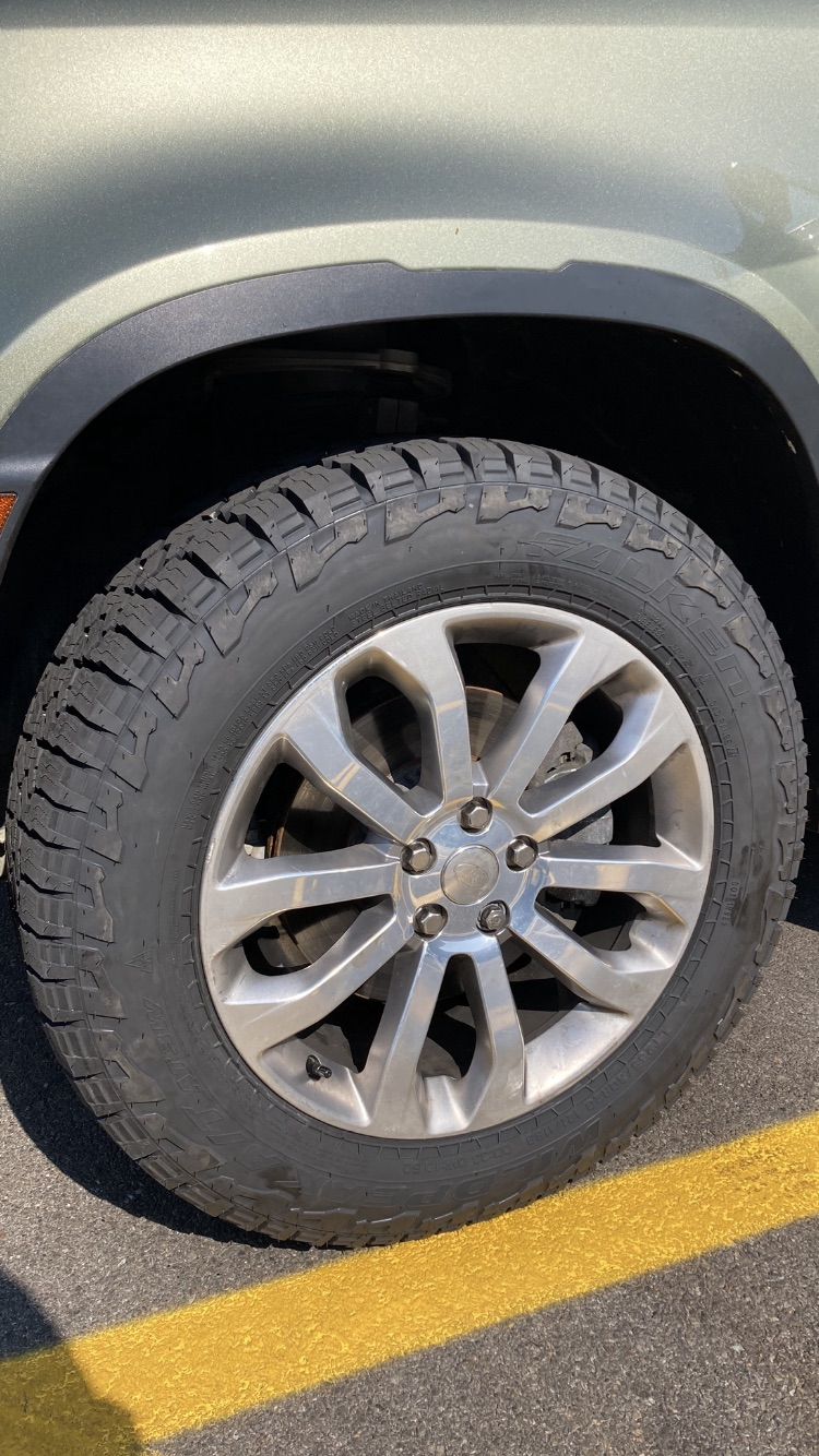

I am also running Wildpeaks. What size are you running? I’m on LT265/60R20 on Style 516 wheels from an LR4 XXV edition. I think I have the only Defender on the planet with these wheels. They have a different offset than the stock wheels, but as you can see in the picture below, it barely misses the knuckle.

I am also running Wildpeaks. What size are you running? I’m on LT265/60R19 on Style 516 wheels from an LR4 XXV edition. I think I have the only Defender on the planet with these wheels. They have a different offset than the stock wheels, but as you can see in the picture below, it barely misses the knuckle.
Exact same tire size. I am on OEM stock 19" six spoke black rims 6018 maybe?
They make less road noise as well. Perelli is standard without offroad tires. These 60 series tires are slughtly smaller of course. If you are strictly offroad you probably want more sidewall...

I just realized I misspoke - I am on LT265/60R20s, not LT265/60R19s. I have updated my original post.
I've been on some pretty tough terrain and I haven't had any issues with the slightly smaller sidewall compared to the OEM 255/65R19s on Style 6009 rims that I originally specced with the car.
