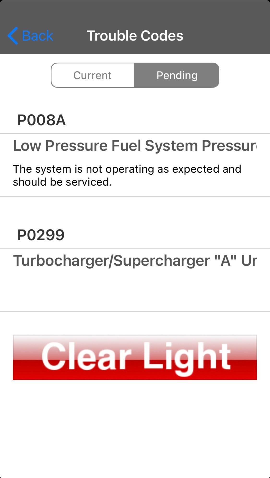

Originally Posted by Juancl
Still waiting, though apparently they have found a service. Meanwhile, I used my handy BT code reader and here is what I found:
Sounds like HPFP (fuel pump)?
Hope you got to safety and get the rig fixed quickly.
