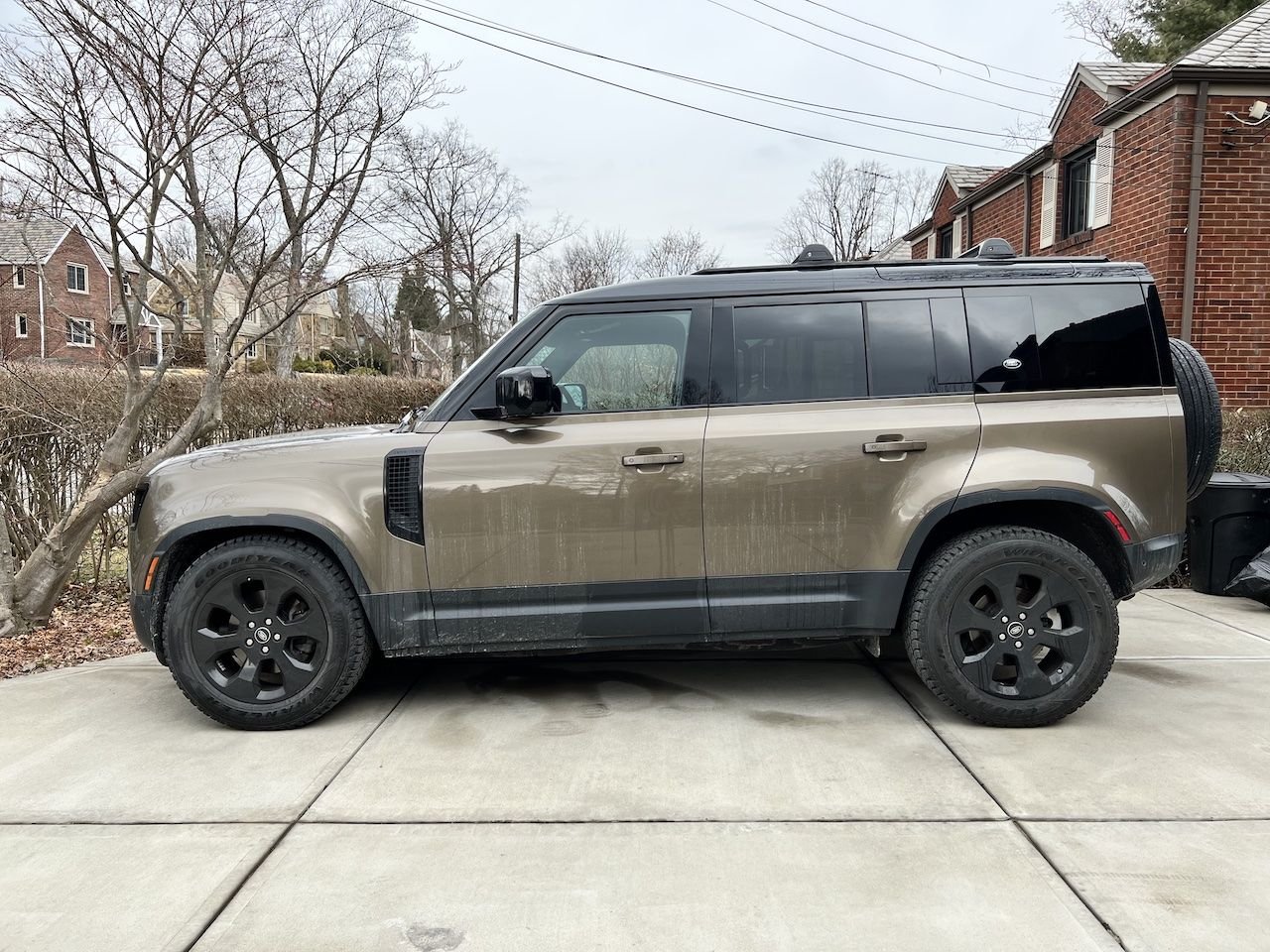

Sorry, I'm completely new to all of this. I'm just wondering if it's supposed to look like this - the front end looks lower than the rear? I have the setting so it's the default/lower height. Normal or something wrong? or is there a setting that would fix... ? thanks.

Looks like you are hung under that tree? Back up and it should go back to normal. It will buff out most likely!
All kidding aside, no that does not look normal to me. Should be even at any height, does it do that every time you park or just this once?

The only thing I could guess at is that you turned the car off before it fully lowered? Get in it and fire it up, press the lower button and see if the rear comes down. Then test it at ride and off road heights. I bet it clears on its own.
Make sure you are not stuck under that tree first

Definite problemmo here.
Take this pic and the car to dealer (in 3 mos when they have an appt hahaha!)
I bet an air leak somewhere up front is letting the front down after being parked. Was it parked in this spot for awhile before you noticed it?

You sir! Are ready for front air strut replacements! This happened to a lot of cars if you notice the front sagging like this or it correcting itself at stoplights a lot that is most likey what is happening. Pretty quick job and is covered under warranty.

Is the driveway sloped? Front left may be flexed up more than rear left. Just throwing it out there before you head to dealer with all the fun that entails.

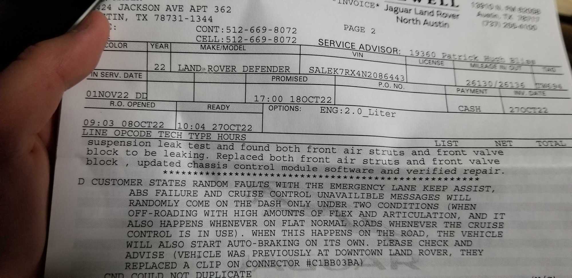

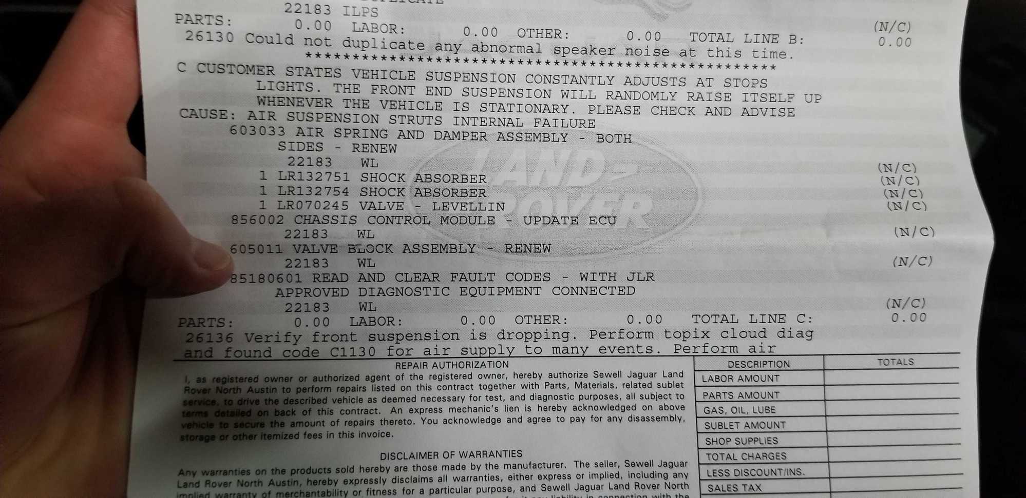

Here is what was done for this by my dealer. It would randomly raise at lights and when camping each morning it would be sagging like your picture and raise when I started it. If you get in your car when its parked like that and the front raises that's most likely the issue.
