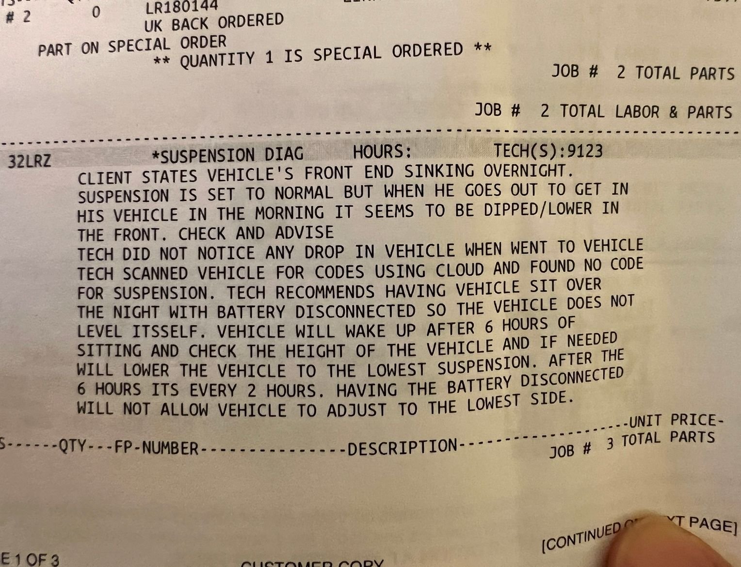

Here’s their solution… will have to try some time.

OMG, I can’t believe whoever wrote that actually thought that was a viable solution.

run from this dealer!

How cold is it at night where it's parked? What's the temperature drop between day and night?
Just something to consider.

but it didn't even level to the lowest corner!

Did you ever manage to get this fixed?

yes. After another visit (or two - can’t remember). They finally accepted there was an issue. And they ended up replacing struts under warranty.

UPDATE: over a year later. front end still sags. not as much as in the original picture. It has been in service for a few days where they said they fixed a leak near the compressor... and yet... it lost over 1/2 inch last night - just the front.

this sucks.
not at all surprising level of care and competence from a dealership.
mirrors my experience
abysmal LR level of service. Seems the norm

It is sad some dealerships lack qualified competent techs. I would try taking it to another dealer. Techs nowadays go with the least resistant path and all they do is throw parts at a problem-unfortunately.
