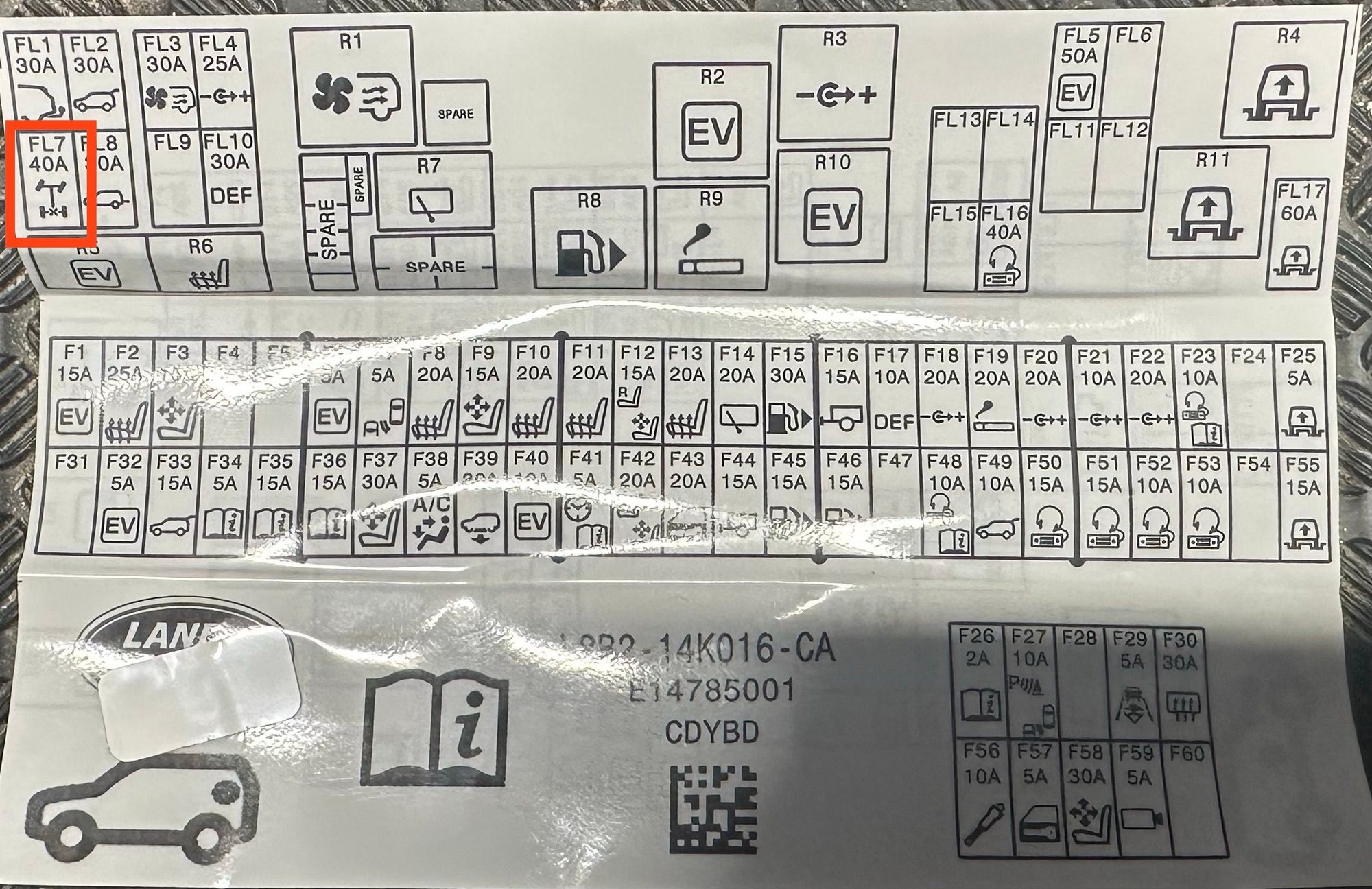

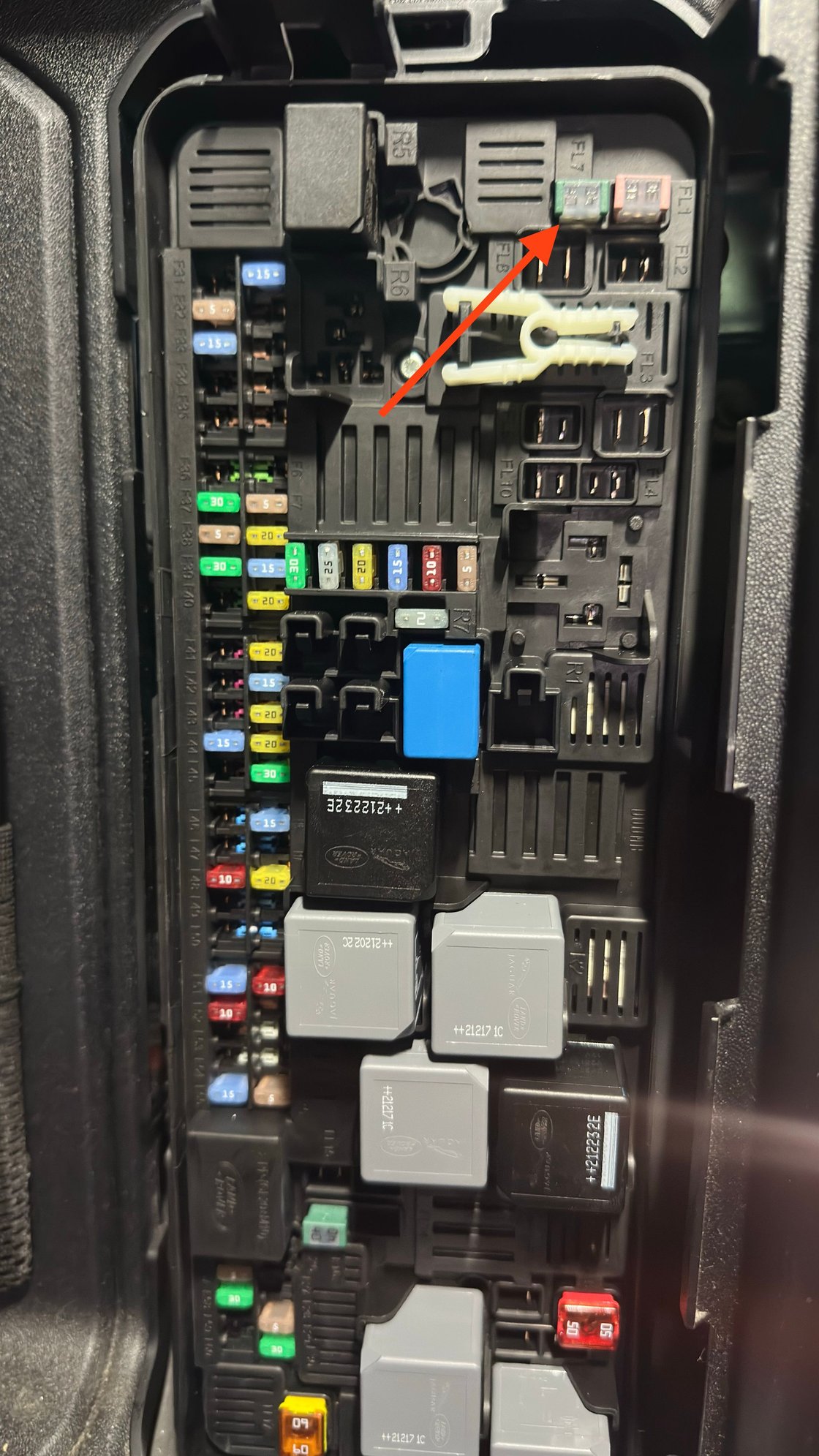

I found the location of the fuse — it's in the rear, on the right-hand side.
After removing it, the noise disappeared. I verified the error using the GAP IID tool with the fuse removed. When I reinstalled the fuse, the noise returned.
I performed a double flush of the differential, but the noise remains. I'll try using an additive, but I suspect the differential may need to be repaired or replaced.
The car is a P400e, which has a 4.1:1 gear ratio — not the most common one, as it's only found on the 2.0L petrol engines.

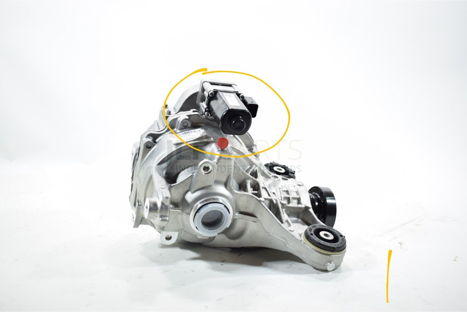

So you've figured out it is in the electronics.
On top of the diff is an actuator//motor, that's the first I would check.
