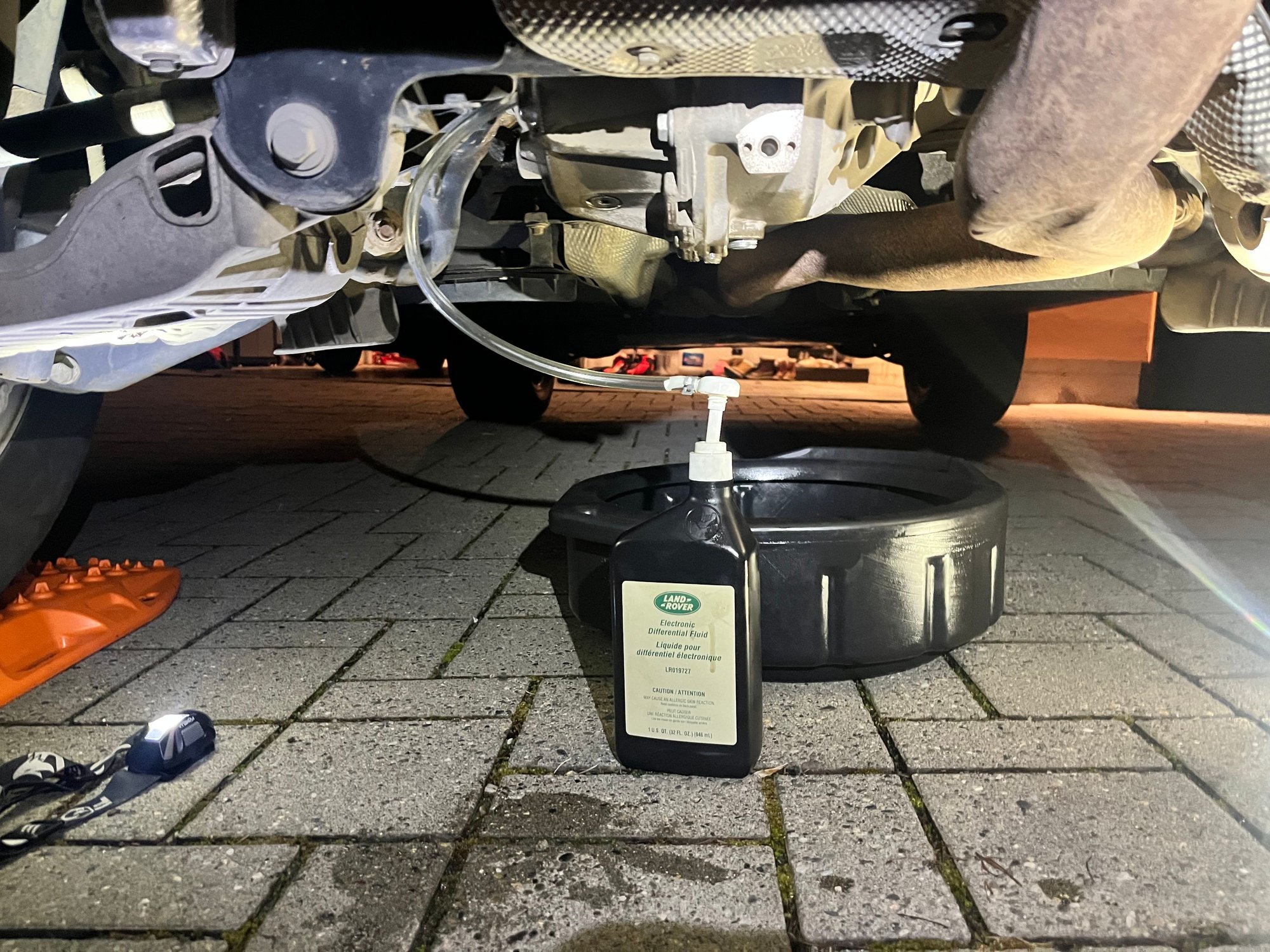

I recently did my second rear differential service. 25000 miles or so since the last one.
Oil was markedly clearer looking than the first service at twice that mileage.
clunk free
