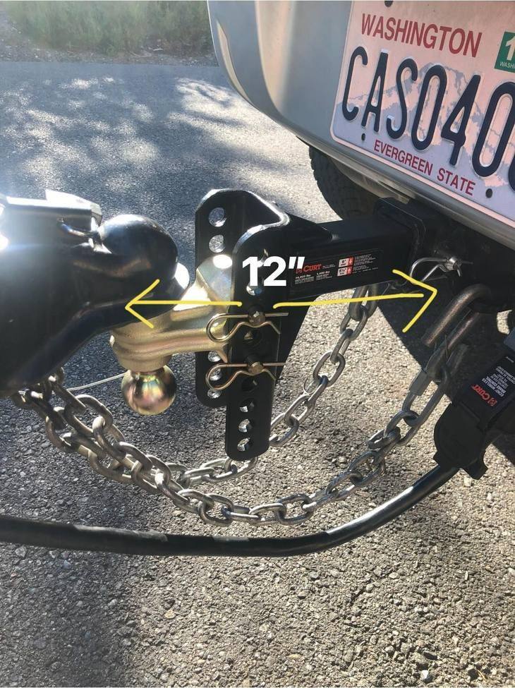

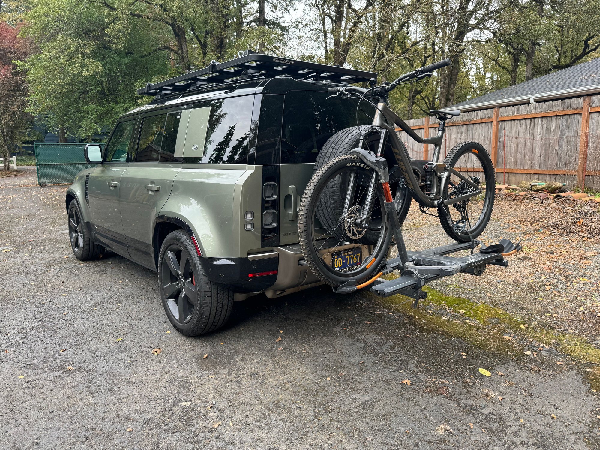

Kuat Hi Lo Pro
https://landroverforums.com/forum/20...e8/#post796498
For towing do not use hitch extender.
Use a hitch that is long enough to meet your needs. I use a Curt variable drop hitch. 11" or 12" pin to ball distance. 12" works perfectly for all trailers I've towed so far. Yes it's longer than the factory limits of 6.9" so will limit your tongue weight a little but needs must.
CURT 45900 about $100

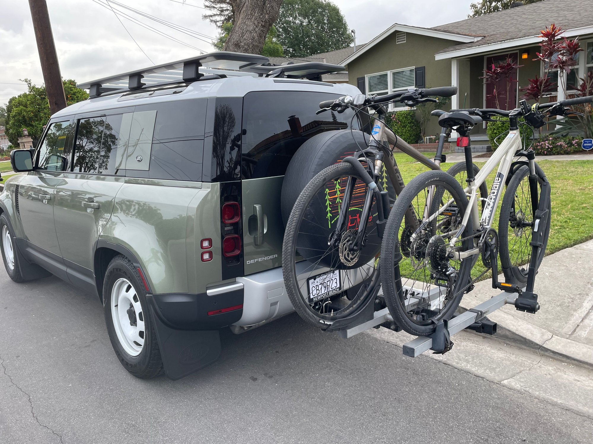

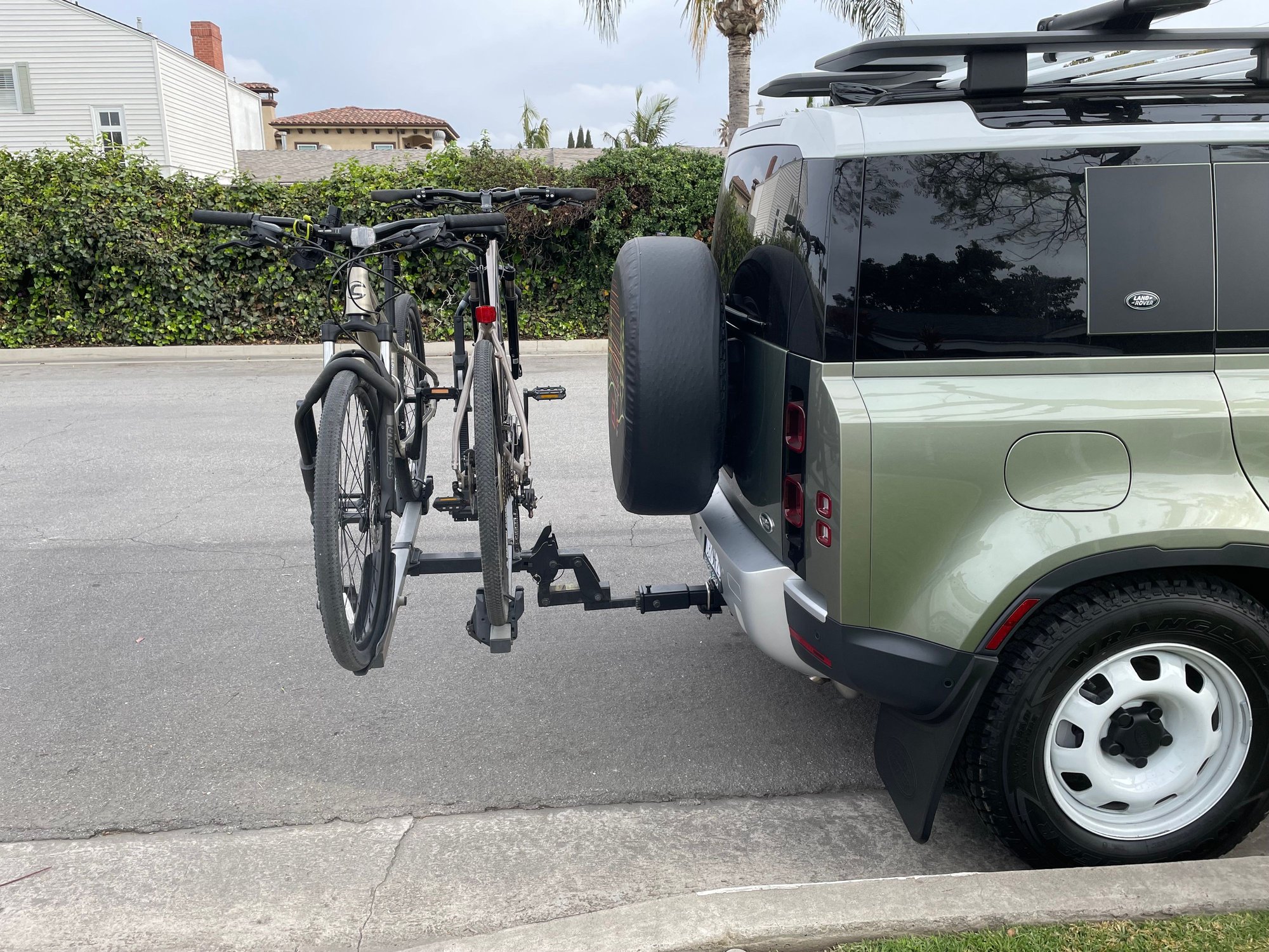

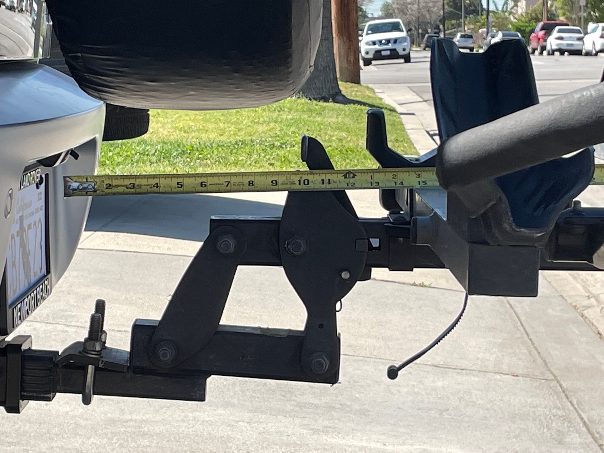

I had the same issue. Solution was 8.5” extender https://a.co/d/483YLE5
Here are before and after pictures.
I measured the distance with the rack in place. (The bikes could not be mounted on the rack due to the spare). I selected a 8.5” extender based on the width of the bike so the peddles cleared the  spare.

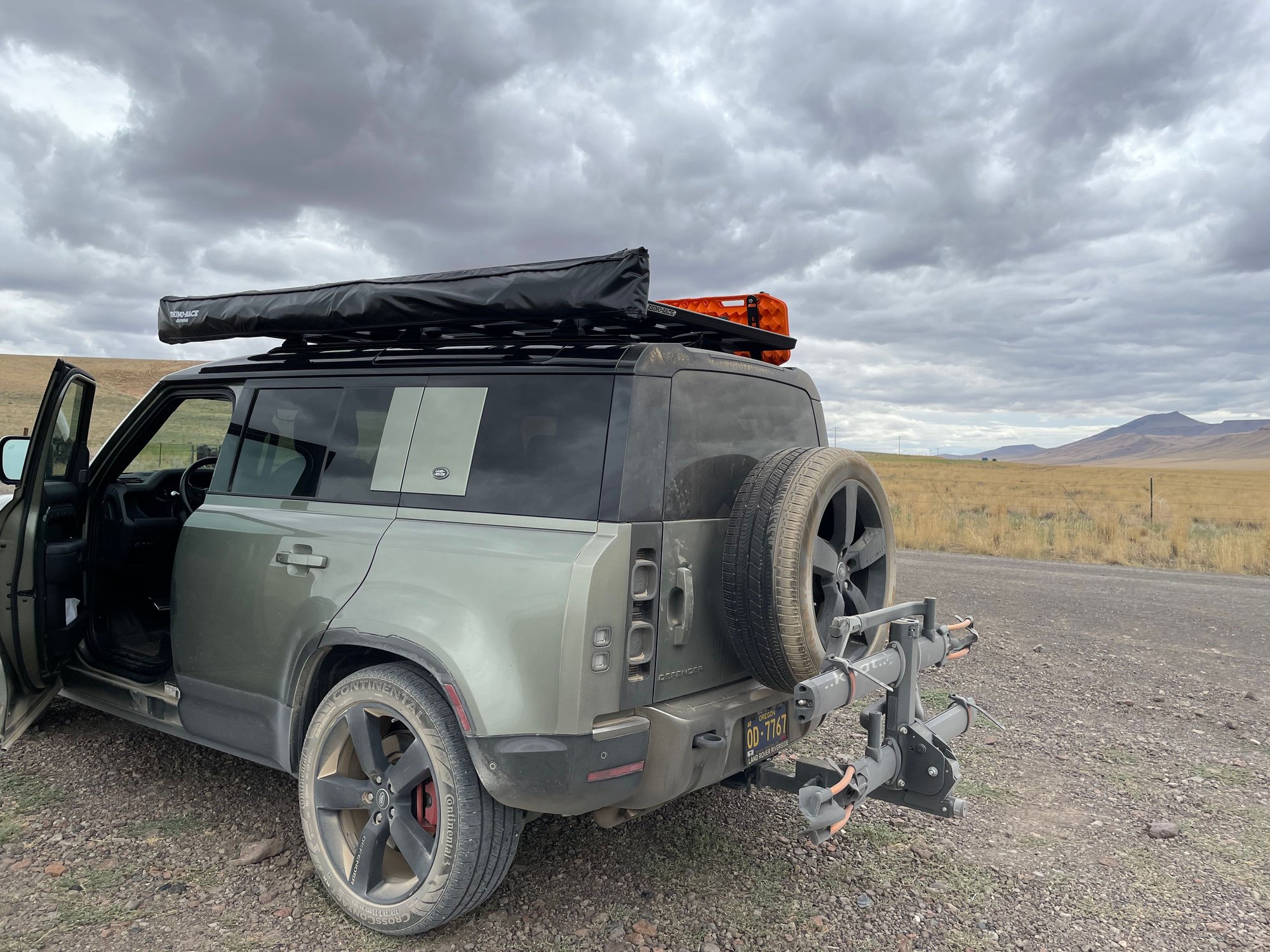

Another Kuat HiLo pro user here. Has a cam inside to clamp to the hitch and has no rattles what so ever. When the bike rack is folded up it's nested close to the spare tire without sticking too far out.
