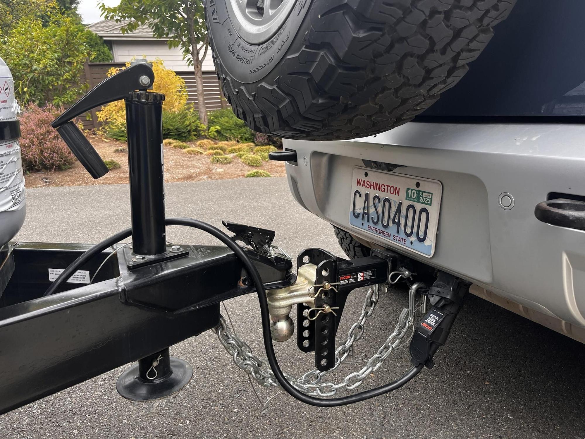

This is a common setup with rated s hooks

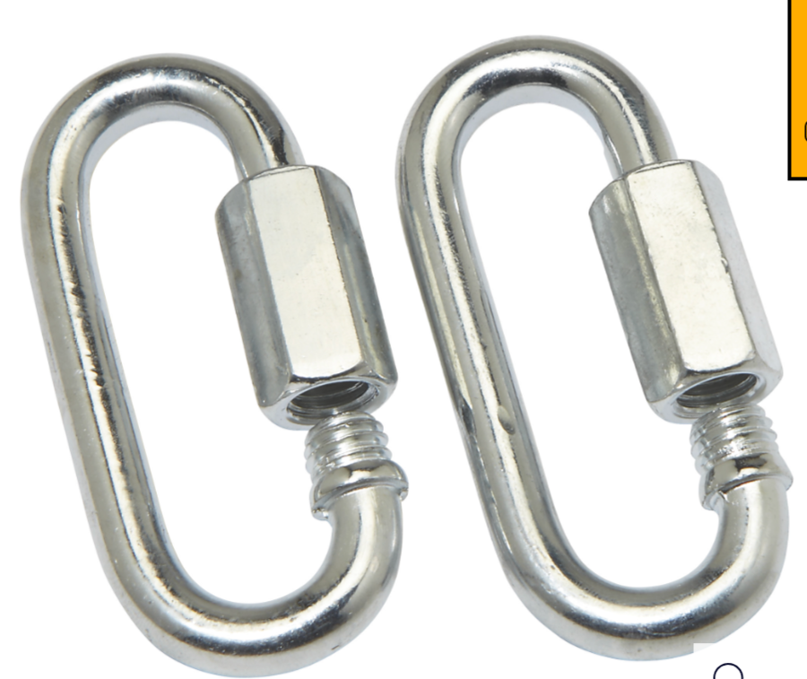

Had the same problem. Here's another solution. I now keep two of them with me in the vehicle.
The U-Haul guy in Missoula actually gave them to me to keep after a rental.

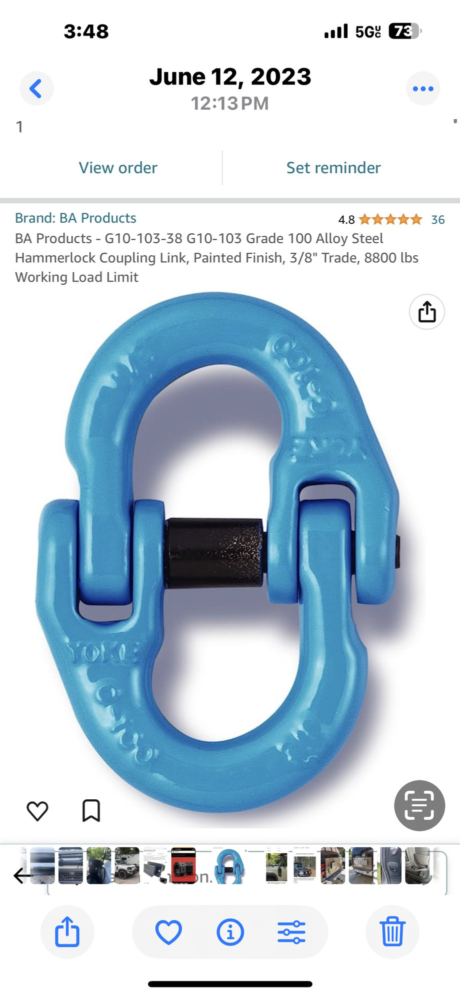

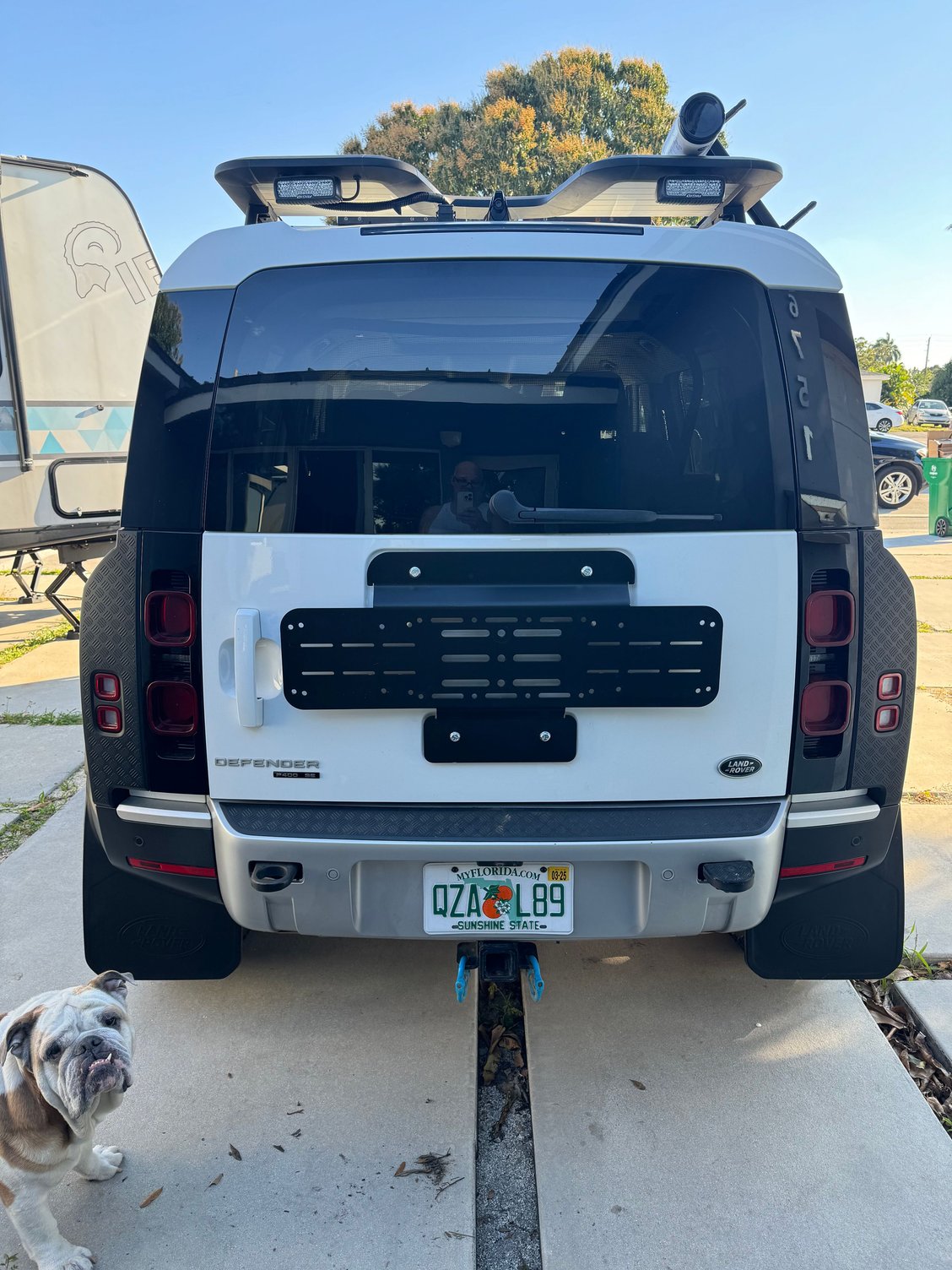

I use hammer locks rated at 8k.

Great idea @DefenderSISU . Why did you go with the 3/8" version? When I searched for Hammerlocks I see that they come in many sizes: 3/8, 1/2, 5/8. Was that the only size that fit or were they rated for what you wanted to do? Do you know if the larger sizes would fit? Thanks.

Hammer locks: 3 times the price of a similarly rated S-hook with all the fun of additional complexity.
I must be missing something.
