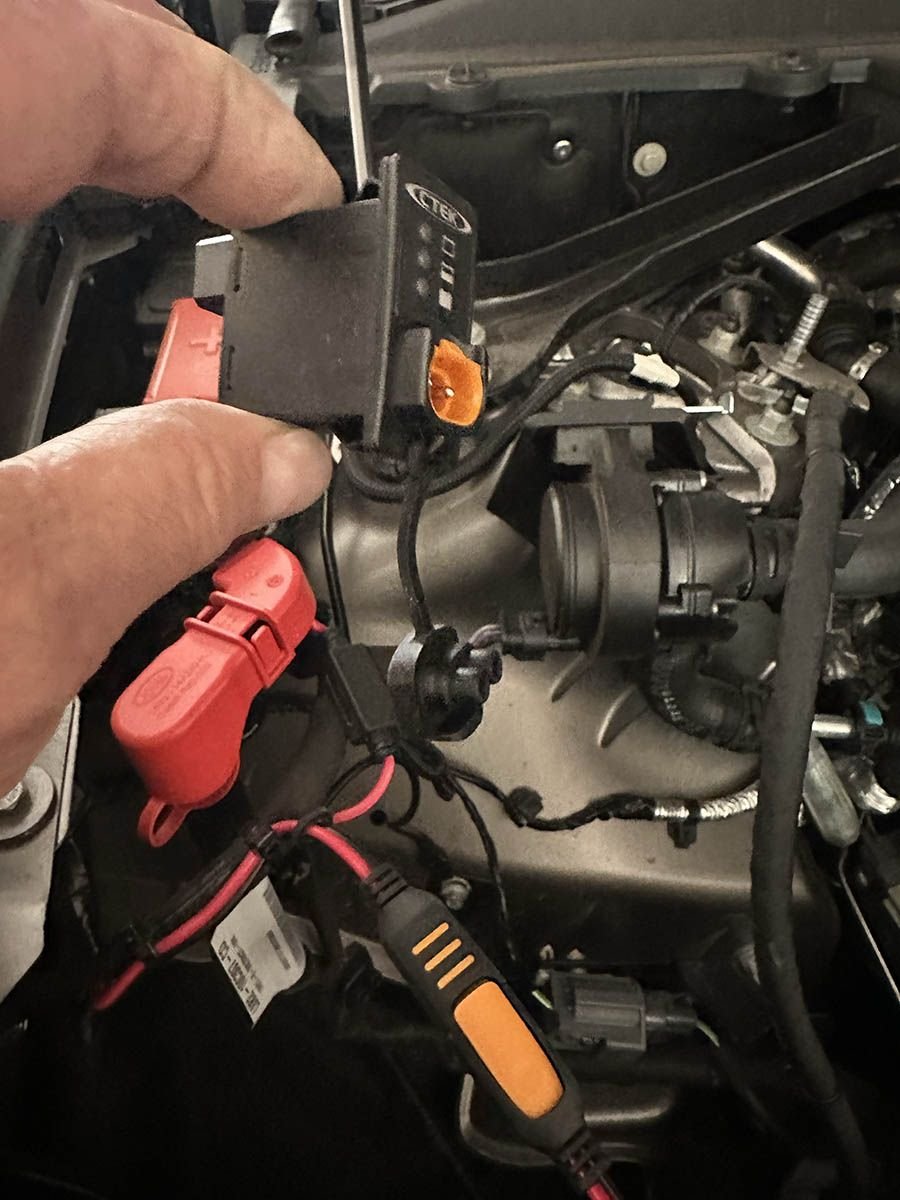

I use the CTEK Charger, same as the Land Rover one, but without the logo and price tag. They have an extension that goes to their charger for an extra $10 or so to give you 6 more feet. I have the permanent supplied hook-up connected to the jump start point. So I just plug into that and then close the hood. Now I also got, recently another plug point that works with their connector system. I may run that to someplace I can access without opening the hood. It also shows the state of the battery in LED's.
I was using my 30 watt flexible panel to keep the car topped up in the field. But then I remembered I have these two super small tough ex-military panels I use for the 24V airplane as well. They are easier to put up on the dash behind the sunshield and then plug to the OBD port (always hot). I just had to put the 12V charge controller on it instead of the 24V one. Rather stupid one has to do this work around to the not having a camping mode implemented in the car from the factory.

Yes, I agree. Unless you're like @Dogpilot that is out bush a lot and the drain on the battery is high, due to it not having a camping mode. Thanks for the photos, this is exactly what I am thinking of doing. Although @PowerfulUK latest reprogramming is a step in the right direction. Our Defender is not going to be our daily drive, so I'm thinking of putting it on a trickle.
