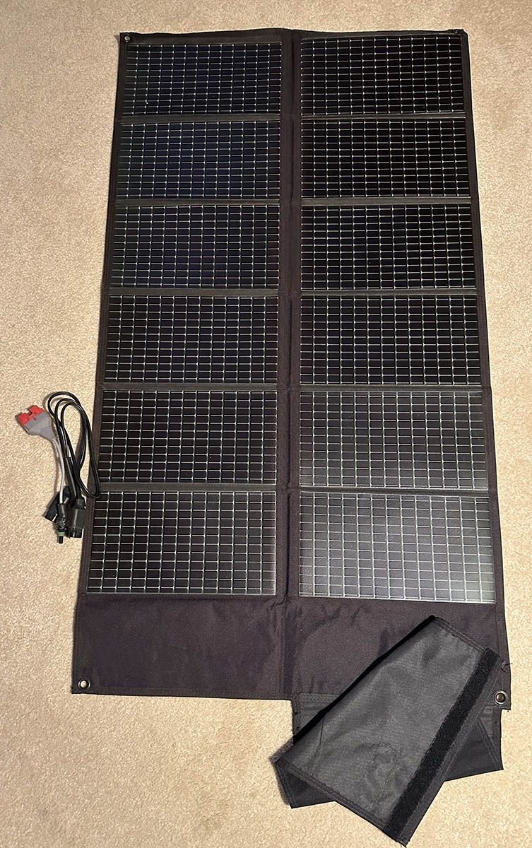

Personally, I use the CTEK charger. This is the very same one Land Rover sells, with their label on it, but without the associated wallet drain.
CTEK MXS CTEK MXS
I also for when in the field have this excellent very flexible, foldable 30 watt Powerfilm Solar Panel. I place it in the windshield and then place the regular windshield panel thing that came with the Defender behind that to hold it in place. It is in turn coupled to the OBD plug I adapted to trickle charge from and plug it into the OBD port under the Driver's side. It is always hot, so it can be trickle charged from there. Yes the Defender draws around 10 amps for 10 minutes when you open the door. So when in the field for days this can become an issue. Too bad there is no "Camping Mode" selection from the many menus. So kind of why I resurrected this panel and pressed it into this service. I have been through two batteries so far in a year. The latest one seems healthy enough. Also if you use ECO mode a lot, it does not put out full charging, or so it seems.
