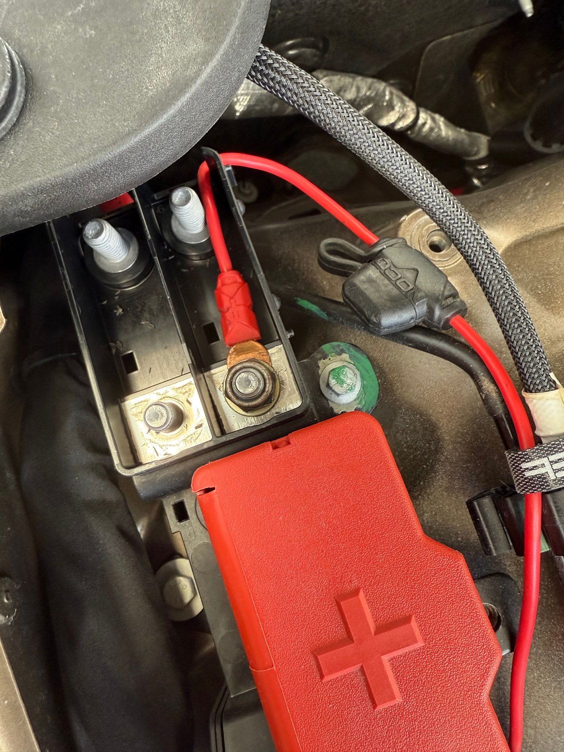

Under hood battery tender connectors.

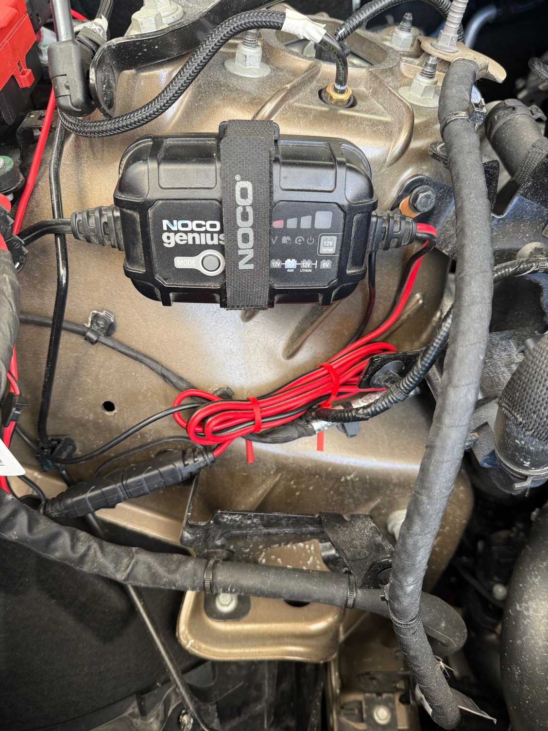

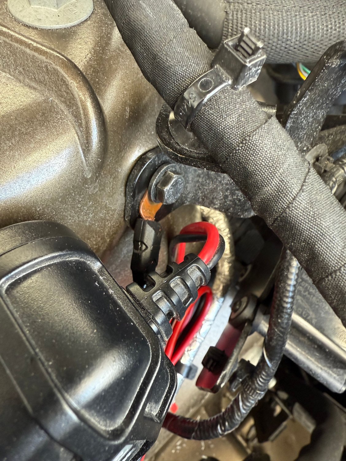

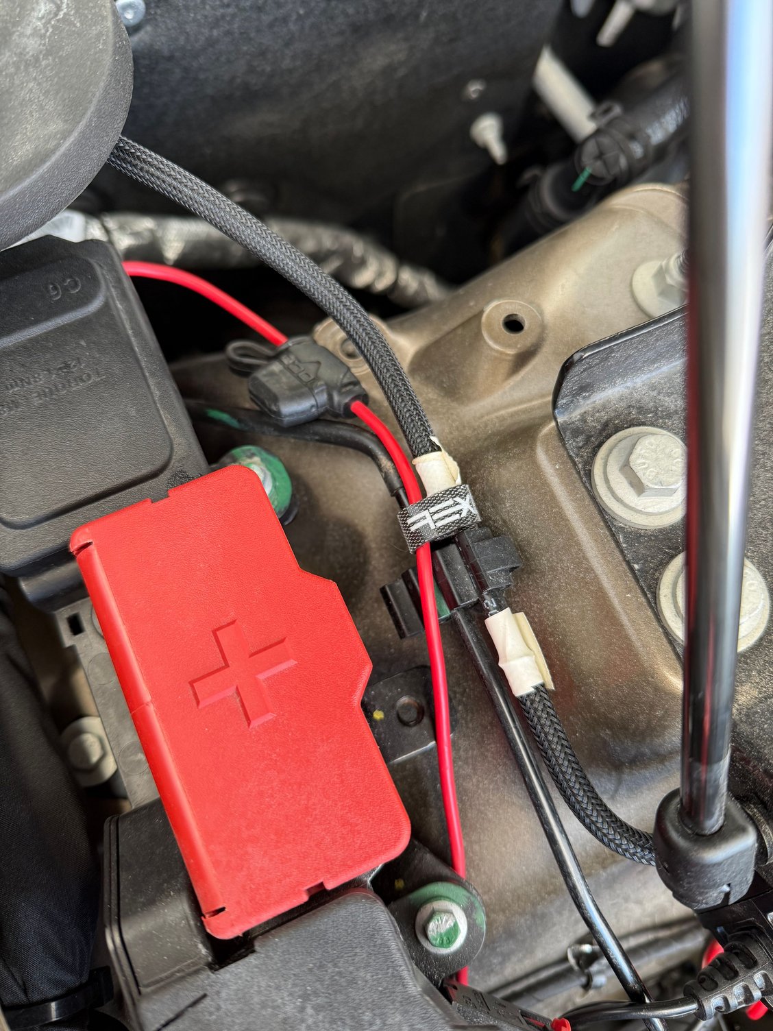

Originally Posted by GavinC
I think it's M8. Can't recall. I'm almost certain it's M8. I have a selection on hand
It's M8 1.25. I've got both in use. 1/ 450A fuse for the winch. 2/ 100A fuse for a Batamx for lights.
Old Mar 11, 2025 | 11:40 AM
isugoo's Avatar
Joined: Feb 2025
Posts: 246
Likes: 117
Thanks for the info! 1.25 part is the one I struggled with. When I went to home depot (not so electrically savvy), I see M8x1.0, 1.25 and 1.5. Had no idea which one to get.
And for the ground wire, is that the one on the right side of black box you connected and uses same M8x1.25?
Old Mar 12, 2025 | 12:21 AM
GavinC's Avatar
Joined: May 2021
Posts: 2,574
Likes: 3,652
From: Kirkland WA
that’s an M6. 1.0 pitch .
Old Mar 12, 2025 | 07:03 AM
Darover2's Avatar
Joined: May 2023
Posts: 117
Likes: 56
Thank you all, I proceeded with the install today.
