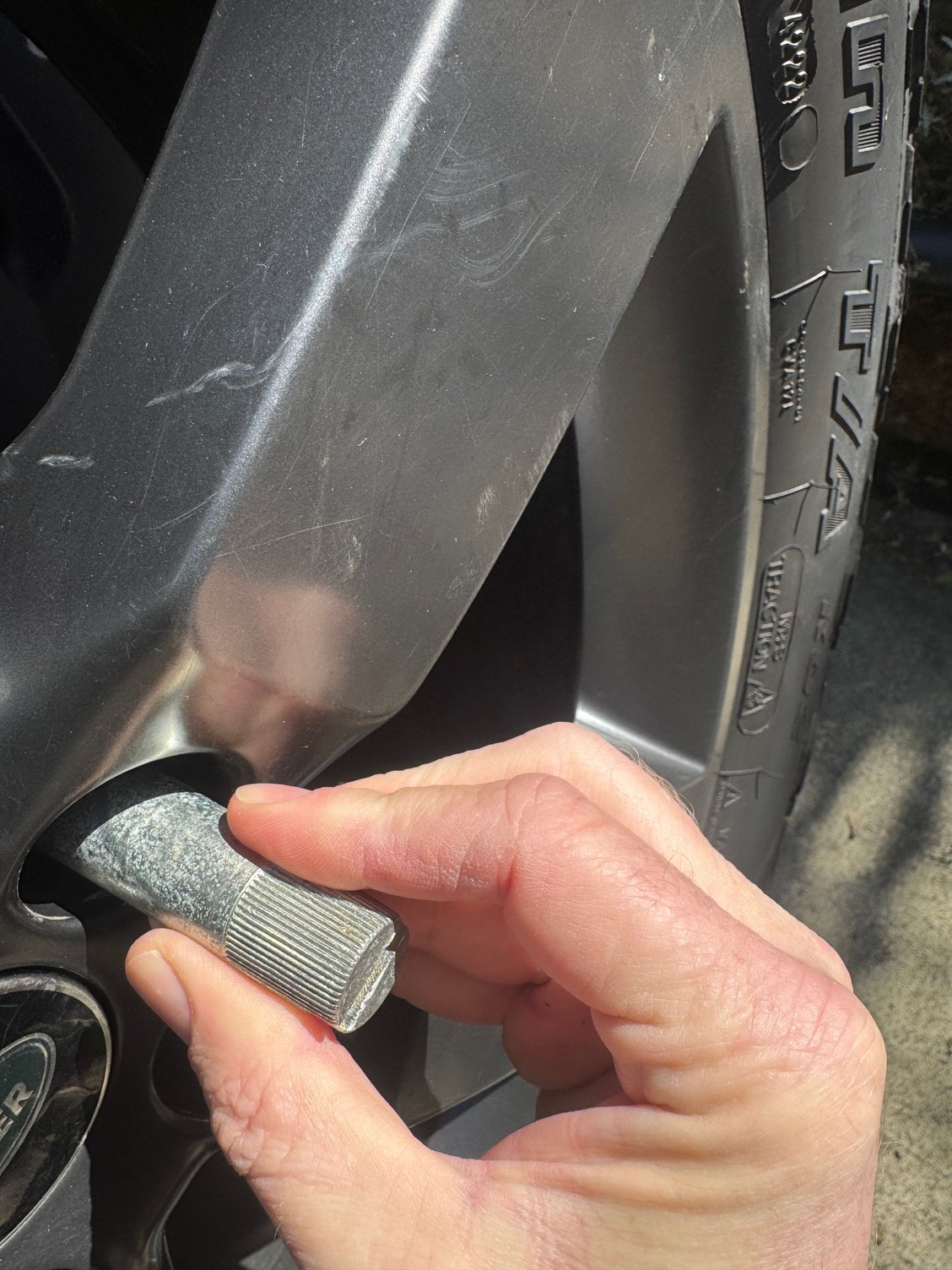

I’ll be darned if I didn’t just discover this same problem and had a go of it.
Changed out my spare wheel again and my back wasn’t having me lifting the tire and getting the lug nut threaded on. I thought “aha - there is a tool for this”. Well - no.

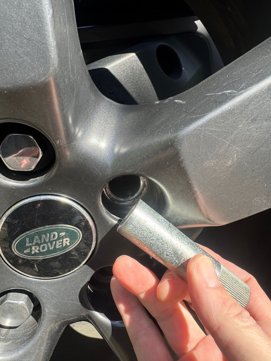

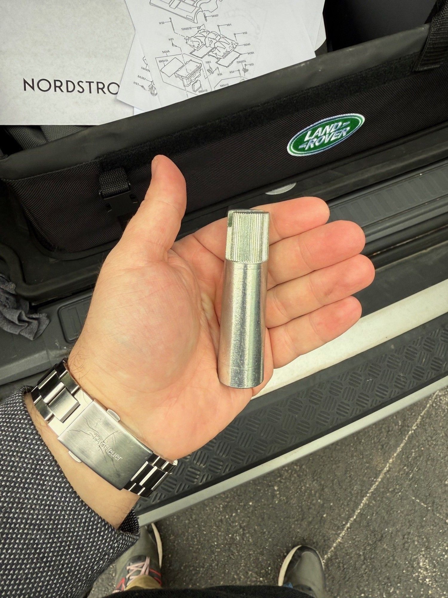

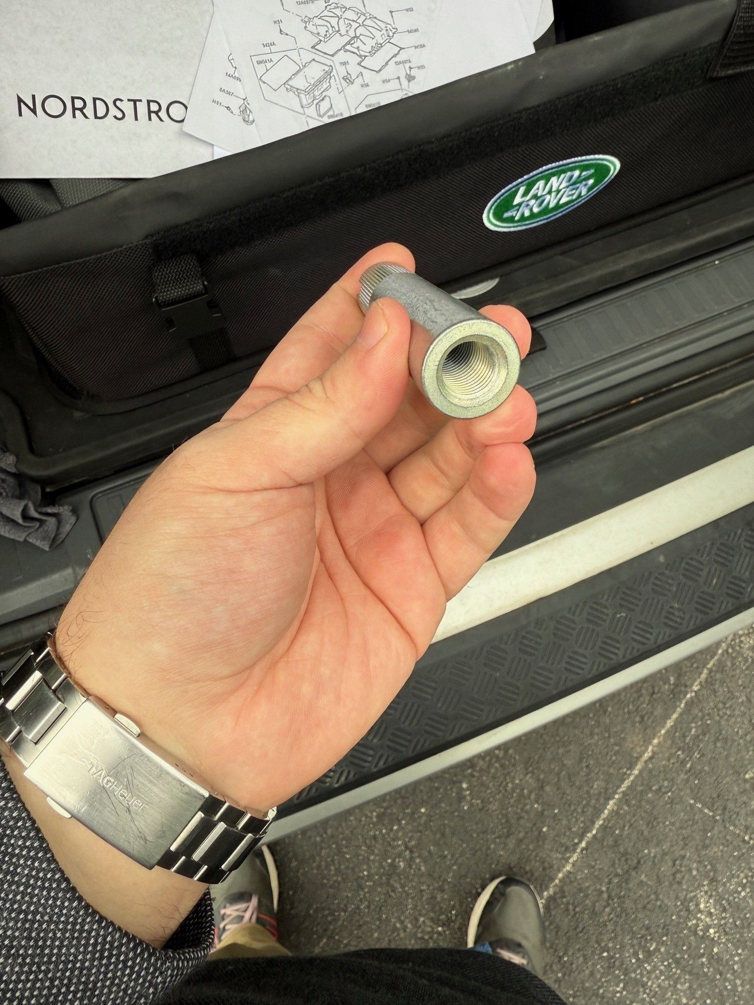

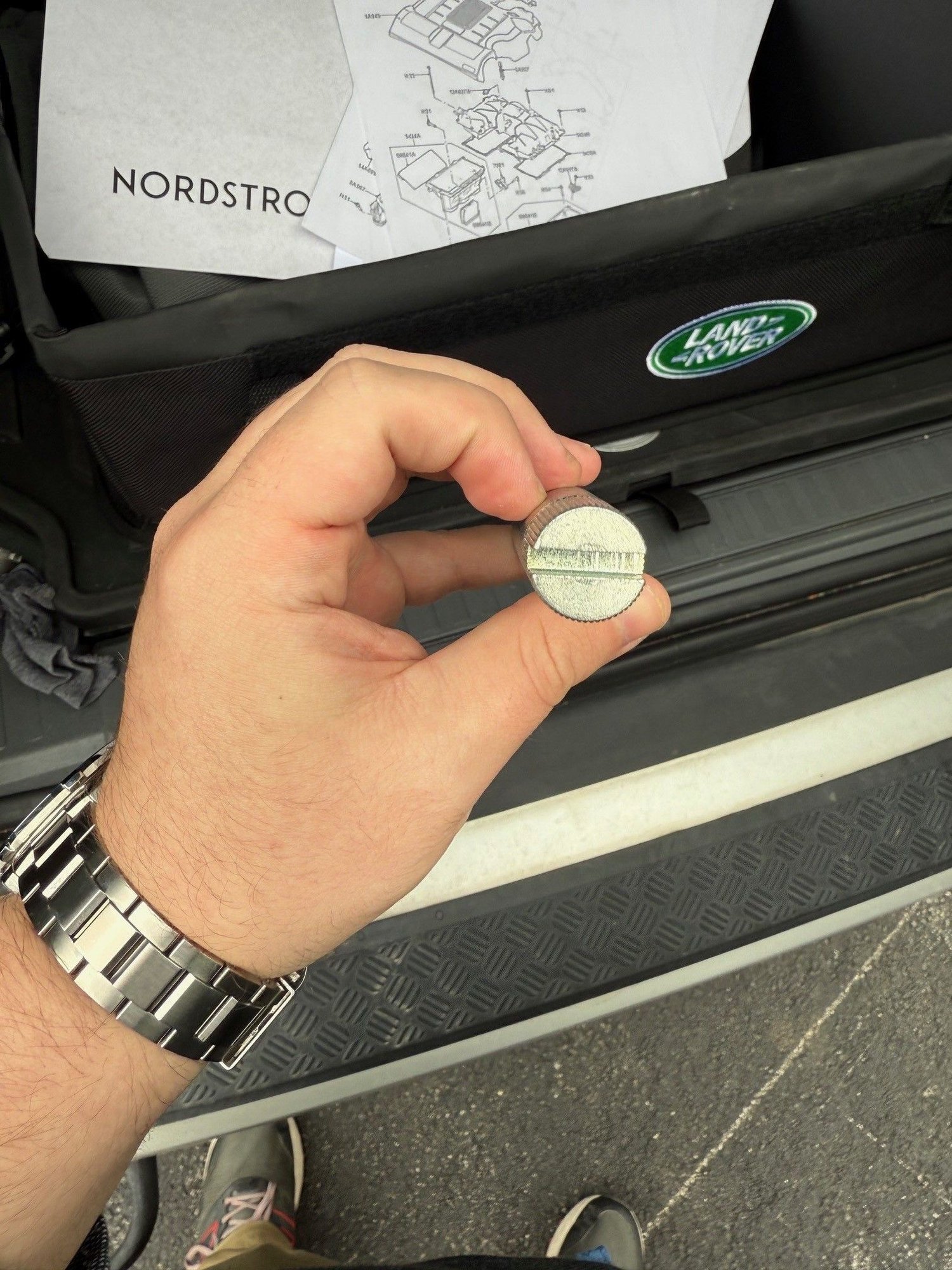

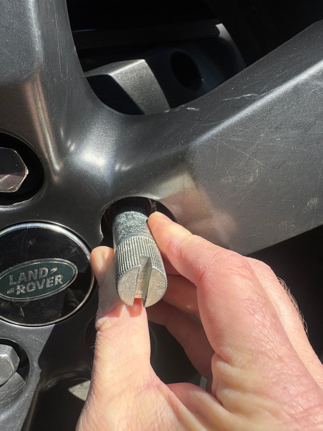

Screwed it on and wouldn’t you know it - the thing doesn’t fit through the hole in my wheel (2020, grey 5098 20” wheel). This tool actually would be helpful. I dropped the spare on my foot once changing it a year ago in the rain. It’s heavy.
Test on a lug hole = will not go through at all on the inner threaded area. The diameter is too large for the hole in the wheel. I’m sure I could file it down or something of the sort -- but -- life’s too short to adapt a silly tool like this and I have no bench grinder.
LR = fail.

You can see if I flip it around it goes in way further.. proving the theory
To the trash bin this goes

FYI: 2 part numbers in the system for this. Anyone with a 2023/2024/2025 want to take a picture of theirs? Or @PaulLR could you snap a pic of the new one you got if it’s not too much trouble?
LR ALIGNMENT TOOL
LR147223 2020-2023 ($38 USD)
LR186857 2023 on
EDIT: Forget it, I just ordered one from Simon in UK - aftermarket and will fit - https://www.powerfuluk.com/products/...624448e4&_ss=r
Video here - it’s not tapered, it’s just cylindrical -

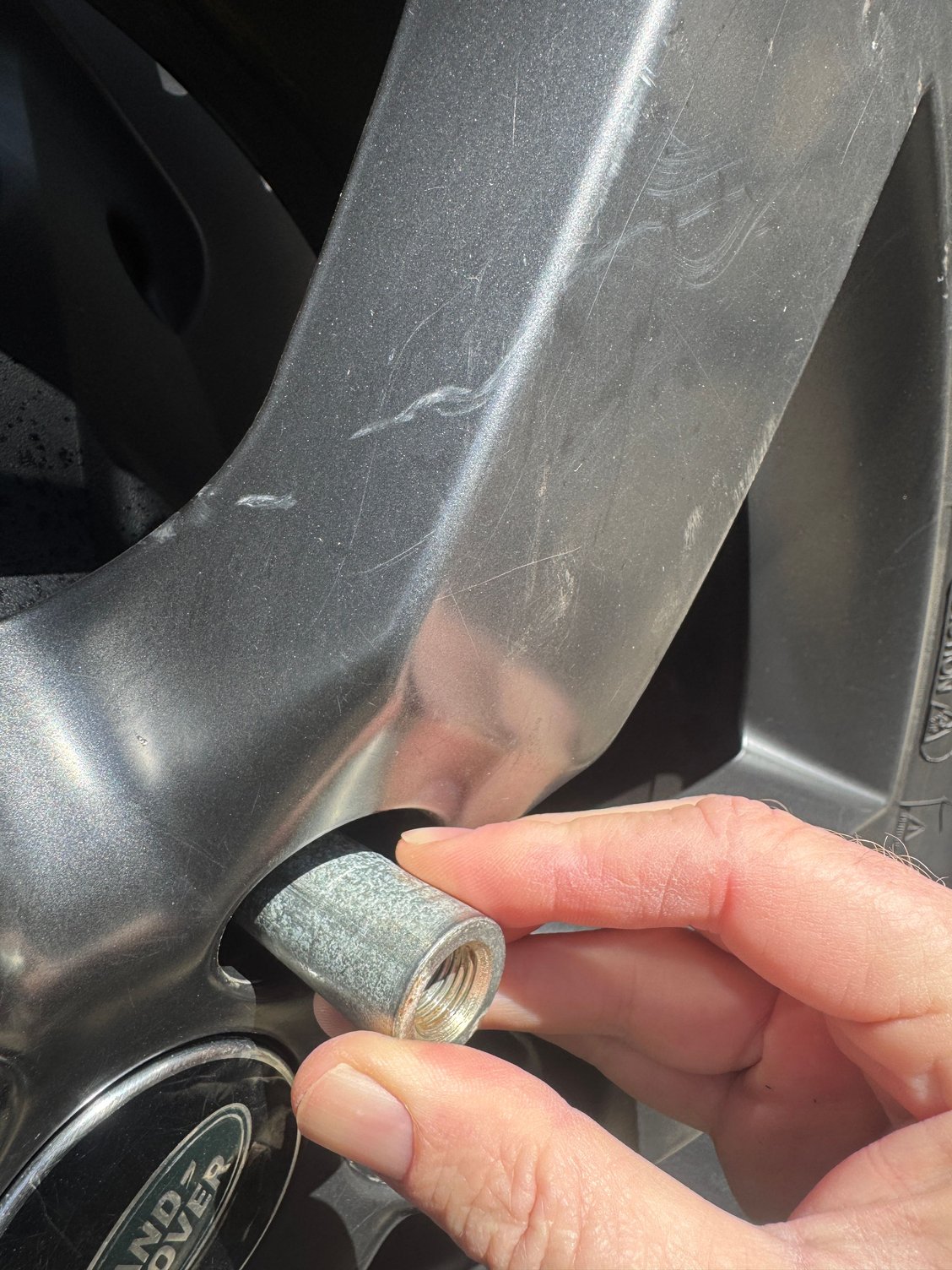

Furthermore there are 2 part numbers in the system for this. Anyone know which I should order. And what the difference is. Anyone with a 2023/2024/2025 want to take a picture of theirs? Or @PaulLR could you snap a pic of the new one you got if it’s not too much trouble?
LR ALIGNMENT TOOL
LR147223 2020-2023
LR186857 2023 on

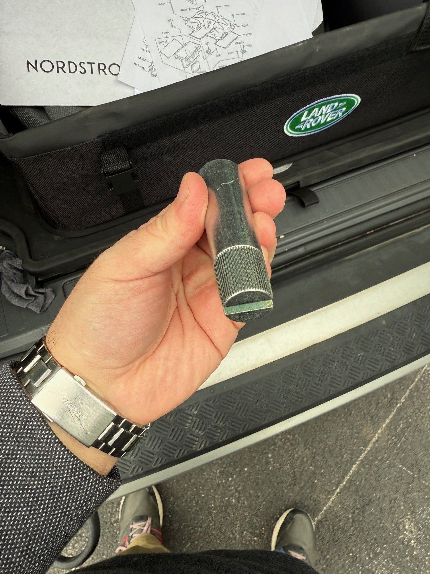

If it's worth anything, this is what I have on my 2021. No part numbers or markings or anything:
Thanks Cincy. Might you stick it through one of the unused holes in your spare to see if it fits?
Is it a cylinder shape, or is it tapered? Mine is very obviously wider at the threaded end - and does not go thru the wheel hole. FYI.

The 2 I have now that easily pass through do not have that lip at the very bottom edge. The one I returned to the dealer had a small lip that blocked it from passing through a lug bolt hole.
I also figured out it works better if you thread it onto one of the two lower studs. If you mount it on the top single stud it is hard to unscrew, probably due to the weight of the tire on it.
Mine is like yours; it is wider at the threaded end. I have the cover on mine, but give me a little bit and I'll try It out for you as long as it doesn't start raining. Also bear in mind I'm running wheels from an LR4, but I don't think that would make a difference.
