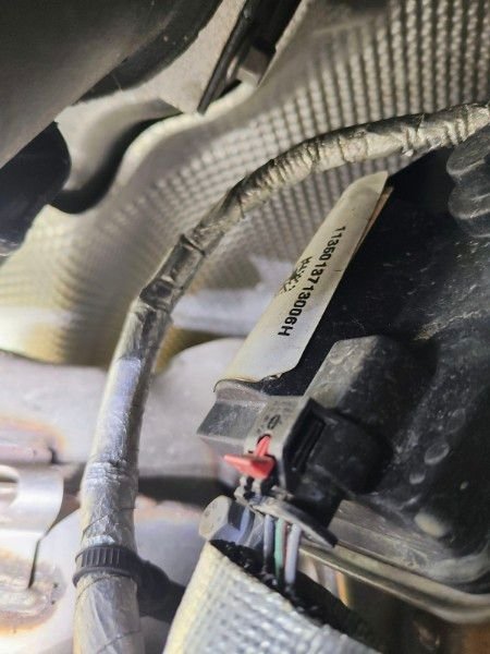

I need help with the connector for the modulator -
I cannot figure out how to disconnect the two parts.
I think I need to pull out the red part (see pic) before I can retract the male side, but it will not budge.
I dont want to break this connector. If anyone has any tips for me, I would appreciate it very much.

Originally Posted by super50
Thank you for the write-up. Very helpful.
Use a pick or small screwdriver. Retract the red tab and then use the pick to release the latching tab as well.

Thank you for your help. I was able to get it done, and it sounds really nice now.
