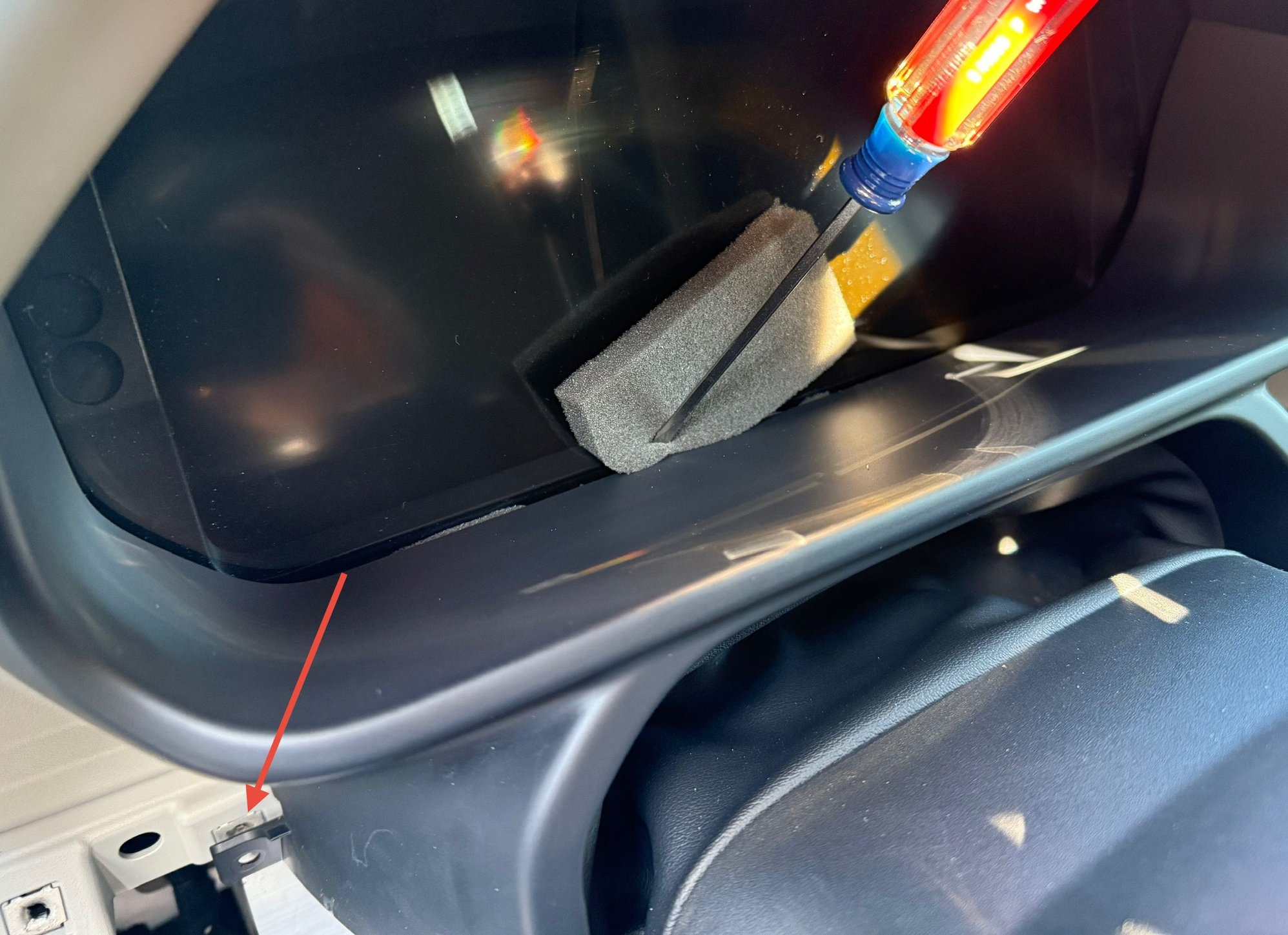

Annoying “squeak” between the instrument display and the plastic surround.
Removed the screw (arrow) holding the surround in place to create a gap and stuffed some soft foam in there.

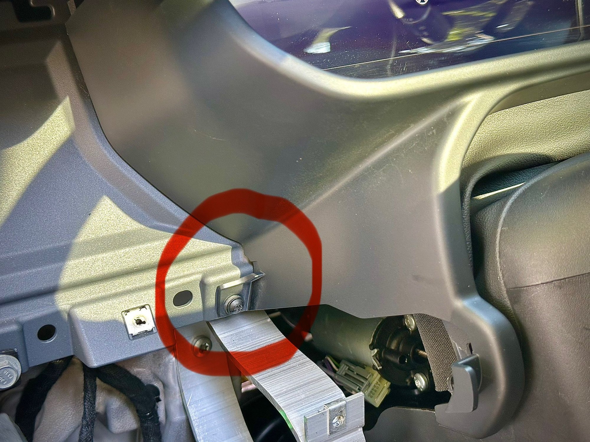

After 2 years and numerous complaints to the dealer that went unsolved, I finally fixed the absolutely irritating "rain stick" noise that others have mentioned. It would drive me insane when it really got going on the highway lasting up to 30 mins!
Unfortunately I swore the issue was around the parking brake switch as I could push on the leather beside it to stop the noise. Sometimes I would drive just pressing the panel to help my sanity. But after taking the plunge and removing piece by piece of the dash it all came down to this one screw!
Foam tape on the inside, a thick rubber washer and a just barely snug screw. Over tighten and it still did it.
Thank goodness this is over with! Just wish I would have identified the actual source sooner as this thread would have then been a great help.
