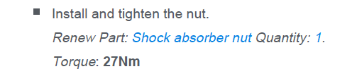

Nothing special. I removed the electrical connector and torqued the nut to 27Nm as per the workshop manual:
If yours doesn't tighten, then I guess the thread could be stripped or there's something else wrong in the shock itself.
