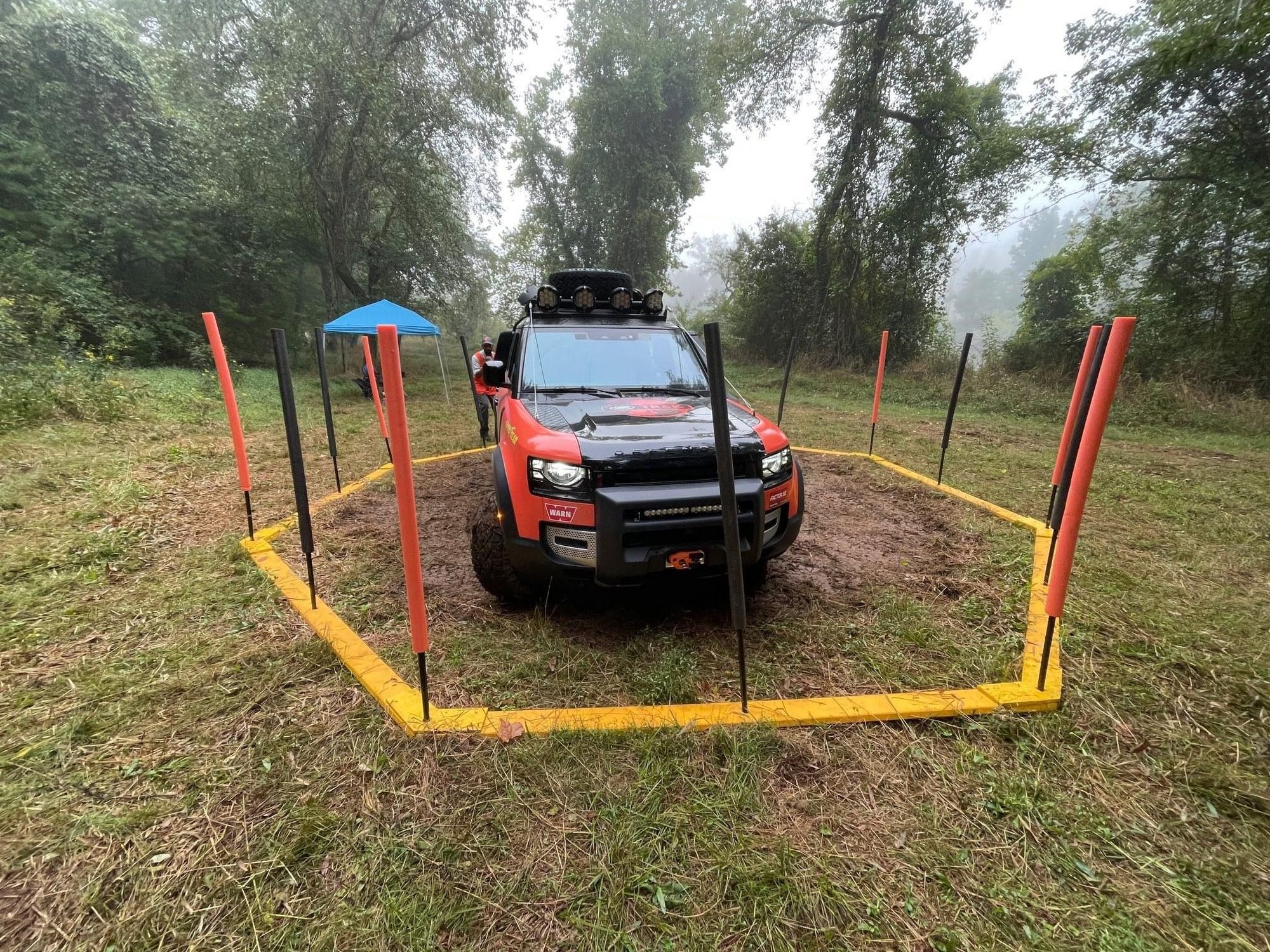

Here is a close up of a picture the day we bought the Defender:
I also have the pictures from our TReK in action and it looks like its in the same postion before it was sold off the showroom
You can see the blade end is tucked under the A-pillar...
