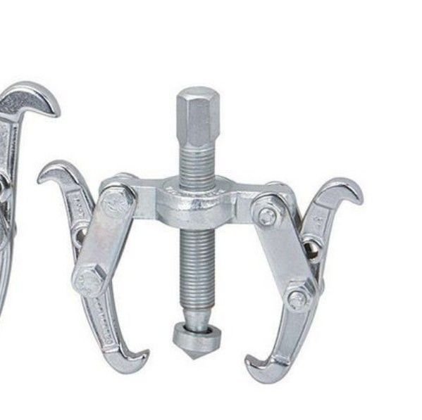

I would 100% have a dealer fix this if you are not mechanical: If you don't know what you are doing, it is a bit of a pain to remove the wiper arms from the spindles (it is easy, but you can have trouble, they are frozen on the spindle, need to use a puller, can break the windshield hammering on the shaft, etc).
I have attempted to remove the arms previously to clean out the washer jets and found they would not budge. I’ve pulled them off other vehicles in the past with no issues but these are extremely stubborn. Is there a specific wiper arm puller you refer to? On the other hand, the washers are not very effective as the seem to spray everywhere but where you need them to hit.

In the folded out position, they take some stern talking to and some aggressive handling and then they will come off. Rock the arms in the different axis and it will come off. A puller would be more approprate like this

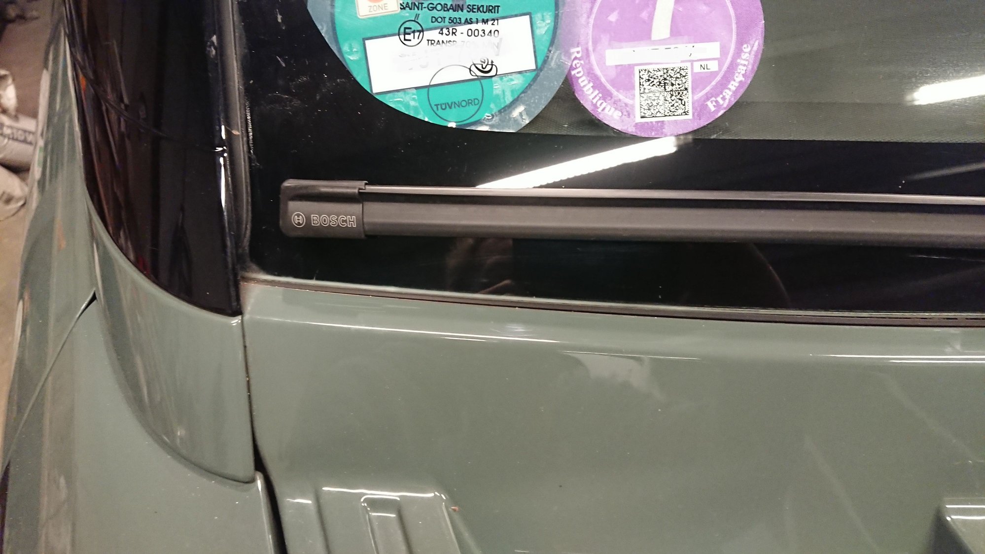

Does anybody have a good picture of the position of their wipers relative to the edge of their hood (wipers parked)?

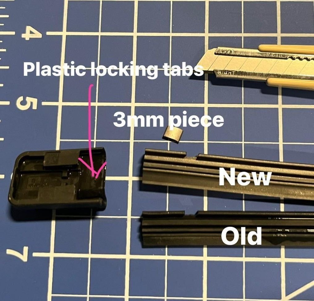

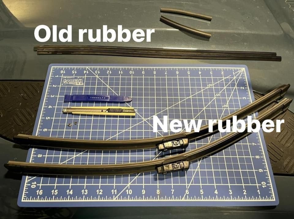

Yes. I just ordered another set after typing my reply.
$6 or thereabouts $6 or thereabouts
. Should be here tomorrow and I'll swap them out like I did before.
 The last set I got The last set I got
were $8 so I'll be getting that yacht any day now with savings like these. I may even swap the rear too. Not that it gets much use with my molle plate there and clearsight mirror.
