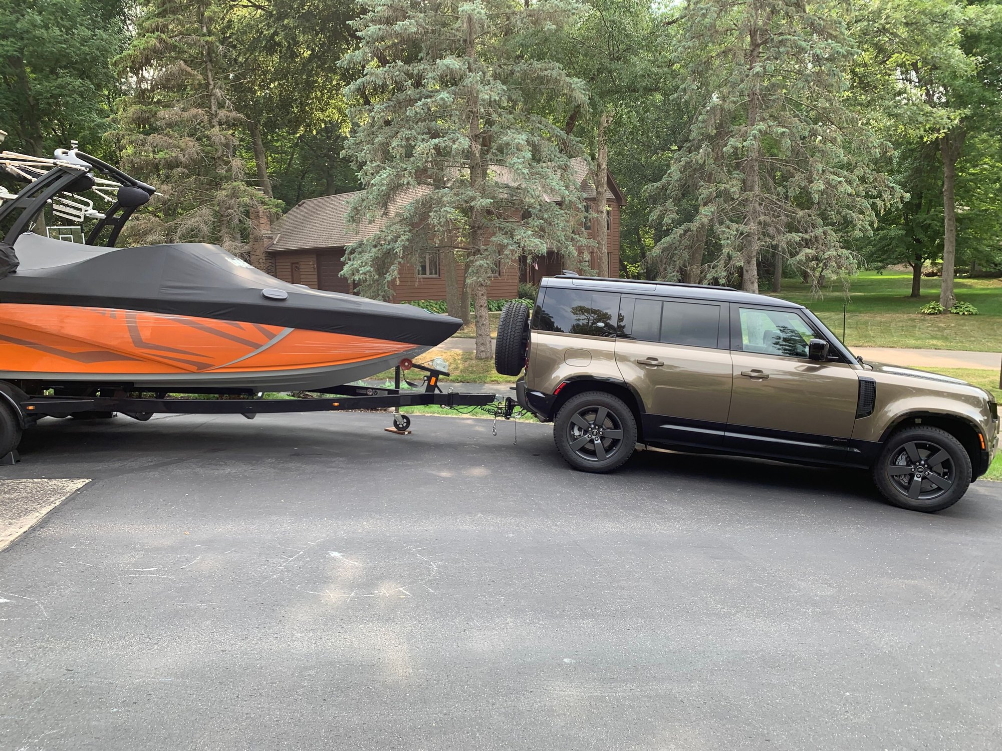

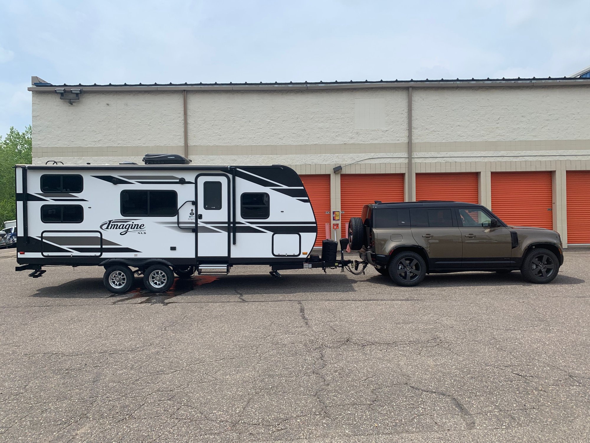

I have a little over 10k miles on my MY’21 XD P400, much of it has been pulling around a 6k+ lbs boat or a 5.5k lbs travel trailer. Been trouble free other than issues with travel trailer lights not always working. Still troubleshooting it, will see this weekend if I fixed it. Always get stable.

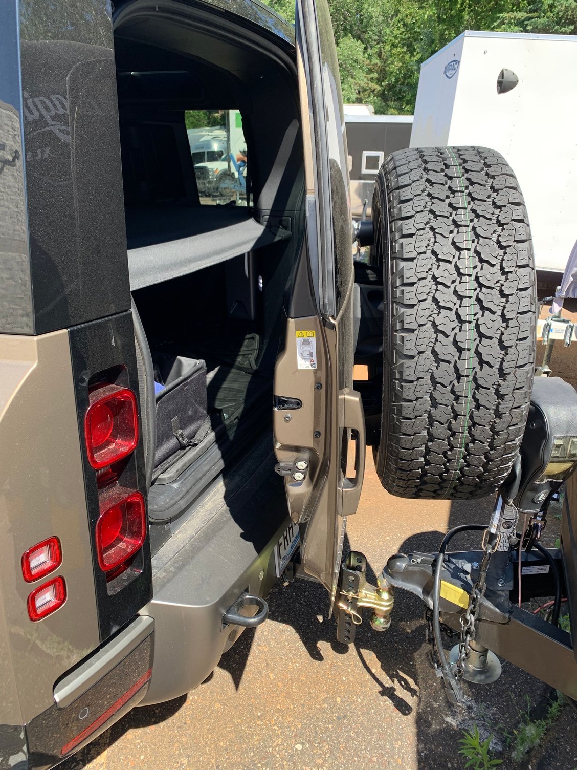

We had a similar issue with the spare hitting the jack on the trailer. We ended up buying a longer draw bar, 11in pin to center of ball, and removing the electric jack and replacing with a side mount one on the trailer. We also don’t use a mechanical sway control, JLR recommends against it - we’ve been using an electric one from Hayes and can confirm it works as advertised.
The safety chain loops on the hitch were too small for the safety chain hooks on our boat so had to buy some carabiners to make the connection.
We pulled the travel trailer on a 5k mile road trip through the mountains trouble free (other than picking up a nail in the right front tire) loaded with a family of 4 and a 60 lbs dog. No issues other than horrendous gas mileage. I probably averaged 7-8mpg on the trip.
