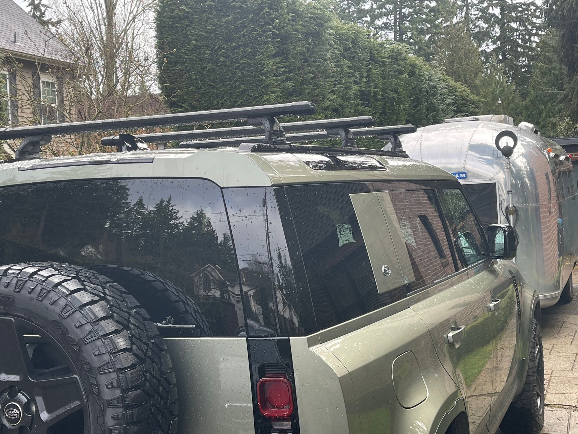

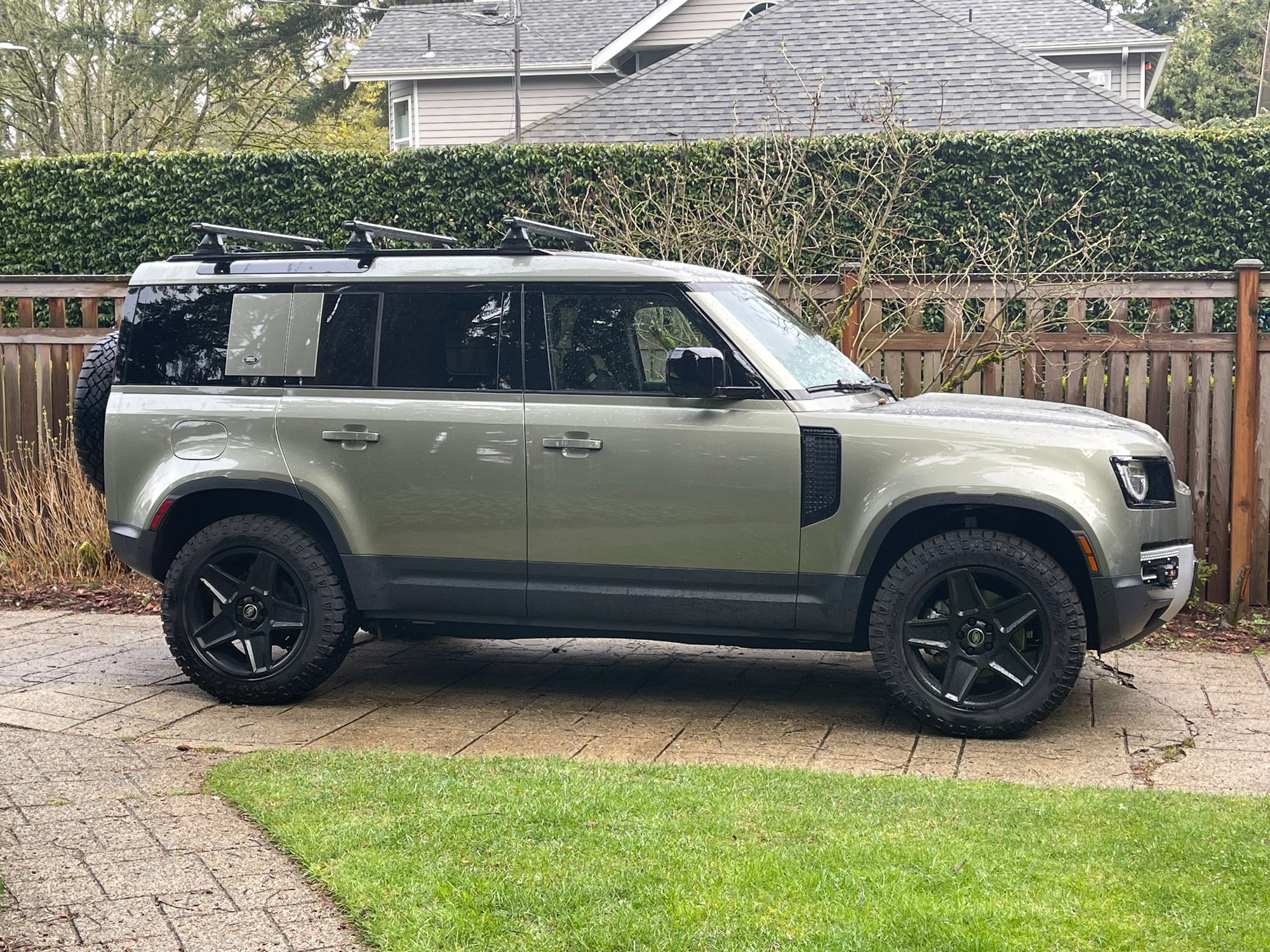

You mean like this?
I had to fabricate my own plynths and clamps to make it work. The front and rear plynths are tapered to get all three bars on the same plane. The clamps under each tower are one-peice with two threaded screw holes to match the footprint of the tower base. You will definitely want an air dam with this setup because it can really howl. Here’s mine.
Hope this helps.
