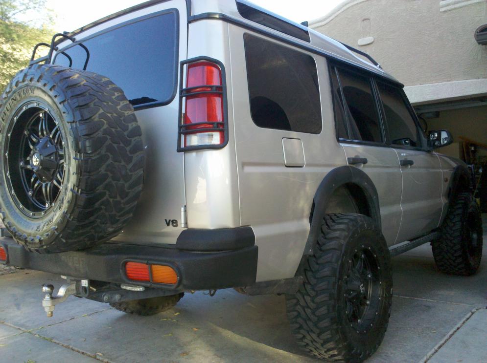

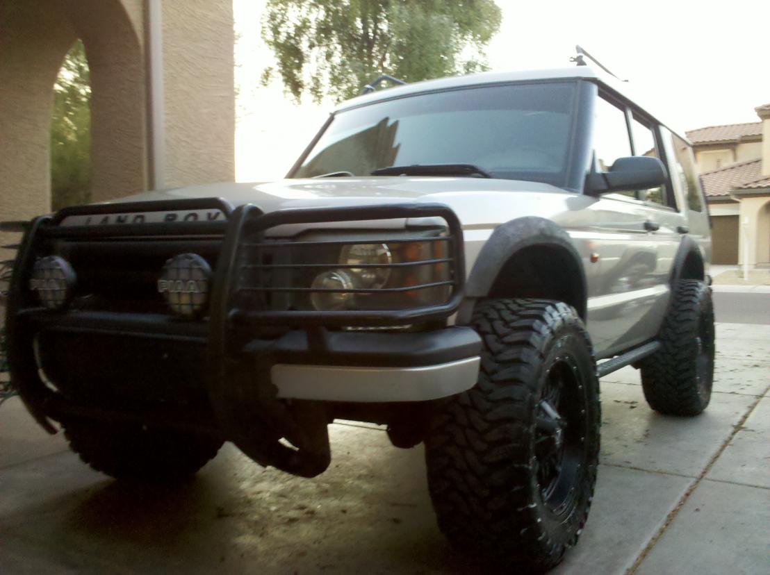

I'm running 33's x 1250's, I have 2'' spacer lift in front, and I modified the rods in rear to gain 1'' of lift in rear (my personal choice for my stance).... Also the main mod to get the wheels to fit offhand was cutting the fenders 4 inches or so and cleaning up some of the sharp edges in front wheelwells.... I get very little if any rub when fully articulated and wheels fully turned... In the future i'd like to go up to 35's but for now disco mike is right, it can get expensive real quick unless you get your rig ready a little at a time as I'm trying to do....
My verdict as far as fitment of 35's, DO IT... But for what I would do, is get rid of my spacers and go for a firm 3'' lift and put my spacer lift and modified rods on the rear to gain a firm 3'' in rear as well... My truck has Advanced Cornering Enhancement (ACE), so I won't lift it more than 3 inches without risking driveability issues.... But I don't plan on 35's till I get new gears & Lockers.... For now its a beast with just the 33's, MPG is disgustingly low already at 10-12 mpg @ absolute best... with my non calibrated speedo & odo, I get just over 200 miles a tank,
Bottom Line: "Don't do it unless you can afford the gas...!!!"
