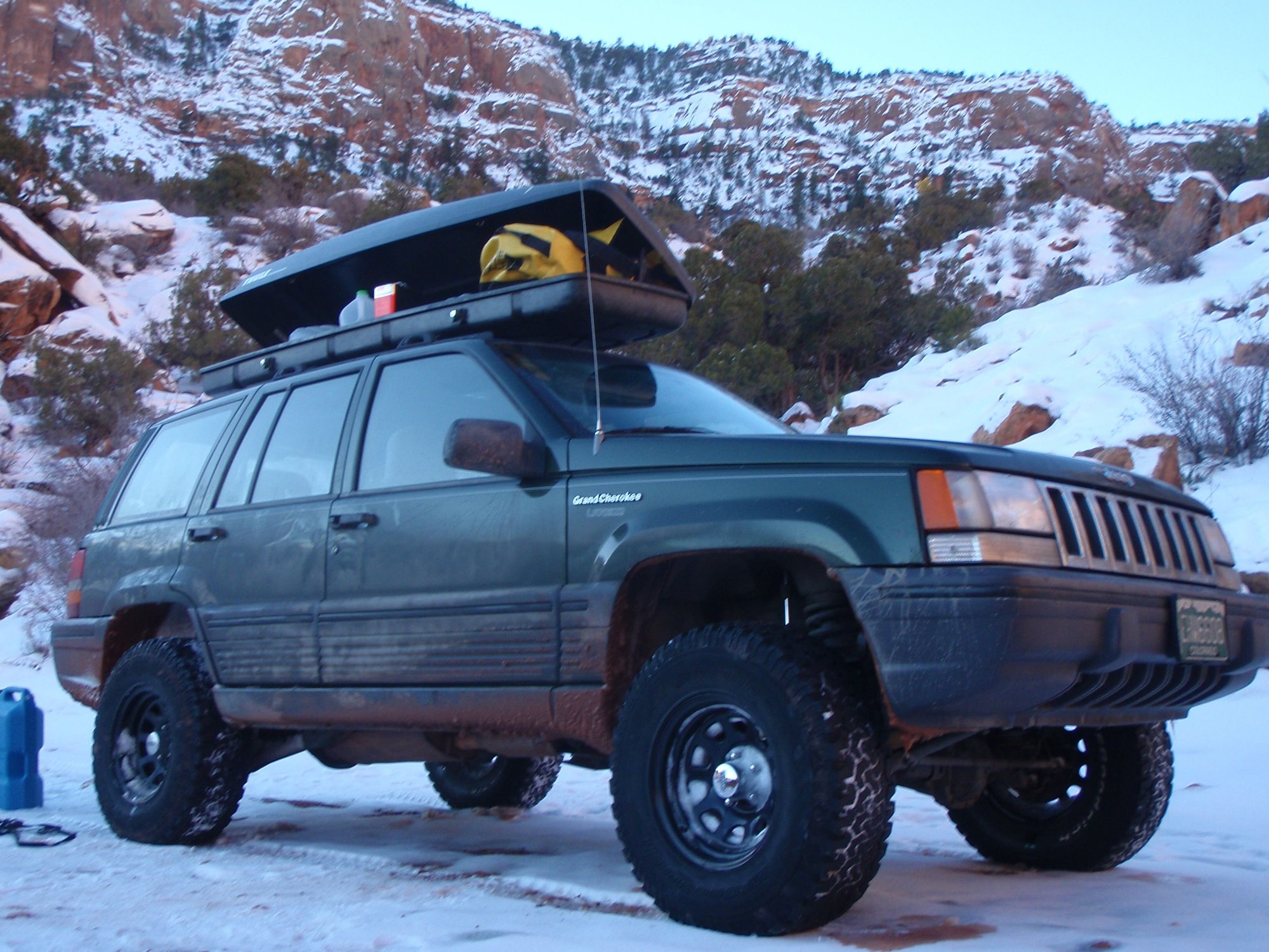

My first car was a '95 ZJ. It was the old family car and after my dad sold it to me I lifted it and put on some 31" BFGs. I had a blast owning this and learned a ton about vehicles, but sold it during grad school and have been driving Subarus ever since.
