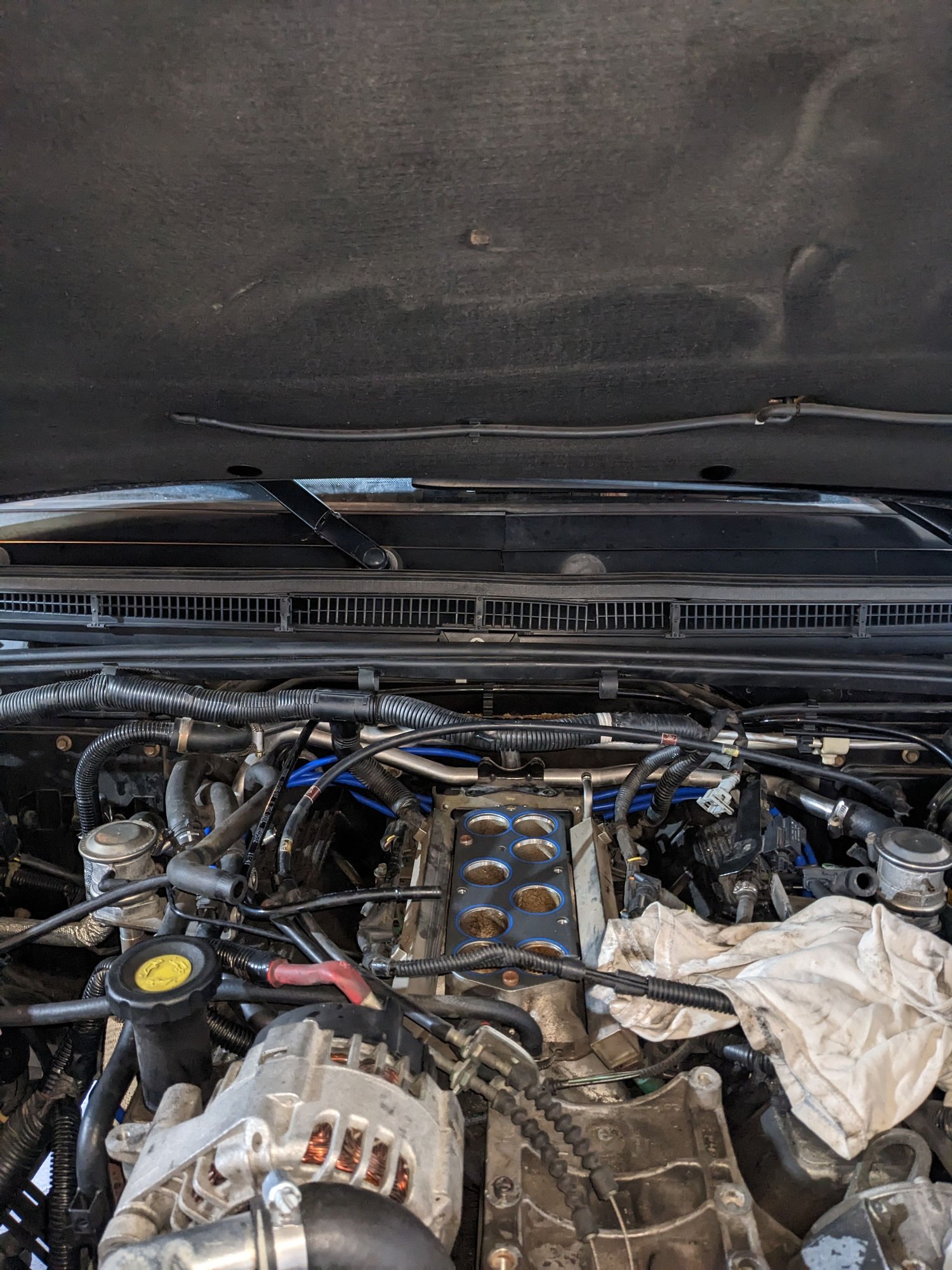

Still waiting for the new bumper so I thought I'd do coils and wires. Nothing that hasn't been discussed in depth here, but the coil packs locations are a bit tricky. Also, those little threaded rods with nuts to hold the SAI onto the manifold came out easily, but why Land Rover didn't use bolts was beyond me... The upper and lower intake manifolds were pretty clean! This truck keeps surprising me with how well it seems to have been cared for over the years. I also cracked that stupid windshield cowl even more by touching it too hard (it's like a giant egg shell at this point).
Got everything back together and it was idling rough with P0308. Thankfully the #8 wire is on the top row of the coil packs, it had come loose when I was buttoning the thing back up. I attached it without pulling the plenum back off and it was surprisingly tough! A bunch of you guys must either have small hands or just be more dexterous than me if you're doing all eight wires like that.
Here's a picture of the pretty blue wires because they were expensive and nobody else appreciates them. (And you can barely see them even if you know they're there).
